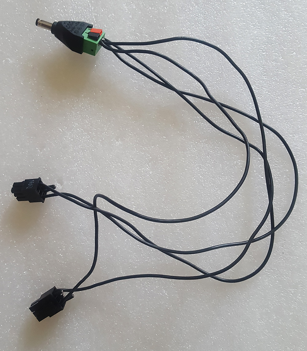

For the life of me I can't get my early 2013  MacBook Pro running a fresh install of 10.11.5 to recognise my eGPU. My hardware set-up consists of the following:
1. E
arly 2013 MacBook Pro with the GT650M
2. Fresh install of OS X 10.11.5
3. Corsair CX750M PSU
4. ASUS GTX 980 and EVGA GTX 960
5. Akitio PCIe TB chassis.
6. Custom made 2 x 6pin cable to barrel plug
7. Paperclip to power up PSU
The Akitio powers up as do the fans on the GPU. When I run the install script I just get stopped at the "Thunderbolt device is connected, but no external GPUs detected". I've tried this with the  eGPU connected to an external monitor via HDMI and with no monitor connected. I'm just lost as to why my set-up doesn't work. Both GPUs are brand new so should be good to go.

To power up the Atikio I have two 6 pin cables plugged into the peripheral ports on the PSU wired into the barrel connector with 2 x 12V on the centre pin and 2 x ground on the outer. I've also swapped the cables and ports around :(cable.jpg
Matt
Edited by 360precision
Added photo of cable.

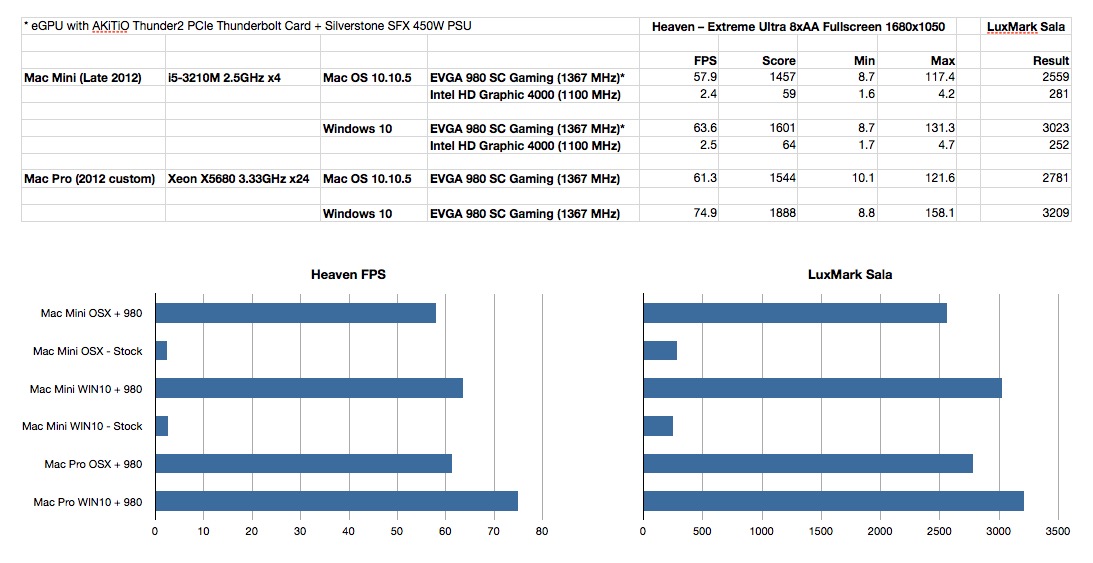

Ok I have worked out my problem and now the eGPU is up and running!!!
The problem was with the power connector cable I made running from the PSU to the Akitio, the wire I used was too thin which caused it to cut out on load (I new nothing about wire gauge and how it related to the power flowing through it, but I do now). So I bought some thicker wire and remade the cable and it worked straight away. It held strong through some benchmarks in both Mac and PC Bootcamp, and I haven't had a crash yet. Also starts up every time, don't have to do any weird timing things with my card, just plug it in and switch on the computer.
Thanks again @goalque for your help. I've attached the results of some tests I've been doing and it seems to perform similar to when the card is in my Mac Pro desktop, maybe 10-15% performance difference depending on the task. Also I measured the power load taken by the PSU using a wall outlet meter and it measured 211W max during the Heaven benchmark, all other tests were below that amount.
