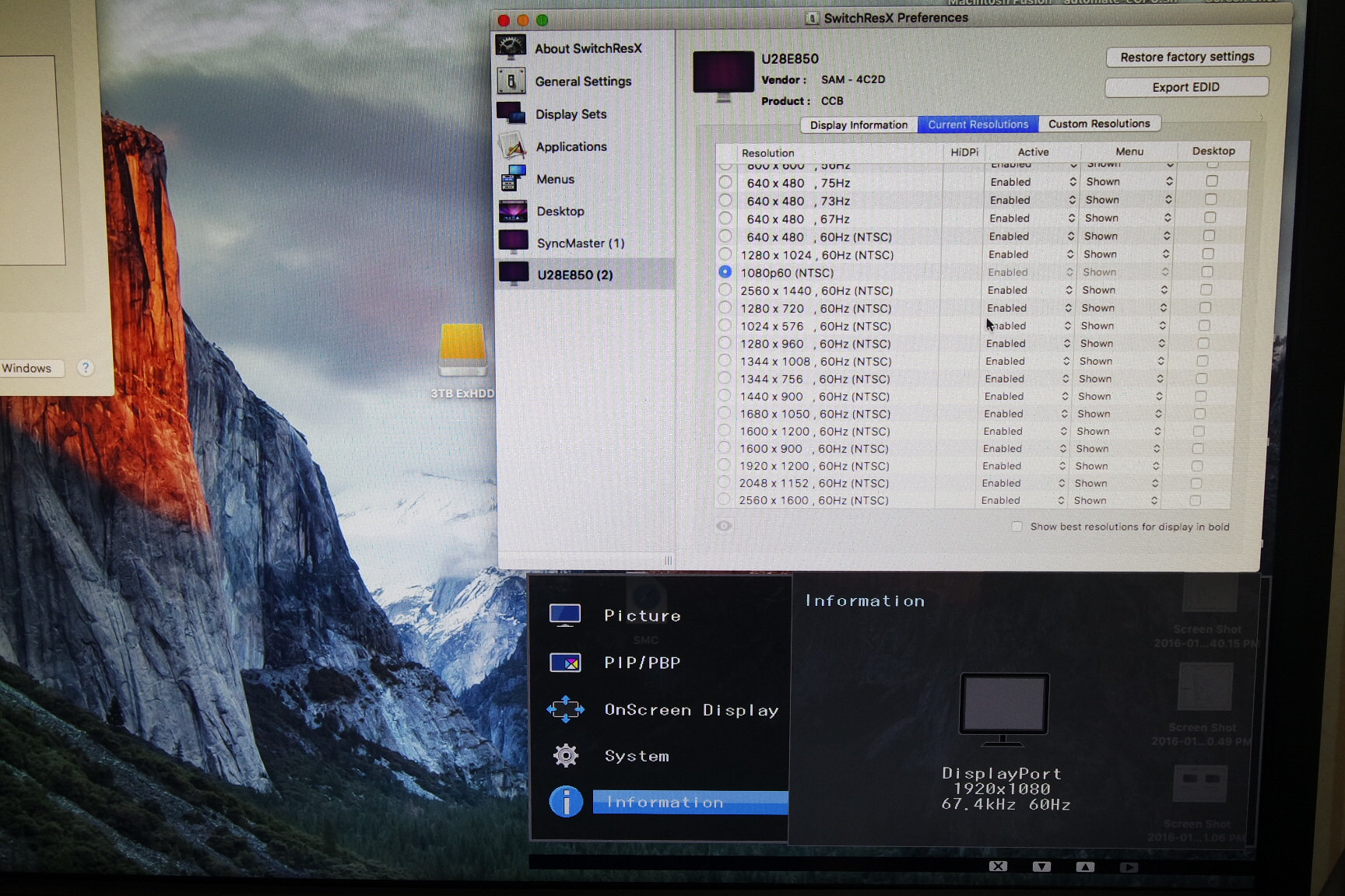

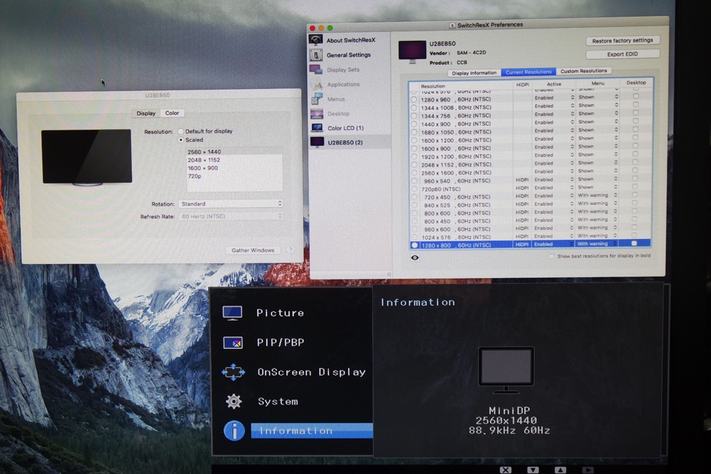

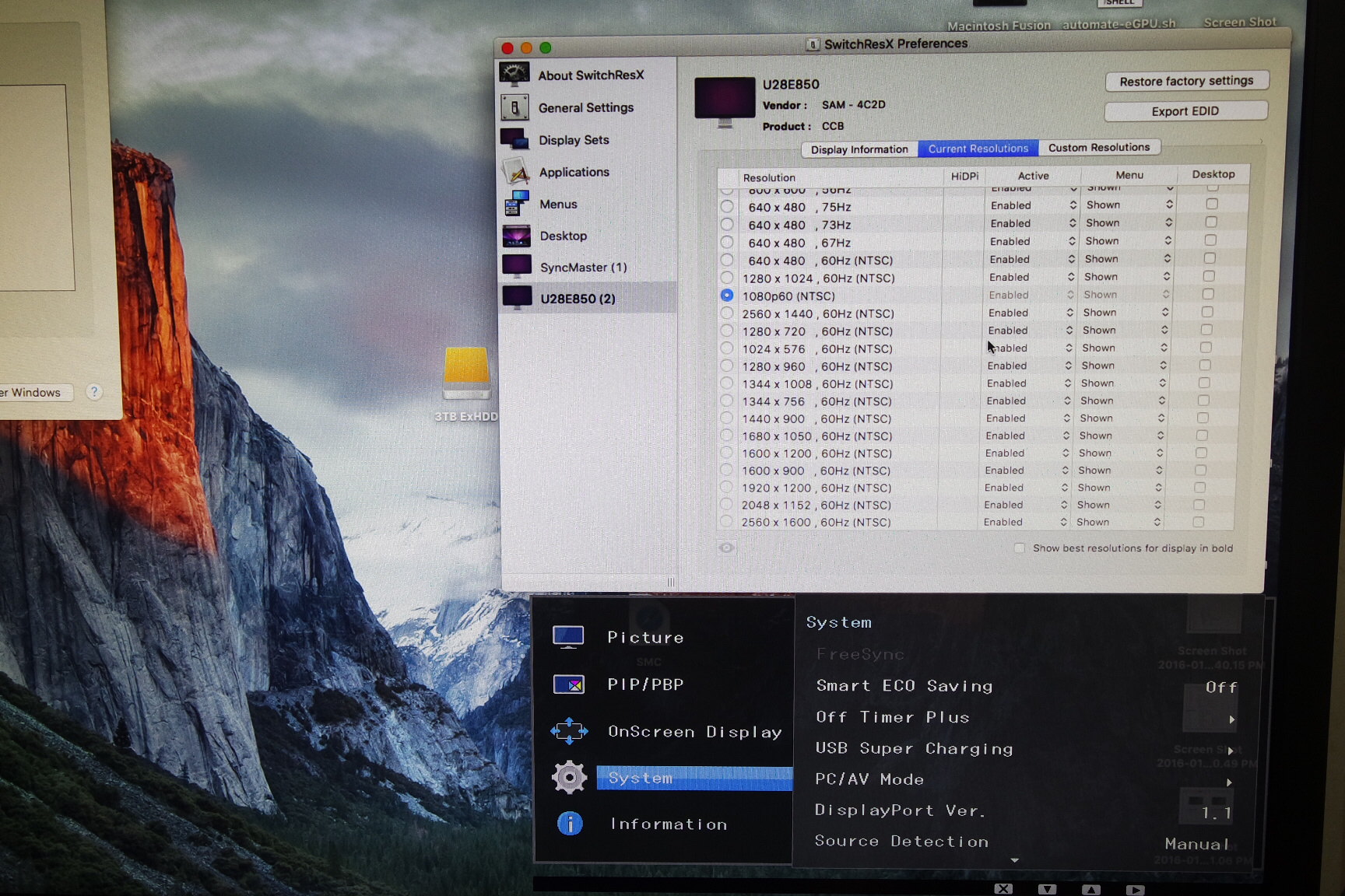

I tried to change DP version to 1.1 on OSD menu. (free sync is already off)
My mac could boot successfully on your solution.
But i can not use 3840x2160@60hz.
My monitor works only 2560x1440 60hz.
Did you have other solution?

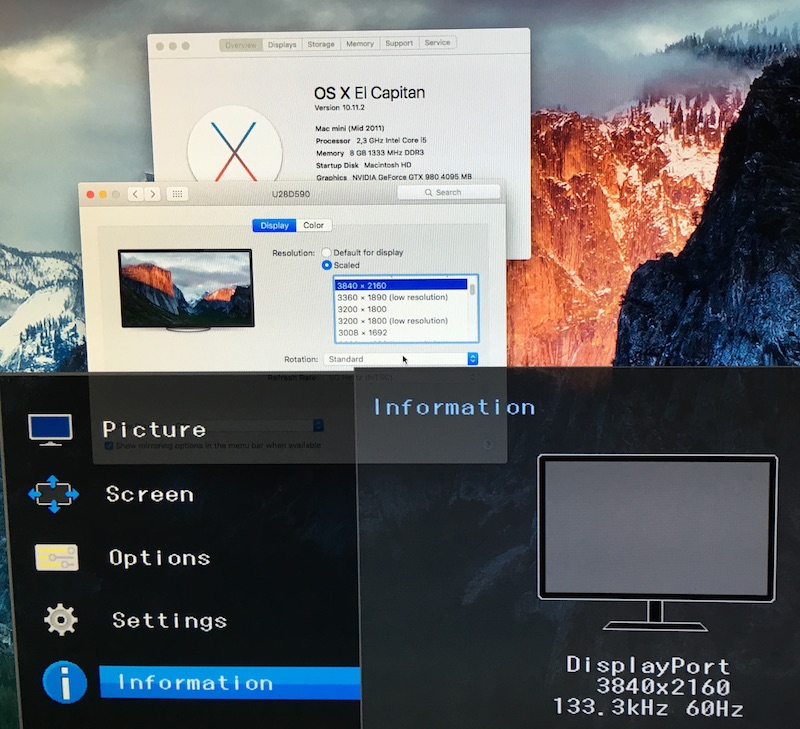

Hi. @goalque
I tried to connect the samsung UHD monitor directly to the eGPU with a DP to DP cable.
But i got same result.
On the DP 1.1 mode, mac could boot. and it displays only  2560x1440 60Hz(maximum).
On the DP 1.2 mode, mac could not boot.
Interestingly, mac could boot when UHD Monitor was turned off.
I think samsung UHD monitor is not compatible with mac.
Lastly, Could you tell me OSD settings on your UHD Monitor?
(screenshot?)
Thank you.

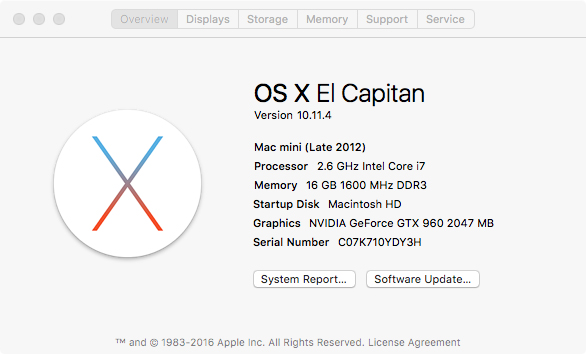

I've been using this post to make my egpu and have managed to get my mac mini to detect it.
I benchmarked it on Tomb Raider and got a respectable 180 fps or so, however when I play League of Legends no matter how I set my display setting I can't get it to go over 20 fps. I tried reinstalling the game but that made no difference.
I also tried SC2 and it was stuck at 0 fps on fullscreen, I changed it to windowed mode and it got a little better but still froze every couple of seconds.
I tried a load of other games like, Tomb Raider, GTA SA, CS:GO and Minecraft and they all played better then my igpu.
However other games like, Total War: Shogun2, Middle-earth: SOM and Diablo 3 all had graphic glitches and/or would freeze every couple of seconds.
I really only play LOL and SC2 so its kind of annoying to have to switch over my HDMI whenever I feel like playing.
Does anyone have any idea why some games are working better then my igpu and others are worse?
Thanks in advance.
Kane
@charliehsmith
Yes, do as the script says.
@Andrea.Kang
Due to AMD FreeSync you cannot use DP 1.2 and apparently DP 1.1 is not capable of showing UHD resolution.
I’m still on OS X 10.11.2, and works great via DP 1.2 as well.
@Kane
In OS X, it varies a lot how compatible the app/game is with an eGPU OpenGL/Metal API.
@Kane
There is no universal solution. It is a game programmer’s responsibility to choose the acceleration API, an active GPU for OpenGL/Metal view, and adapt to renderer changes. OS X is not a good gaming platform. Nvidia has to keep up with the Apple’s changes and it results in bugs. The future is Metal, but the API needs refinement,

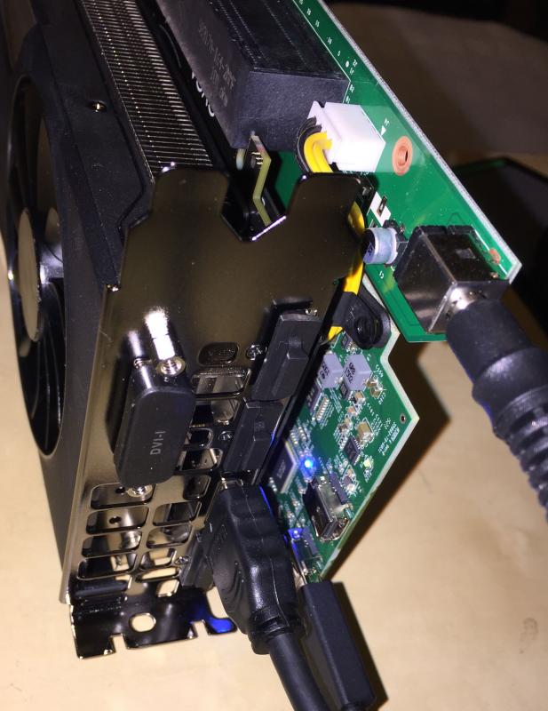

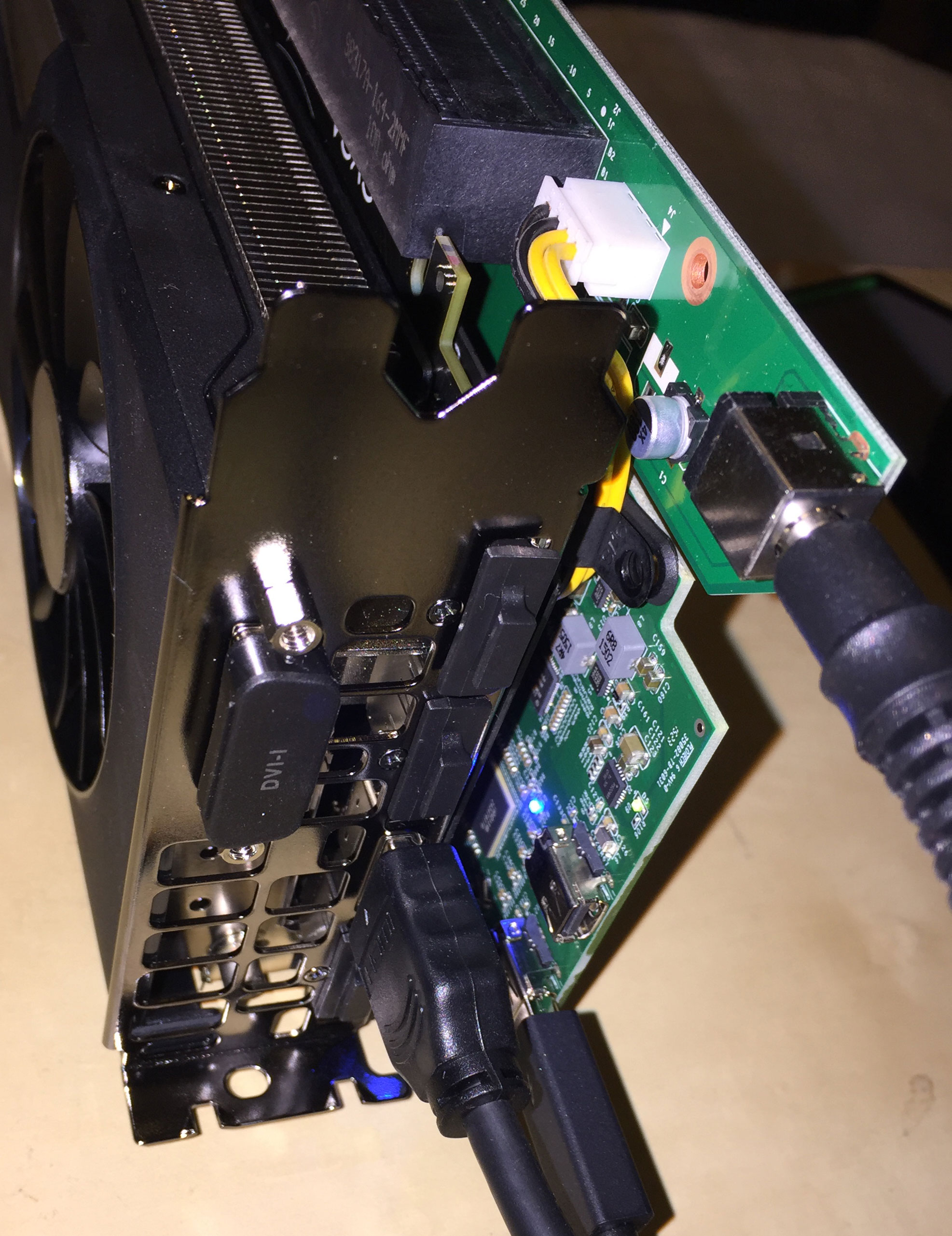

@Rttr84 In OSX that is no problem. Please keep in mind that you should use an external monitor if you want to game with the eGPU and that the internal display might be laggy and not of use when using with an eGPU+external Monitor.

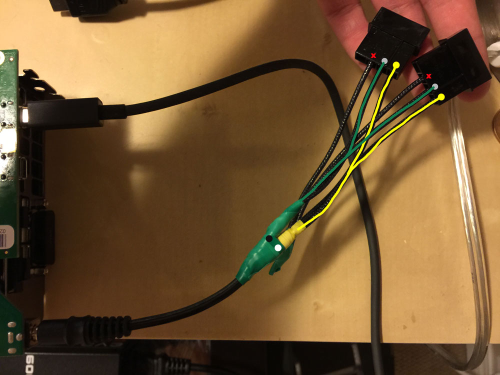

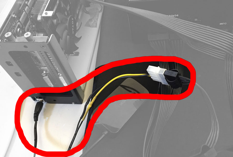

Are you still useing the AKiTiO PSU? If yes, DO NOT USE IT!
The riser you have is a x1 or x4? Why not get a x16? Riser are in general the weakest part in a eGPU system. Can you test without the riser and make a barrel mod to power the AKiTiO with the 600W PSU?
Thanks for your help Dschijn

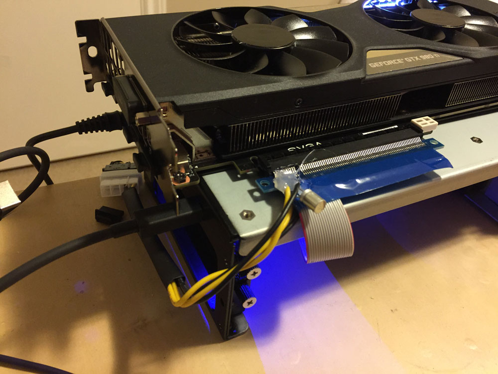

I have a PCI-Express 1x to 16x Powered Riser Extension Card with flex ribbon cable
I tested the card without the riser. nothing have happened, just the fans of the GPU were trying to rotate!

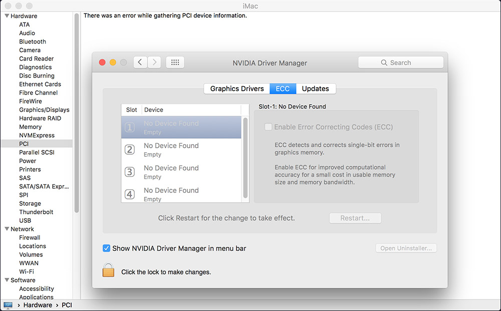

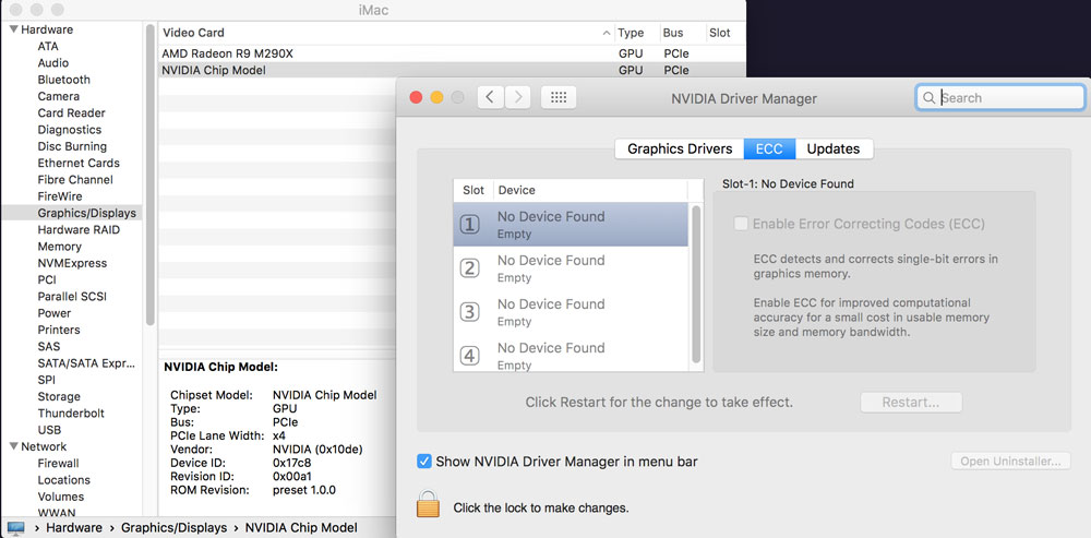

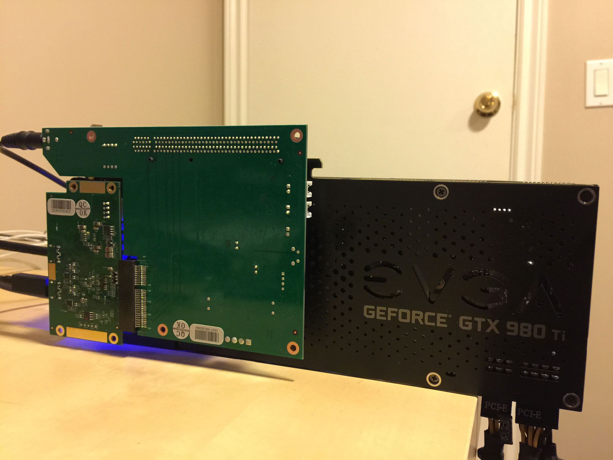

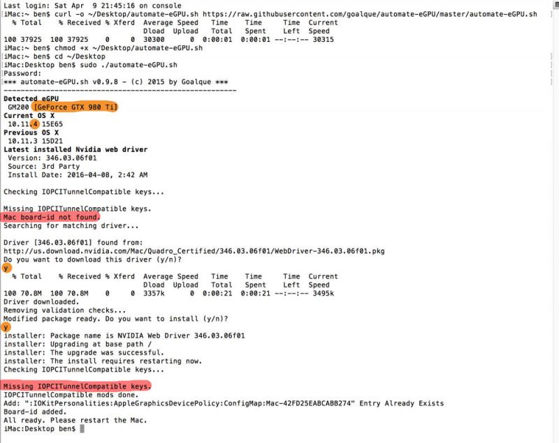

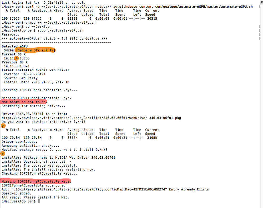

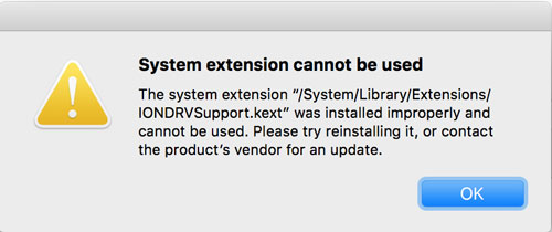

Hi Dschijn! Thanks for your help. I read the basic guide after that I made the Power Plug. It seems everything is great, but my computer doesn't recognize my GPU properly ! I ran automate-eGPU.sh install Nvidia Web Driver, and CUDA. Also the resolution of my screen became so small like a square.
Geforce GTX 980 Ti
iMac 27 5k a 4k monitor
My OS is mac 10.11.4
Edited by shirazigs
Thanks again. I've rebooted it at least 15 times. At the beginning the Script didn't work for me and couldn't find any help, afterwords I followed this:
1. Reboot the Mac and hold down Command + R keys simultaneously after you hear the startup chime, this will boot OS X into Recovery Mode
2. When the “OS X Utilities” screen appears, pull down the ‘Utilities’ menu at the top of the screen instead, and choose “Terminal”
3. Type the following command into the terminal then hit return: csrutil disable; reboot
(curtesy of: http://osxdaily.com/2015/10/05/disabl...)

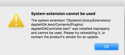

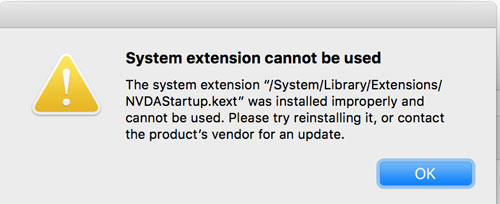

File Edit Locations:
/System/Library/Extensions/AppleHDA.kext­/Contents/PlugIns/AppleHDAController.kex­t
/System/Library/Extensions/IONDRVSupport­.kext
/System/Library/Extensions/NVDAStartup.k­ext
Edit Code:
key IOPCITunnelCompatible /key
true/
Terminal code once finished:
sudo kextcache -system-caches
At the end I ran your script again, and it gave me this messages!
Edited by shirazigs
@shirazigs
Don’t edit kexts manually. If you do so, the script backups them and cannot recover original kexts.
1) Reinstall OS X
2) If the SIP is re-enabled, boot into recovery mode and type csrutil disable
3) Run the script
and take into account the following,
https://github.com/goalque/automate-eGPU/issues/17
1 hour ago, goalque said:
@shirazigs
1) Reinstall OS X
3) Run the script
Thanks It did work! My monitor works, my cart is work. I need to download Cuda and fix the resolution  of iMac.
Thanks :D
8 hours ago, goalque said:
@shirazigs
1) Reinstall OS X
3) Run the script

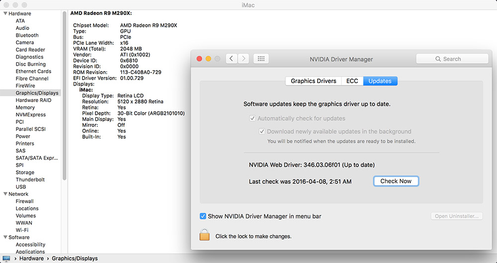

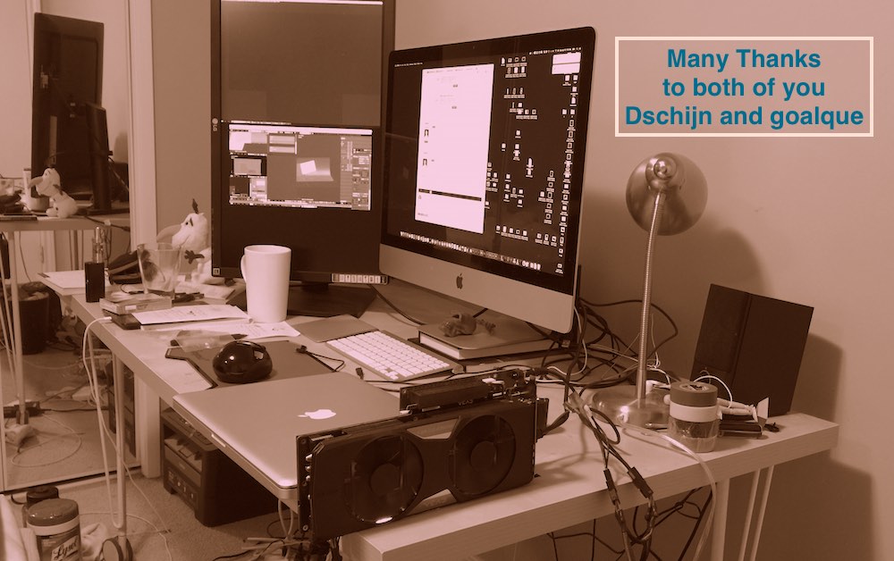

Thanks! It did work! My monitors work, my GPU works very good !!!!
I downloaded the last version of Cuda through this link:
http://www.nvidia.com/object/mac-driver-archive.html
CUDA 7.5.26 driver for MAC
And the resolution  of iMac and second monitor was fixed by itself. I'm not sure I think they change after a short sleep.
Thank you so much guys. I'm so happy know :D
Also I need to clean my room!!!
Edited by shirazigs
