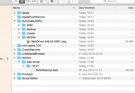

euqlaog Posted February 7, 2016 Author Share Posted February 7, 2016 (edited) @panini Delete Automate-eGPU folder and then reinstall from recovery, https://support.apple.com/en-us/HT204904 Edited February 7, 2016 by goalque Quote Link to comment Share on other sites More sharing options...
panini Posted February 7, 2016 Share Posted February 7, 2016 15 hours ago, goalque said: @panini You have messed up your system if you are running build 14F1605 on Mac mini and there is no driver 346.02.03f05 for NVDAStartup. Reinstall OS X. Never install/update Nvidia web drivers manually. Let the script download the correct driver. On OS X Yosemite, the NVDAStartup stays loaded just a moment after restart so run kextstat command immediately. It’s normal that it vanishes away from the kextstat list and shows Loaded: No. @goalque Ok - here's what I did: download fresh yosemite installer create yosemite usb installer boot mac mini from usb installer disk utility erase my hd do clean install of yosemite mac mini now also has build 14F27 do install of automate-eGPU.sh script run automate-eGPU.sh script reboot no GTX 960 screens light up checking cmd's macmini2:Desktop erwin$ kextstat -l |grep NVDA 107 0 0xffffff7f80eed000 0x3000 0x3000 com.nvidia.NVDAStartup (10.0.5) <12 4 3> 125 2 0xffffff7f80f4f000 0x2d8000 0x2d8000 com.nvidia.web.NVDAResmanWeb (10.0.5) <102 96 94 12 7 5 4 3 1> 126 0 0xffffff7f81236000 0x1ff000 0x1ff000 com.nvidia.web.NVDAGM100HalWeb (10.0.5) <125 12 4 3> macmini2:Desktop erwin$ uptime 17:32 up 1 min, 4 users, load averages: 1.46 0.53 0.20 macmini2:Desktop erwin$ syslog -B -F '$Time $(Sender): $Message' | grep NVDA Feb 7 17:19:52 kernel: NVDAStartup: Web Feb 7 17:19:52 kernel: NVDAGM100HAL loaded and registered Feb 7 17:19:55 kernel: NVDA::rmStart failed Feb 7 17:19:55 kernel: NVDA,Display-B: Not usable Feb 7 17:19:55 kernel: NVDA,Display-C: Not usable Feb 7 17:19:55 kernel: NVDA,Display-D: Not usable Feb 7 17:19:55 kernel: NVDA,Display-E: Not usable Feb 7 17:19:55 kernel: NVDA,Display-F: Not usable macmini2:Desktop erwin$ Here, at the above point 2, I notice visible differences ran sudo ./automate-eGPU.sh -a background services enabled reboot again no new visible improvement system profiler shows NVIDIA chip model on PCIe bus (see screenshot) At the moment Xcode is still downloading, so I will post the clpeak results later this evening. Awaiting your comment.. ;-) Erwin Quote Link to comment Share on other sites More sharing options...

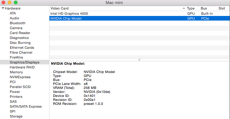

euqlaog Posted February 7, 2016 Author Share Posted February 7, 2016 (edited) 2 hours ago, panini said: macmini2:Desktop erwin$ syslog -B -F '$Time $(Sender): $Message' | grep NVDA Feb 7 17:19:52 kernel: NVDAStartup: Web Feb 7 17:19:52 kernel: NVDAGM100HAL loaded and registeredFeb 7 17:19:55 kernel: NVDA::rmStart failed Feb 7 17:19:55 kernel: NVDA,Display-B: Not usable Feb 7 17:19:55 kernel: NVDA,Display-C: Not usable Feb 7 17:19:55 kernel: NVDA,Display-D: Not usable Feb 7 17:19:55 kernel: NVDA,Display-E: Not usable Feb 7 17:19:55 kernel: NVDA,Display-F: Not usable You may have a faulty eGPU or PSU. @chrise had exactly the same issue. https://www.techinferno.com/index.php?/forums/topic/7989-script-automating-the-installation-of-egpu-on-os-x-inc-display-output/&do=findComment&comment=130572 Edited February 7, 2016 by goalque Quote Link to comment Share on other sites More sharing options...
panini Posted February 7, 2016 Share Posted February 7, 2016 (edited) 35 minutes ago, goalque said: You may have a faulty eGPU or PSU. @chrise had exactly the same issue. https://www.techinferno.com/index.php?/forums/topic/7989-script-automating-the-installation-of-egpu-on-os-x-inc-display-output/&do=findComment&comment=130572 Well.. I have a hard time believing that: I rather believe I make a human error As said the Sonnet is the sole PSU to the eGPU - no other PSU's present The GTX650 Ti works.. with the said Sonnet PSU What I also suspect is maybe I'm using the wrong connection? (It has connectors A (DVI-*), C (DP), B (HDMI), D1 (DVI-*), D2 (2x DP)) see attached. I will try to go out and buy another graphics card tomorrow, will test the GTX 960 in a x86 PC later but am confident it will work. Questions: Do you have any advice to get clpeak to work? Do you have any recommendations about the maxwell card to buy? I will use it most for Autocad, Sketchup and also a little bit on windows for Coolux Pandora's Box Thanks a lot! Do you have any Amazon or other gift shop list so I can buy you a beer for thanking you? ;-) Edited February 7, 2016 by panini Quote Link to comment Share on other sites More sharing options...
euqlaog Posted February 7, 2016 Author Share Posted February 7, 2016 (edited) @panini @chrise said that it didn’t work on Windows either. “Error code 43: This circumstance can occur if the device hardware fails or if the device driver fails.” So this is very likely a hardware issue. Clpeak should work without an eGPU monitor. Have you installed Xcode command line tools? My Nvidia cards are from Gigabyte & EVGA. There is still something you can do: SMC and NVRAM reset, https://support.apple.com/en-us/HT204063https://support.apple.com/en-us/HT201295 I’m a beer lover but I’m not taking donations right now, thanks! EDIT: Maybe the file /System/Library/Frameworks/OpenCL.framework/Headers/cl.hpp is missing? Edited February 7, 2016 by goalque Quote Link to comment Share on other sites More sharing options...
panini Posted February 8, 2016 Share Posted February 8, 2016 On 7 Feb 2016 at 10:41 PM, goalque said: @panini @chrise said that it didn’t work on Windows either. “Error code 43: This circumstance can occur if the device hardware fails or if the device driver fails.” So this is very likely a hardware issue. Clpeak should work without an eGPU monitor. Have you installed Xcode command line tools? My Nvidia cards are from Gigabyte & EVGA. There is still something you can do: SMC and NVRAM reset, https://support.apple.com/en-us/HT204063https://support.apple.com/en-us/HT201295 I’m a beer lover but I’m not taking donations right now, thanks! EDIT: Maybe the file /System/Library/Frameworks/OpenCL.framework/Headers/cl.hpp is missing? The continuing story... Here's what I did: installed the GTX 960 in a desktop PC, only 6pin PSU connected. boot win7 (older system that needs updating) & updated driver reboot - displays would not come up - error in device management, but device was recognised as GTX 960 reboot - after adjusting bios GTX 960 works Important: Somewhere I figured the GTX 960 needed more power and connected the extra 8pin PSU also After that it all functioned As a test: powerdown down machine took off 8pin PSU connector tried to reboot: system did not come up... On the Sonnet / mac mini side: tried to boot once more with the extra PSU connected - no joy, same situation Questions: I don't have bootcamp installed on the mini How do you test with windows? (on a mac mini) What specific Nvidia cards do you use (with the sonnet)? As I'm looking at buying another one. Thanks for helping! Quote Link to comment Share on other sites More sharing options...

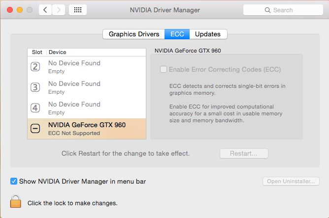

panini Posted February 8, 2016 Share Posted February 8, 2016 1 minute ago, Dschijn said: 1. owwwwww 2. with 1. Of course you need ALL power plugs to be connected to the GPU! All the time… How is the Sonnet powered? With the Sonnet PSU? 6pin from the Sonnet PSU 8pin from external PC I specifically asked before whether the GTX 960 needs ALL power connections at all times... Quote Link to comment Share on other sites More sharing options...
Dschijn Posted February 8, 2016 Share Posted February 8, 2016 (edited) I have a really bad feeling about your setup and mixing that 6/8-Pin plugs from different power supplies. Ok here is what I think. You got the Sonnet III-D, right? That huge Sonnet Case with beefy PSU. The GTX 960 G1 needs 2x6-Pin PCIe plugs. You can try and get a 6-Pin PCIe splitter (y-cable) and make two out of that single 6-Pin. With the Gigabyte card you made a rather unlucky choice since the G1 line can draw a LOT of power (peak loads). But it should still work. Edited February 8, 2016 by Dschijn Quote Link to comment Share on other sites More sharing options...
euqlaog Posted February 8, 2016 Author Share Posted February 8, 2016 On 6 February 2016 at 5:12 PM, panini said: 1. Does the 6 pin connector of the III-D supply enough power for the 960? I expected that your GTX 960 has only one 6-pin connector in which case the answer is yes. The power sockets of the GPU cannot be left unconnected, and you should never use two PSUs. Anyhow, now we know the script still works on Yosemite too. Quote Link to comment Share on other sites More sharing options...
panini Posted February 9, 2016 Share Posted February 9, 2016 5 hours ago, goalque said: I expected that your GTX 960 has only one 6-pin connector in which case the answer is yes. The power sockets of the GPU cannot be left unconnected, and you should never use two PSUs. Anyhow, now we know the script still works on Yosemite too. @goalque @Dschijn Thanks for clarifying! The 300W PSU of the III-D is what I bought it for in the first place! I get your drift about two pus's. I'll look into that, maybe for testing I can also power the Sonnet from my external PSU? I haven't even looked at it in the first place. Has anybody done this before? Experiences? Also @goalque @Dschijn what specific Nvidia cards do you use??? I don't mind looking into buying a supplementary one, but would like it to work 'more easily' though ;-) Thank you! Quote Link to comment Share on other sites More sharing options...
Dschijn Posted February 9, 2016 Share Posted February 9, 2016 Please first try and only use the 300W PSU of the Sonnet. Just split the power cable to the amount of plugs you need (from the one 6-Pin of the Sonnet to two 6-Pins). Nobody tried to power the Sonnet with another PSU and especially with a GTX960 I don't see a reason why.... I am currently using a KFA2 GTX970 Gamer OC, also known under the brand Galax GTX970 Gamer OC. Take a look at this builds: https://www.techinferno.com/index.php?/forums/topic/7855-2012-mac-mini-gtx97010gbps-tb1-sonnet-iii-d-win81-eoiz/ https://www.techinferno.com/index.php?/forums/topic/6181-2014-15-macbook-pro-iris-gtx98016gbps-tb2-sonnet-iii-d-win81-mrhappypills/ Quote Link to comment Share on other sites More sharing options...
panini Posted February 9, 2016 Share Posted February 9, 2016 @goalque @Dschijn Guys! Pirates of the eGPU-universe!! It's working now! I added an extra 8pin PSU connector and voilà! Thx for everything, and DO remember: beer is awaiting!! I've only checked the mac mini. Will check the MBP later and report back. Erwin 2 Quote Link to comment Share on other sites More sharing options...
