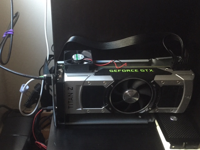

kblack21 Posted February 2, 2016 Share Posted February 2, 2016 Setup: Late 2013 27" iMac w/TB1 OS X Yosemite 10.10.5 (14F1605) 1000 Corsair PSU Modified AKiTiO Box powered by PSU with Barrel Plug mod Titan Z (Plugged directly into PSU) Secondary Monitor running at 2K Hey guys hate to come on like a noob (though i'll admit i'm pretty green at this), but i've had my setup for about 3 days and i've noticed a weird random Kernel Panic that doesn't happen too often (twice so far). The setup works great most of the time and doesn't seem linked to any extended time of use, so i'm not sure what causes it. If it helps right now I do have an external monitor plugged into the display port of the Titan. I don't use the egpu for gaming, it's solely for CUDA acceleration when I edit videos and animate. Will try an save the error report next time, but I think it made mention of "drv = 1" in both cases of the kernel panic. Apologize if its too vague of a description at the moment. Quote Link to comment Share on other sites More sharing options...
Dschijn Posted February 3, 2016 Share Posted February 3, 2016 Maybe an unstable cable? Thunderbolt cable or the barrel plug? Quote Link to comment Share on other sites More sharing options...
kblack21 Posted February 3, 2016 Share Posted February 3, 2016 Hmm the thunderbolt cable is a 6ft, think maybe that's causing issues? Quote Link to comment Share on other sites More sharing options...
Dschijn Posted February 3, 2016 Share Posted February 3, 2016 I am using a 2m Apple TB cable myself. Maybe your barrel plug doesn't "sit" right? Quote Link to comment Share on other sites More sharing options...
kblack21 Posted February 3, 2016 Share Posted February 3, 2016 I still think it might be the cable, I have an off brand TB cable too. Before I had the barrel plug I was using a riser and would on occasion get a similar occurrence. I'll try a switch out both though. Could you recommend a good barrel plug option, or did you create it yourself? Quote Link to comment Share on other sites More sharing options...
Dschijn Posted February 3, 2016 Share Posted February 3, 2016 36 minutes ago, kblack21 said: I still think it might be the cable, I have an off brand TB cable too. Before I had the barrel plug I was using a riser and would on occasion get a similar occurrence. I'll try a switch out both though. Could you recommend a good barrel plug option, or did you create it yourself? Let's continue here: https://www.techinferno.com/index.php?/forums/topic/6543-guide-making-a-molex-to-barrel-adapter/&page=3#comment-137372 Quote Link to comment Share on other sites More sharing options...

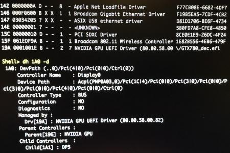

euqlaog Posted February 3, 2016 Author Share Posted February 3, 2016 (edited) A few days ago, when I was researching in greater depth the EFI, I found out something amazing. I had an Asus R9 270X plugged, reporting a valid GOP (AMD GOP X64 Release Rev.1.54) by the “drivers” EFI Shell command and by the “dh” command, which displays all the protocols that are associated with that device handle. So, I unplugged the TB cable, swapped for an Asus HD 7870 (non-UEFI card) which doesn’t report about the GOP by itself, replugged the TB cable, typed “dh -p graphicsoutput” and the shell printed TxtOut, GraphicsOutput, EdidDiscovered and EdidActive protocols for the HD 7870. All the display interfaces worked (HDMI, DP, DVI). They can be seen under the device tree as “DFP2_HDMI” for example. The same trick worked for my another non-UEFI AMD card as well. Intel’s UEFI Specification 2.0 says “A PCI Device Driver should not be designed to care where it is stored. It can reside in a PCI Option ROM, the system's motherboard ROM, a hard drive, a CD-ROM drive, etc. All PCI Device Drivers are compiled and linked to generate a PE/COFF image.” Sounds logical. When the driver image is loaded, it stays permanent in the memory, even if the eGPU is swapped. I also looked at a couple of Nvidia’s UEFI images. Nvidia’s UEFI section in the ROM file complies with the Intel’s recommended PCI device driver layout (has 0x0EF1 value at offset 0x04). Took out the PE/COFF part from the correct offset, decompressed it with efidecompress command successfully, and then tried load command, but the EFI Shell said “incompatible version”. I said earlier that my Nvidia cards didn’t seem to support GOP. I meant that my test app didn’t find any frame buffer. I was thinking that if I could load the Nvidia GOP driver as well, but for some reason it wasn’t compatible. No new Nvidia drivers appeared in the list of loaded EFI drivers and that explains why my EFI test app didn’t find the GOP for my Nvidia card. AMD UEFI worked out of the box. I didn’t give up. Thought maybe a Kepler card UEFI GOP would work, so did the same extract procedure for the GTX 780 ROM. Plugged in my USB stick, typed “load GTX780_dec.efi” and… Success. These tests confirm what Intel says - the UEFI driver doesn’t have to be in the GPU ROM. As we know, the eGPU boot screen is not important with TB Macs since it’s always visible through the iGPU/dGPU. However, I’m rethinking about EFI version of the automate-eGPU.sh since I found a way to bypass SIP via dmpstore in EFI environment. That would be a huge amount of work. At least, my EFI test app written in C will be available on GitHub. Edited February 3, 2016 by goalque 3 Quote Link to comment Share on other sites More sharing options...

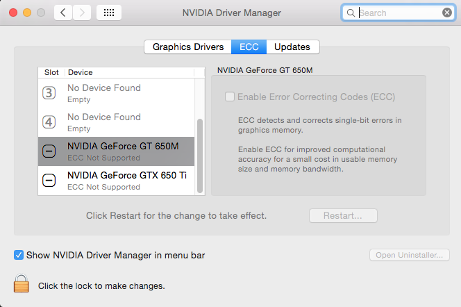

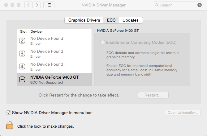

panini Posted February 6, 2016 Share Posted February 6, 2016 (edited) On 2/2/2016 at 5:22 AM, panini said: Here are my build versions: 01-02-2016 23:10 10.10.5 (14F27) MacBook Pro 10.10.5 (14F1605) Mac mini I will test and try -a mode and report back in the next couple of days. Hi, Thanks for sticking with me. 1. Tested on 10.10.5 build 14F1605 mac mini - I took out the GTX 650 Ti - boot and run sudo ./automate-eGPU.sh -a (system reports background services enabled) - halt machine - added GTX 960 & reboot => machine boots and runs without problem <=> eGPU does not work Also NVIDIA driver manager shows 4 empty slots?? 2. Another test: - added a MSI GeForce 9400 GT card - it just works - But why does it keep reporting 4 empty slots in nvidia driver manager? - and adding a slot without a number?? What can I do to debug this situation? Thx, Erwin Edited February 6, 2016 by panini additional info Quote Link to comment Share on other sites More sharing options...
euqlaog Posted February 6, 2016 Author Share Posted February 6, 2016 1 hour ago, panini said: Hi, Thanks for sticking with me. 1. Tested on 10.10.5 build 14F1605 mac mini - I took out the GTX 650 Ti - boot and run sudo ./automate-eGPU.sh -a (system reports background services enabled) - halt machine Did you also type "sudo ./automate-eGPU.sh" before executing "sudo ./automate-eGPU.sh -a" ? Quote Link to comment Share on other sites More sharing options...

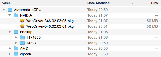

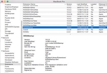

panini Posted February 6, 2016 Share Posted February 6, 2016 (edited) 3 hours ago, goalque said: You should have the following structure under /Library/Application Support/Automate-eGPU/ - Do you have FileVault turned off? - Can you try another Maxwell architecture GPU? Thank you for going through all this trouble to help me! Much appreciated!! - file structure resembles yours, but I don't have 346.02.03f05 (I checked both MBP and Mini) - FileVault: I have never used it, it is off - Try another Maxwell architecture GPU - unfortunately the GTX 960 is the only one I have right now, that was why I was looking at the EVGA.. => I was also checking this thread and compared with my systems and it struck me that NVDAStartup is not loaded... see screenshot below. Also the last modified date seems odd? - For the commands you asked: Quote MBPI7-2:Extensions erwin$ syslog -B -F '$Time $(Sender): $Message' | grep NVDA Feb 6 19:45:58 kernel: NVDAStartup: Web Feb 6 19:45:58 kernel: NVDAGK100HAL loaded and registered Quote MBPI7-2:Extensions erwin$ kextstat -l |grep NVDA 118 2 0xffffff7f81006000 0x2d8000 0x2d8000 com.nvidia.web.NVDAResmanWeb (10.0.5) <94 88 85 12 7 5 4 3 1> 132 0 0xffffff7f814ff000 0x1af000 0x1af000 com.nvidia.web.NVDAGK100HalWeb (10.0.5) <118 12 4 3> MBPI7-2:Extensions erwin$ Edited February 6, 2016 by panini Quote Link to comment Share on other sites More sharing options...
euqlaog Posted February 7, 2016 Author Share Posted February 7, 2016 @panini You have messed up your system if you are running build 14F1605 on Mac mini and there is no driver 346.02.03f05 for NVDAStartup. Reinstall OS X. Never install/update Nvidia web drivers manually. Let the script download the correct driver. On OS X Yosemite, the NVDAStartup stays loaded just a moment after restart so run kextstat command immediately. It’s normal that it vanishes away from the kextstat list and shows Loaded: No. Quote Link to comment Share on other sites More sharing options...
