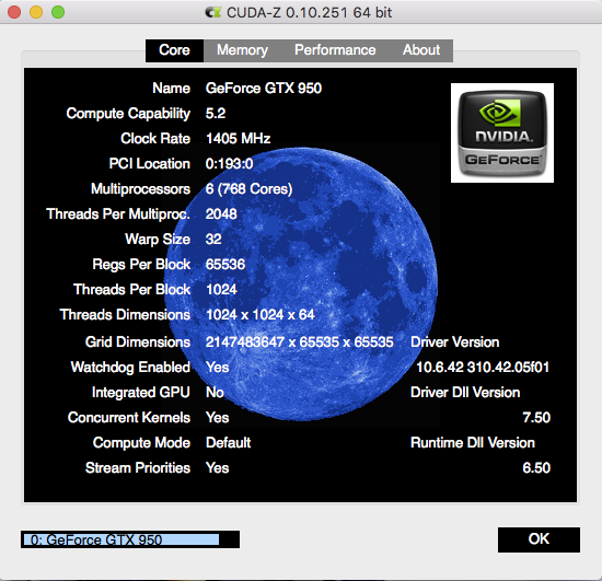

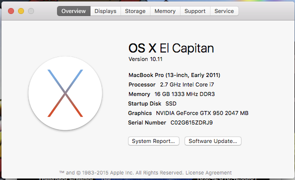

hitsilent Posted January 29, 2016 Share Posted January 29, 2016 Hi goalque, i was install the GTX 950 + DELL DA-2 + Akitio Thunder2 successfully, but the performance is kind of slow, it should not be that slow. it might be the PSU ? or the driver problem ? i was run your script, and do anything correctly , i can see my GTX model show in the about my mac. i have no idea why that slow. Can you help ? Thanks ~~ Quote Link to comment Share on other sites More sharing options...
Dschijn Posted January 29, 2016 Share Posted January 29, 2016 What is "slow"? Quote Link to comment Share on other sites More sharing options...
hitsilent Posted January 29, 2016 Share Posted January 29, 2016 11 hours ago, Dschijn said: What is "slow"? low performance, low FPS. cant play game. even my mouse is not smooth Quote Link to comment Share on other sites More sharing options...
euqlaog Posted January 29, 2016 Author Share Posted January 29, 2016 @hitsilent A screenshot of OS X 10.11? So you didn’t follow the update procedure that I described? The GTX 950 is supported on OS X 10.11.3. The script will take care of matching the correct web driver. Quote Link to comment Share on other sites More sharing options...

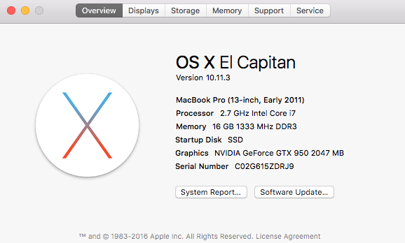

euqlaog Posted January 30, 2016 Author Share Posted January 30, 2016 15 minutes ago, hitsilent said: sorry i didn't pay attention your reply, i did follow your description, is that mean i have to update to OS X 10.11.3 to support my GTX 950 ? Yep. The GTX 950 was launched just before OS X 10.11, that’s why OS X 10.11.3 and the latest web driver is recommended. The web driver is bound to OS X version. Quote Link to comment Share on other sites More sharing options...

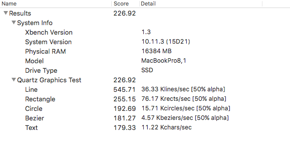

hitsilent Posted January 30, 2016 Share Posted January 30, 2016 (edited) 2 hours ago, viniguez said: "turned off" internal monitor by not mirroring screens, making external the primary by moving the menu bar over the top of the external screen, and then closing the laptop lid. Now everything is moving fast as hell. Thanks again! @goalque I was follow Viniguez how he solve the issue, and update the OS X to 10.11.3, and download the Xbench run the Quart Graphics Test, it scores 220+, and download the DisableMonitor for Github, disable the internal monitor and close the laptop lib, but still same thing mouse sluggish when i playing game. I was feeling Depression, i was working for the EGPU for 2 weeks. still not make it work , i dont want to give it up. Edited January 30, 2016 by hitsilent Quote Link to comment Share on other sites More sharing options...
hitsilent Posted January 30, 2016 Share Posted January 30, 2016 @goalque good news, i choose the Graphic mode from Windows mode(maximum) to full Screen mode, now the game is running smooth . i was playing Hero of Storm. thanks for all your reply . 1 Quote Link to comment Share on other sites More sharing options...
