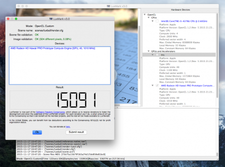

flerwa Posted November 24, 2015 Share Posted November 24, 2015 Hey, First of all thanks to goalque for his great job make it much easier to use a egpu. I also want to built an egpu but I am not sure wether i should buy an gtx 970 or an and R9 390. I've read about many successfully builds with the nvidia in this forum but the 390 has more power to play games in wqhd. So my question is wether anybody has made experiences with the 300 series from amd. Thanks for your help sorry for my bad english Quote Link to comment Share on other sites More sharing options...
euqlaog Posted November 24, 2015 Author Share Posted November 24, 2015 First of all thanks to goalque for his great job make it much easier to use a egpu. I also want to built an egpu but I am not sure wether i should buy an gtx 970 or an and R9 390. I've read about many successfully builds with the nvidia in this forum but the 390 has more power to play games in wqhd. So my question is wether anybody has made experiences with the 300 series from amd. Thanks for your help Thanks! R9 390 is a very powerful card and my favourite, but keeps crashing with AKiTiO: https://forum.techinferno.com/implementation-guides-apple/8585-2014-15-macbook-pro-2x-r9_280x%4016gbps-tb2-netstor-na211tb-win8-1-osx-%5Bgoalque%5D-3.html#post143064 Quote Link to comment Share on other sites More sharing options...
flerwa Posted November 24, 2015 Share Posted November 24, 2015 Thanks for your quick answer.Would it work with a r9 290x or crash every card from the r9 xxx series.I don't want to buy a gtx 970 because I think i get trouble playing in 2560 x 1440 resolution.[h=1][/h] Quote Link to comment Share on other sites More sharing options...
euqlaog Posted November 24, 2015 Author Share Posted November 24, 2015 As far as I know, crash happens with every card from the r9 series. This issue is somehow related to the AKiTiO hardware, it’s detected as x4 on OS X, but a multi-slot NA211TB is detected as x8. 1 Quote Link to comment Share on other sites More sharing options...
