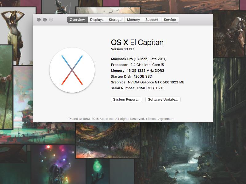

Just wanted to reflect that I have just tested the script 0.9.7 with a 2012 MacBook Air attached to a netstor thunderbolt 2 300w PSU chasis containing a GTX 970. Had to disable csr to allow the script to work.
Woohoo!!! Awesome feeling seeing the card recognized in the system profile.
Am wondering if you guys can provide some guide to watch out for or what are the things that will potentially cause the csr to be enabled unknowingly? And if I want to update the OS what should I watch out for?
Again thanks for this!!! Can I drop some donation for this?

Yes, the System Integrity Protection must be disabled in order to run the script. It’s Apple’s security layer and recommended to keep enabled.
https://support.apple.com/en-us/HT204899
Not even “sudo touch” is permitted in the /System directory. Fortunately, the modified kexts will be loaded with signature validation errors even if SIP is re-enabled, and those 3rd party kexts that are signed by NVIDIA can be modified in SIP enabled mode. When I find time, I’ll investigate possibilities for more simplified installation procedure on OS X El Capitan.
