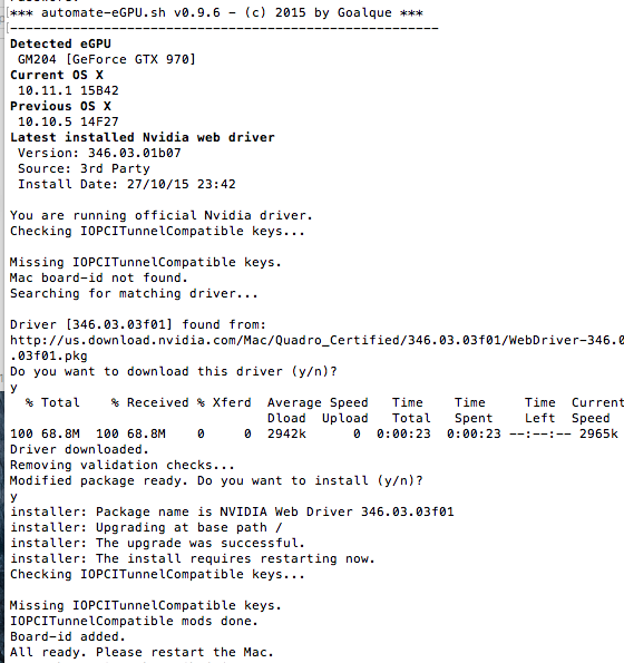

Hey Guys so I'm having a bit of trouble with getting my macbook to see my Gtx 970. I did everything correctly, got the script to run after i disabled "Crsutil"
My Specs:
rMBP 2015,
2.7 GHz intel Core i5
8gb of ram
Intel Iris Graphics 6100
OSX: El Capitan 10.11
EVGA 650W Power Supply
Akitio PCIe thunderbolt 2
Gtx 970
I got it to run and was using a thread from this site on how to get my computer to see the card but my computer kept black screening.
I need help, or exact instructions on how to get my macbook to recognize my card,

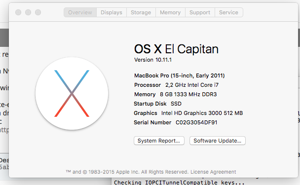

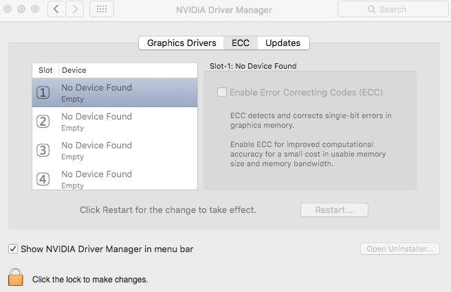

Hey Guys,
i think I've got maybe the same problem. I run disabled crsutil and run the script(v0.9.6 & v0.9.7) ... but my external screen is still black.
My Setup:
MBP 2011 15"
2,2 GHz i7
8gb Ram
Intel HD 3000 / AMD 6750
My egpu setup:
MSI GTX 70
Hope you can help me
Thanks

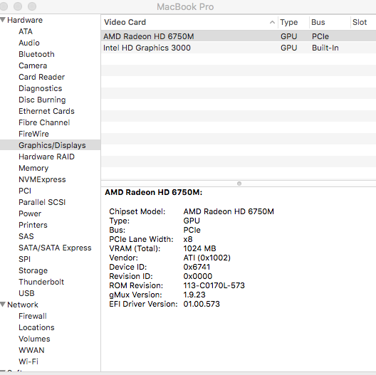

Weird. Did you try the [-a] mode? It looks like you have no eGPU connected at all after restart. You can run the script, but no eGPU visible. Let’s see if it’s a hardware issue… can you give the output of these Terminal commands (eGPU connected):
system_profiler SPDisplaysDataType
system_profiler SPThunderboltDataType
Graphics/Displays:
Intel HD Graphics 3000:
Chipset Model: Intel HD Graphics 3000
Type: GPU
Bus: Built-In
VRAM (Dynamic, Max): 512 MB
Vendor: Intel (0x8086)
Device ID: 0x0126
Revision ID: 0x0009
gMux Version: 1.9.23
Displays:
Color LCD:
Display Type: LCD
Resolution: 1680 x 1050
Pixel Depth: 32-Bit Color (ARGB8888)
Main Display: Yes
Mirror: Off
Online: Yes
Built-In: Yes
AMD Radeon HD 6750M:
Chipset Model: AMD Radeon HD 6750M
Type: GPU
Bus: PCIe
PCIe Lane Width: x8
VRAM (Total): 1024 MB
Vendor: ATI (0x1002)
Device ID: 0x6741
Revision ID: 0x0000
ROM Revision: 113-C0170L-573
EFI Driver Version: 01.00.573
NVIDIA Chip Model:
Chipset Model: NVIDIA Chip Model
Type: GPU
Bus: PCIe
PCIe Lane Width: x4
Vendor: NVIDIA (0x10de)
Device ID: 0x13c2
Revision ID: 0x00a1
ROM Revision: preset 1.0.0
Thunderbolt:
Thunderbolt Bus:
Vendor Name: Apple Inc.
Device Name: MacBook Pro
UID: 0x0001000A1CEC0BA0
Route String: 0
Firmware Version: 22,1
Domain UUID: 4E204530-38D1-7459-B066-831812A41503
Port:
Status: Device connected
Link Status: 0x2
Speed: Up to 10 Gb/s x2
Receptacle: 1
Port Micro Firmware Version: 2.1.3
Cable Firmware Version: 0.1.23
AKiTiO Thunder 2 Box:
Vendor Name: inXtron
Device Name: AKiTiO Thunder 2 Box
Vendor ID: 0x41
Device ID: 0x236
Device Revision: 0x1
UID: 0x00410236148019C0
Route String: 1
Firmware Version: 24,1
Port (Upstream):
Link Status: 0x2
Current Link Width: 0x1
Link Controller Firmware Version: 0.14.0
Port:
Status: No device connected
Link Status: 0x7
Thanks for the quick reply
@chrise:
Thanks for the details. How is your eGPU powered?
“NVIDIA Chip Model” is detected so your “Graphics/Displays” screenshot is not up to date. Press Command + R to refresh the view.
To see what has happened since the previous startup (eGPU plugged), type the following:
syslog -B -F '$Time $(Sender): $Message' | grep NVDA
and if the kexts are loaded or not:
kextstat -l | grep NVDA

Heres the kextstat output
142 0 0xffffff7f83dc2000 0x3000 0x3000 com.nvidia.NVDAStartupWeb (10.0.7) 012173D2-0B7B-360E-84E4-C5F7C7AE200D <12 4 3>
145 2 0xffffff7f83dc5000 0x2d6000 0x2d6000 com.nvidia.web.NVDAResmanWeb (10.0.7) B091F84F-7F3A-38DB-A8FC-94A59142D9FA <111 98 87 12 7 5 4 3 1>
146 0 0xffffff7f8409b000 0x1fd000 0x1fd000 com.nvidia.web.NVDAGM100HalWeb (10.0.7) EF27E881-89F0-3FAF-8327-7BC86FBA3FB4 <145 12 4 3>
The eGPU(akitio & GPU) is powered via Dell DA-2
Okay here ist the syslog output:
Oct 28 20:47:41 kernel: Driver "NVDAStartup" needs "IOPCITunnelCompatible" key in plist
Oct 28 20:47:42 com.apple.kextd: kext-dev-mode allowing invalid signature -67030 0xFFFFFFFFFFFEFA2A for kext "/System/Library/Extensions/NVDAStartupWeb.kext"
Oct 28 20:47:42 kernel: Driver "NVDAStartup" needs "IOPCITunnelCompatible" key in plist
Oct 28 20:47:42 kernel: NVDAStartupWeb: Web
Oct 28 20:47:43 kernel: NVDAGM100HAL loaded and registered
Oct 28 20:47:43 kernel: Driver "NVDAStartup" needs "IOPCITunnelCompatible" key in plist
Oct 28 20:47:46 kernel: NVDA::rmStart failed
Oct 28 20:47:46 kernel: NVDA,Display-B: Not usable
Oct 28 20:47:46 kernel: NVDA,Display-C: Not usable
Oct 28 20:47:46 kernel: NVDA,Display-D: Not usable
Oct 28 20:47:46 kernel: NVDA,Display-E: Not usable
Oct 28 20:47:46 kernel: NVDA,Display-F: Not usable
