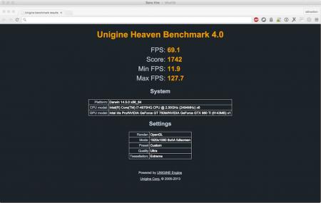

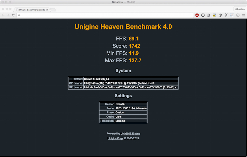

soularchive Posted October 1, 2015 Share Posted October 1, 2015 Finally ! The script v0.9.6 is working perfectly, everything is very stable, i just can't boot with 2 external monitors. I have to boot with 1 monitor attached and then hotplug the second one into the graphic card but, after that, it works like a charm. The retina display switch automatically from Iris pro to the GT 750m. I've done a benchmark to test the eGPU. Here is the result in comparison to other results you can found here (Unigine Heaven 4.0 Benchmark Scores | TechPowerUp Forums ): Regarding the issue, i've realized that the GC was definitely the problem when i had tested the Akitio setup with a GeForce GTX 560 Ti and everything was working (unless the internal screen not recognized, an issue which come from the v0.9.7). Now my GC is replaced and here is the setup at this state : I just wonder how it is possible to optimize the system to use at least 80% of the capability of the 980 TI ? Is it really limited by the 4 lane PCI Express 2.0 interface of the Akitio (which is 5.0Gbps) and is it possible to double it with a second thunderbolt cable ? There is a great article about the difference of efficiency between several configuration in PCI-E : GeForce GTX 980 PCI-Express Scaling | techPowerUp For a GTX 980 there is not so much contrast so maybe a GTX 980 TI manage more data than 5.0Gbps ? That being said, the result is still very good and it is so convenient to be able to use the dGPU for other operations on the internal screen ! I realize now that thanks to your script it is very easy to use a eGPU on OSX, even for a beginner . Now i'm going to work on making a box to be able to transport it safely. I will write a thread soon in the Implementation Guides section once everything is in place. Thank you again for the help ! 1 Quote Link to comment Share on other sites More sharing options...

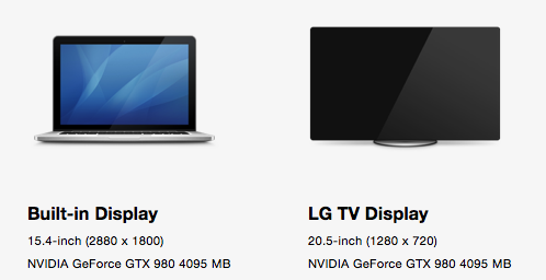

gpufreak Posted October 2, 2015 Share Posted October 2, 2015 Used this script today and the installation process completed without any problems. However I'm a little confused; GPU shows up in system report, however the external display is using integrated graphics? Also, After Effects (CC 2014) does not recognise the CPU. GPU: Zotac GTX980 Akitio Thunder2 OS X Yosemite 10.10.5 FileVault enabled MBPr 15" 2014 IG Would appreciate any help! Screenshots below. Quote Link to comment Share on other sites More sharing options...
euqlaog Posted October 2, 2015 Author Share Posted October 2, 2015 Used this script today and the installation process completed without any problems. However I'm a little confused;GPU shows up in system report, however the external display is using integrated graphics? Also, After Effects (CC 2014) does not recognise the CPU.GPU: Zotac GTX980Akitio Thunder2OS X Yosemite 10.10.5FileVault enabledMBPr 15" 2014 IGSeems like you hot plugged the LG TV display. The app will launch from the screen that is set as the primary, so drag the menu bar to eGPU display, disable FileVault and try again. Quote Link to comment Share on other sites More sharing options...
gpufreak Posted October 2, 2015 Share Posted October 2, 2015 Seems like you hot plugged the LG TV display. The app will launch from the screen that is set as the primary, so drag the menu bar to eGPU display, disable FileVault and try again. Thanks, now I'm seeing the following although AE is still not recognising the GPU: Quote Link to comment Share on other sites More sharing options...
