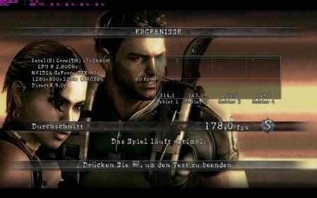

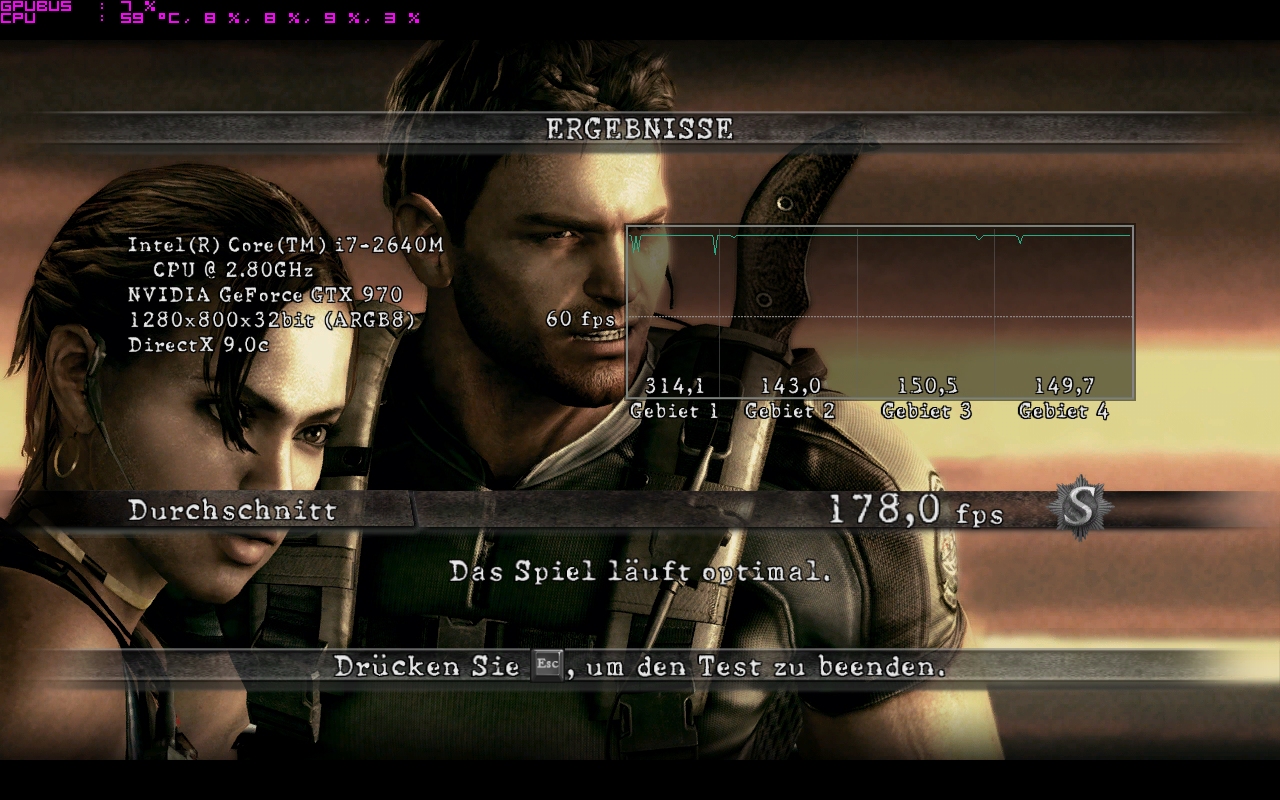

I used my 2560p and EXP GDC today together with my GTX970. Everything runs pretty well and I could play Witcher 3 on high setting for an hour without problems (and that with an old sandy bridge dual core!). BUT somehow I can't run the 3dmark13 Firestrike benchmark completely. My Laptop will just reboot at some point and the eGPU seems to completely turn off. :/
Anyhow, here are the results with my GTX970 (HP 2560p, i7 2640m, 8GB, EXP GDC Beast, x1.2)
RE5 benchmark: 178fps
3DMark06: 21371
3DMark11 (GPU): 12841
Should I submit them somewhere so they get added to the list?
Also I noticed that I indeed got a significant lower score before because my CPU was throttling down. I will try to install a liquid pro pad this week, I reckon it will bring down the temp by 2-5°, which is about was I need.
