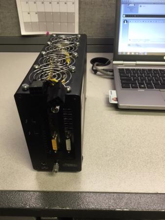

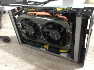

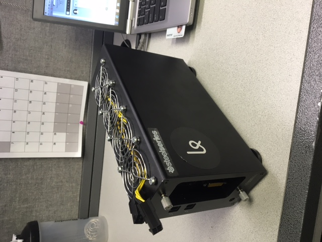

Dschijn thank you for you detailed guidelines. I have built a similar setup with galax 970. I also cut the side of akitio for 2 black 120mm akasa filters. Thus I am using stock fan with the 970 and I wonder if noctuas improved your cooling (I am ok with the sound) . Also I wonder if I should cut the top for exhaust exit. Although I haven't tested it with full load, it showed similar temperature figures.
BTW 12V 16mm LED Power Push Button Switch fits perfectly to the front. I cut the corners of two 60mm fans and placed it in between. Unfortunately blue LED one's clicker died after 10 clicks and I switched to the red instead. Waiting your comments.
Cheers!
@toxec: It helped a bit. I am still hitting 80°C with that fans but with a good overclock. Most important is to have a good air intake. Making a good exhaust is helping the air to get out of the case and lowering the "force" needed to press air into the case.
Good job with the button :D

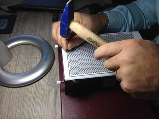

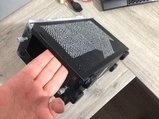

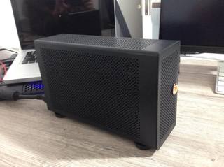

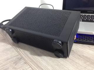

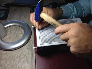

@Dschijn I drilled around 3985 2mm holes at the top, bottom and side of the box as @seefew 's grey akitio setup. Drilling only the side increased the inner air pressure and limited air flow. Opening the top and the bottom helped a lot. Now on idle it works around 20-33℃ and on full load it works around 55-72℃. As mentioned above I am using 2X60mm fans in the front and stock 970 fan without overclock.
On the other hand I am using a generic 8pin-6pin cable setup with dell adapter. The power switch is connected between a power line and adapter's pin. Thus cables are a bit longer than required (creating around 1-2 microfarad in total) and touching graphic card and board. Therefore I am considering direct soldering to the graphic card's back or at least a minimalist setup as @seefew to have efficient frequency. Thus I do not know whether I should get rid of the power switch. I like how it works but I worry if it charges electricity to the mac's thunderbolt socket when it starts first.(I am not using grounded magsafe so I guess it should be fine either way). I might solder a line between akitio's capacitor and dell adapter's switch pin to benefit 3V coming from mac's thunderbolt socket. Thus I wonder If waking akitio's board and the graphic card with mac's power will have an affect on the booting sequence resulting mac not to start on the external graphic unit.(always on unit is not an option)

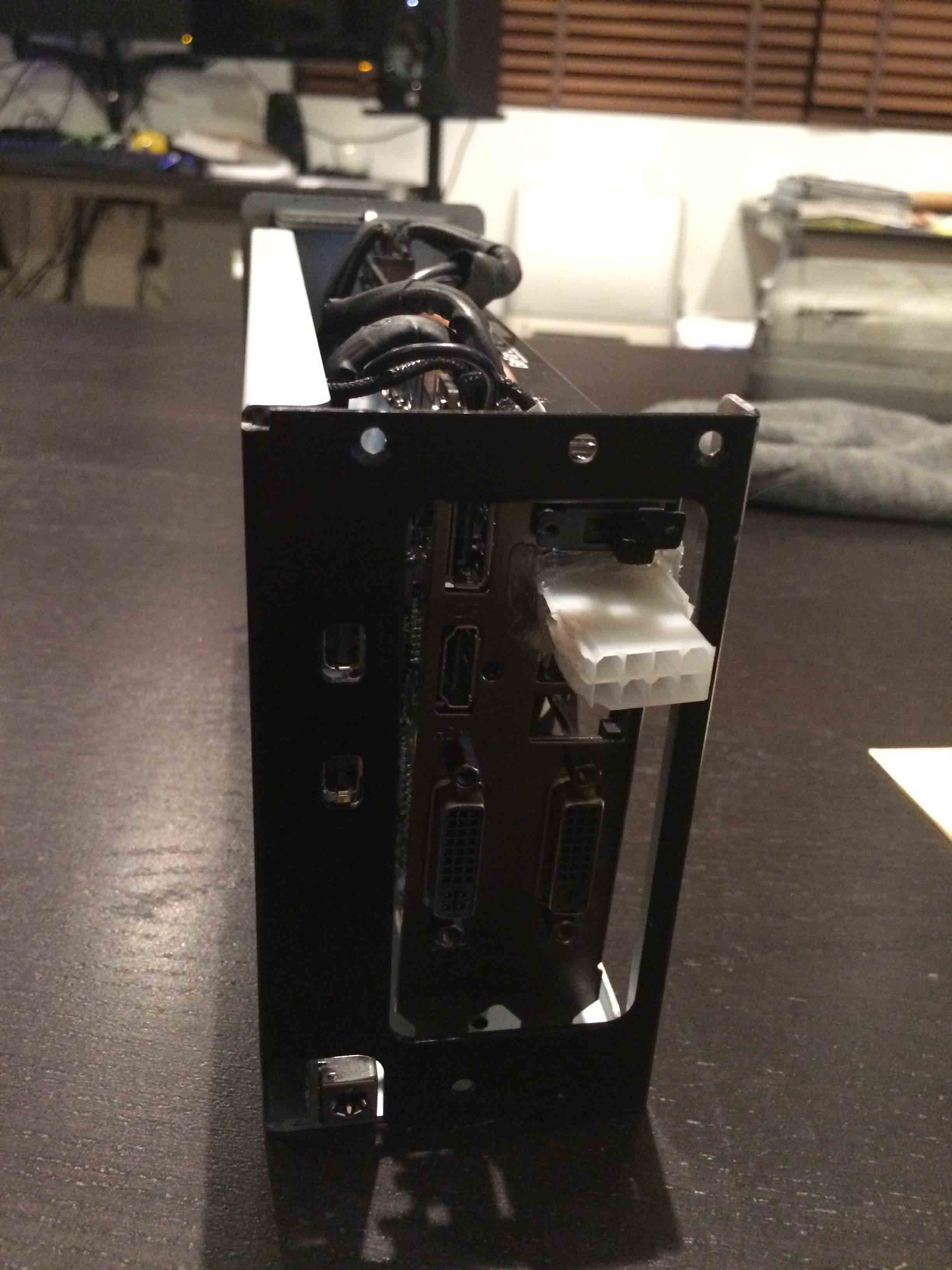

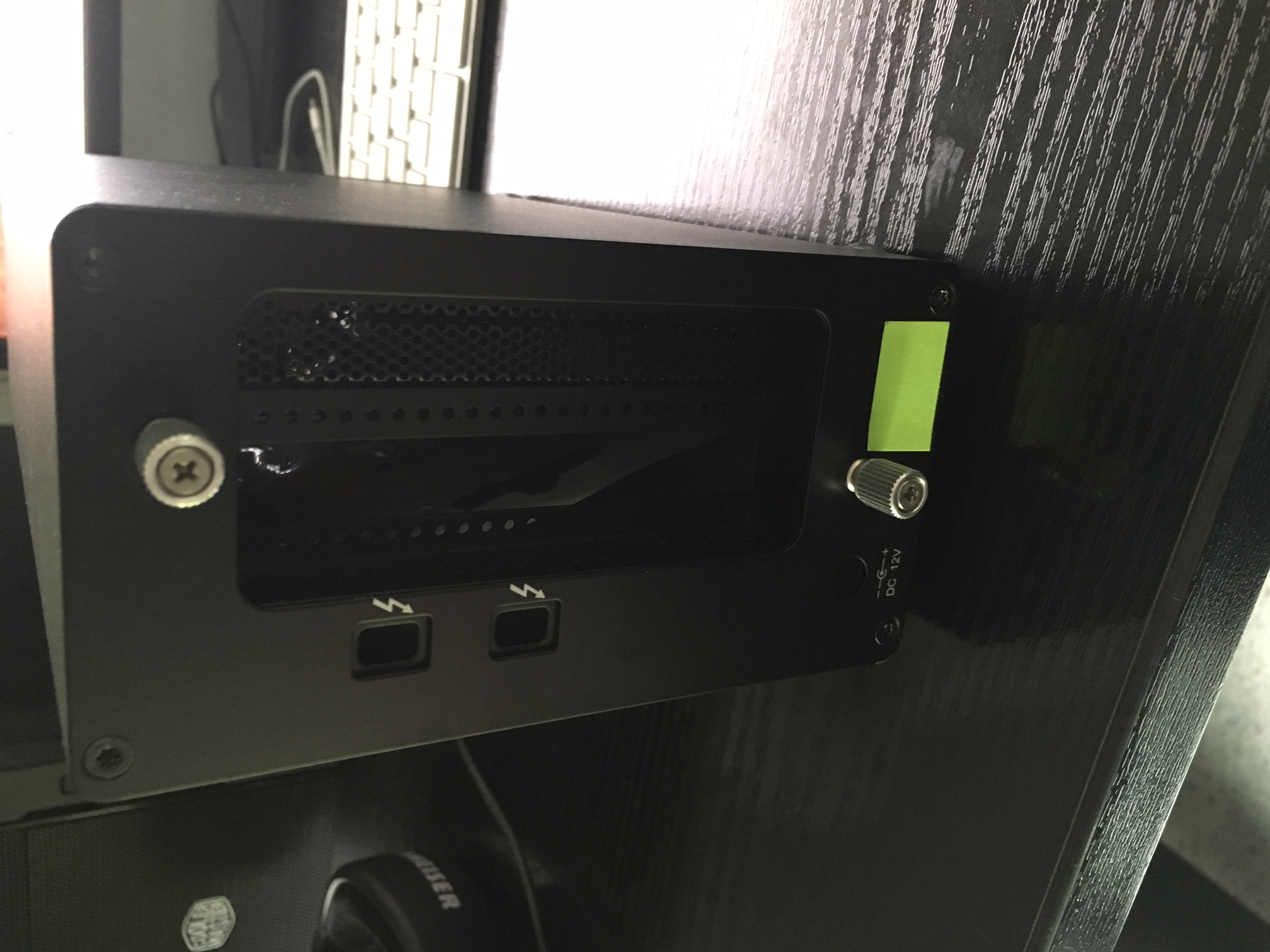

@Dschijn Can you post a picture of how you cut the case for the DA2 plug? It looks like a nice place for the plug.

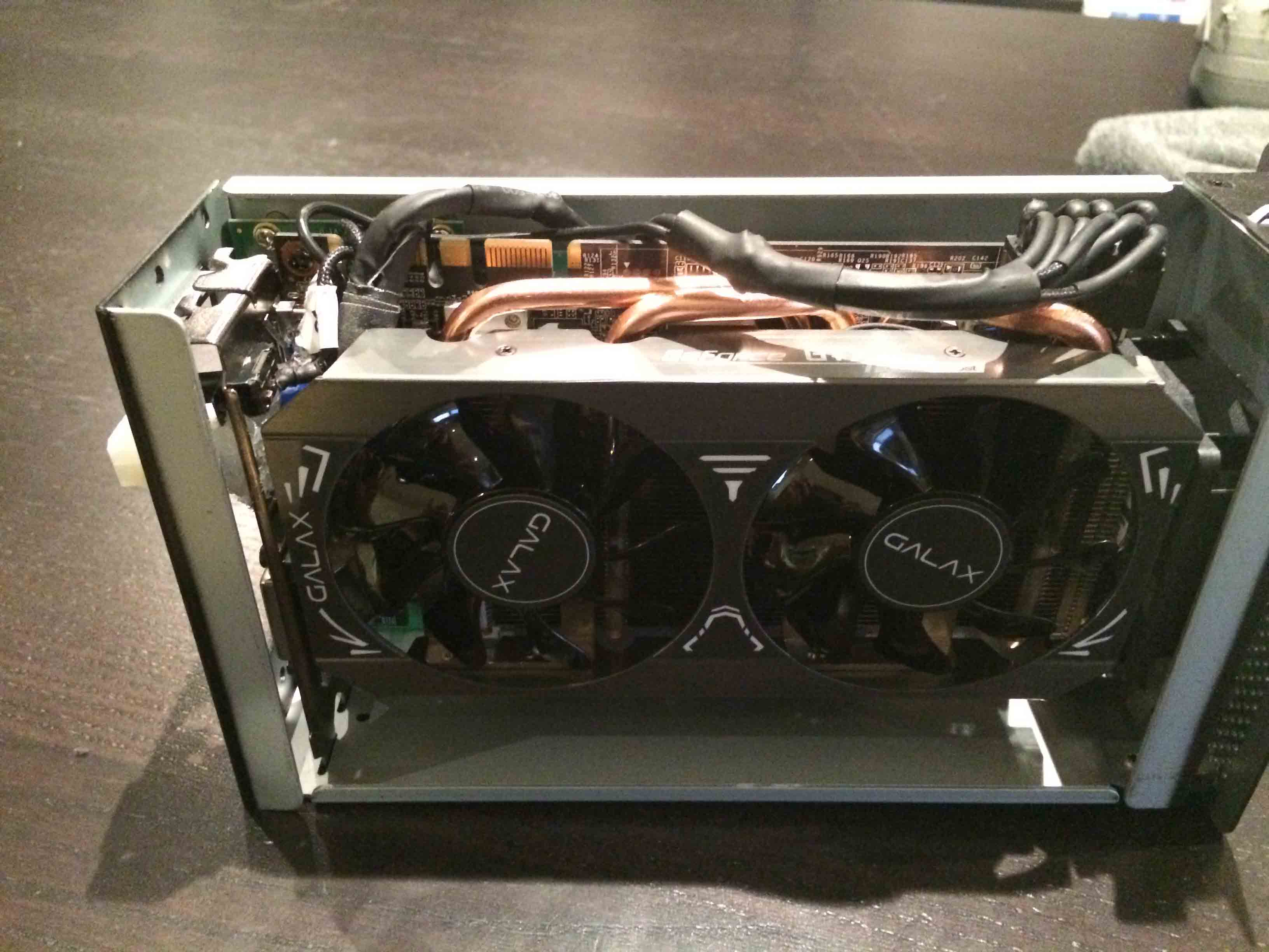

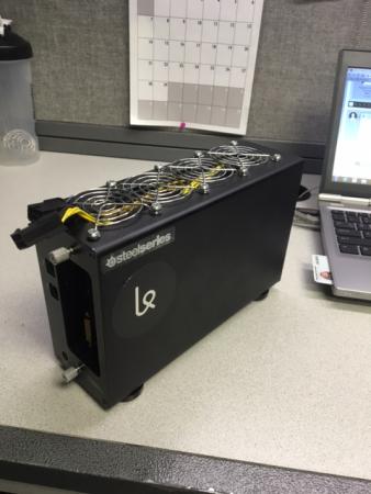

I've used hot glue to stick the plug and the switch to the GPU's grill. Thing is - I can't use the 2 slot card holder from akitio anymore - that would be without cutting it. I don't really want to cut it so I think I'm going to do a rewire.
I've ordered this custom cable that you guys were talking about.
I spent a ton of time trying to get the pins out and back in, broken pins & whatnot. I hope this cable would help me do better wiring.
As you can see in the photos, the wires are not so long and they're going into the back of the board - which is not great. Then if I close the case, the thick cable would touch the copper pipes and I'm afraid that this would damage the cable when it really heats up. Did you remove Akitio's fan? I haven't removed it for now and I'm not sure if that's necessary. I could keep it and put it the other way around so that it pulls air from the case
For now, I'm feeding all the DA2 12V positions into the GPU and I'm also using Akitio's PSU.
I've read about some instability issues so I've built a small PCB with 3 2200uF 24V capacitors. Do you guys think these would work fine?
Would using both Akitio's PSU and the DA2 work fine? Or is it just a matter of many cables? I figure that if I use both PSUs, there wouldn't be any need for the capacitors.
I'm also thinking about not using the barrel plug, but soldering the cables to the back of the case plug.
Edited by razvani
PICTURES
@razvani Sorry, no more pictures, because the eGPU is in the mail :(
But that plug can be been on the first post with the DA-2 plugged in. From the backside the cut is on the right of the case screw and the plug itself snuggles into the gap that is inside the case betwen the back of the case and the lower end of the GPUs i/o shield.
On your picture it would be the very bottom left from the inside.
Dschjin,

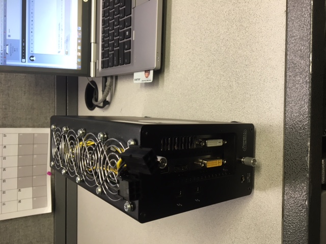

       I have finished my eGPU and have been playing games flawlessly on them. I want to follow the same exact build you have minus a few electrical things but I am just wondering on the fans for the side of the case. I am just wondering which of these fans will work, if I order two of them,
http://www.amazon.com/Noctua-Ultra-Silent-140mm-NF-P14/dp/B002XISTXM
http://www.newegg.com/Product/Product.aspx?Item=N82E16835608031
 and if they do work, if this wire would work as well to connect them to the graphics card.
http://www.moddiy.com/products/4%252dPin-PWM-Fan-Connector-(Male)-to-4%252dPin-Mini-GPU-Fan-Connector-(Female).html
http://www.amazon.com/OKGEAR-n-a-140mm-Chrome/dp/B0012UWHYY/ref=pd_sim_147_5?ie=UTF8&dpID=41EneBlsqDL&dpSrc=sims&preST=_AC_UL160_SR160%2C160_&refRID=1A1BT0MG96HJTE4E9X2W
I want to make cuts on the case, but I want to make sure I have all the parts I need. Please let me know if you have any advice. Thank you.
I doubt that a 140mm fan will fit...
I used 92mm fans that are very slim, just 14mm thick, the Noctua A-Series NF-A9x14 you linked.
For the connection to the GPU I used this one, to connect two fans at once: http://www.moddiy.com/products/4%252dPin-VGA-PWM-Mini-Connector-to-Dual-PH-Mini-4%252dPin-Fan-Cable-Splitter.html
And of course a pair of 92mm black fan grills.

Dschijn,
     So I got all my supplies together today and I noticed that the splitter and the power cable that comes off the fans are two different sizes, the fan I bought is the NF-A9x14 I linked previously, is there a fix to this problem like an adapter, or did I get the wrong fans. Side note: the splitter you linked fits perfectly on the graphics card so now I just need the fans to plug it into. Thank you.
Uhhhhh damn. I am so sorry. I linked the wrong splitter. It should have been this one: http://www.moddiy.com/products/Mini-4%252dPin-GPU-to-2-x-4%252dPin-PWM-Fan-Adapter.html
Really sorry. You can still use the splitter you bought, but you would have to solder new plugs on it.
