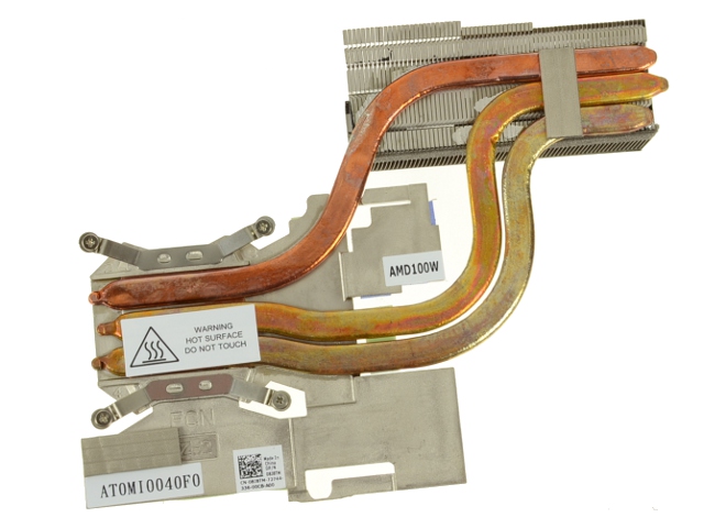

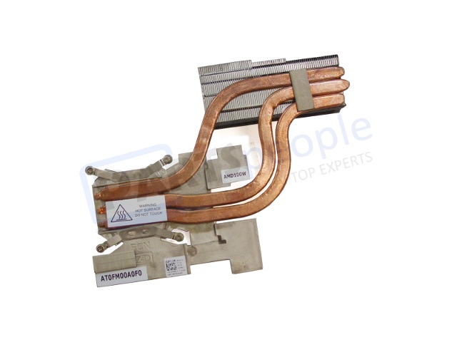

Right Side Video Card Heatsink
For R1: DP/N: 29NC1 029NC1 AT16L0010F0, AT0FM00A0C0
For R2: DP/N: 8J8TM, 08J8TM, AT0MI0040C

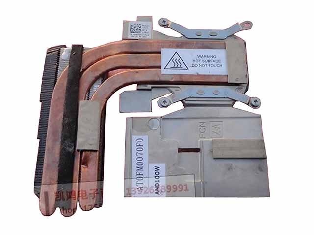

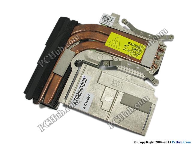

LEFT Side Video Card Heatsink
For R1: DP/N: 0Y8T9Y, AT0FM0070F0
For R2: DP/N: V4NXK, 0V4NXK, AT0MI0010C0

Between you and me, the heatsink performance is the same. However, if you can get the R2 heatsinks for the same price, you might as well. They provide more coverage though you will need more heat transfer material to cover the areas that were not covered initially in the previous revision.
