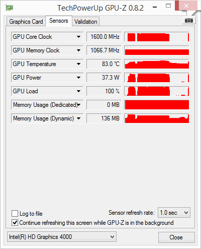

OCing Intel HD4000 on a Dell Latitude E6430
After Khenglish posted a while back
Have you tried overclocking the iGPU with the IFR mods?
I promised that I would try that.
But is it worth it? Let's find out.
I followed Atonus' instructions to modify the UEFI variables below using a bootable USB stick containing grub.
Setting: GT OverClocking Support, Variable: 0x16F
Option: Disabled, Value: 0x0
Option: Enabled, Value: 0x1
End of Options
Numeric: GT OverClocking Frequency, Variable: 0x170
Default: 8 Bit, Value: 0x16
End
Numeric: GT OverClocking Voltage , Variable: 0x171
Default: 8 Bit, Value: 0x0
End
Variable 0x16f should be enabled in order for the other two to be valid. So you set this to Enabled.
The other two are 8-bit numeric meaning that you can enter any value from 0-255 in hexadecimal so respectively from 0x00-0xFF.
On the GT Overclocking Frequency I realised that the resulting frequency was the result of [the decimal value] x 50MHz. e.g if I set value to 0x22 it would be 34 x 50MHz = 1700MHz . Anything under the maximum multiplier of your iGPU is not changing anything.
On the GT Overclocking Voltage I am guessing that there is a 0.01 increment for every value from 0x00 to 0xFF. E.g. I think that if I set the value to 0x05 I would have a 0,05V increment etc.
Since I didn't want any load from the CPU because a huge load on the CPU would trigger TDP throttling I used the Furmark 720p benchmark to test the performance gain from one frequency to the other. All tests where done using my i7-3720QM @ stock with 2x4GB Kingston RAM @ 2133MHz (except for the first which was done with i3-3120M and 2x4GB @1600MHz just for reference)
I didn't use BCLK OC but I hope I will have time to test further. I started from 1,25 GHz and went all the way up to 1,65GHz with a total performance gain (according to Furmark Benchmark) ~40%.
UPDATE: Using an adapter with an invalid ID I managed to set a higher TDP value (80W).
The maximum GPU multiplier that would work is x33 (1650MHz). It won't go higher than 1650MHz even if I set x34 and supply more Voltage and I don't think it is TDP or temperature throttled.
The following table shows the results:
Furmark Benchmark
Value
Resulting Frequency
(from GPU-z log)
Value
Voltage Increment
(speculation)
Memory Frequency
(Dual Channel)
Highest GPU Temperature
(from GPU-z log)
Highest GPU Power
(from GPU-z log)
Furmark 720p
Bencmark
unchanged 1100 MHz unchanged +0.00 V 1600 MHz   18.1 W 371
unchanged 1250 MHz unchanged +0.00 V 2133 MHz   17.9 W 515
0x1a 1300 MHz unchanged +0.00 V 2133 MHz   19.5 W 517
0x1b 1350 MHz unchanged +0.00 V 2133 MHz   21.1 W 532
0x1c 1400 MHz unchanged +0.00 V 2133 MHz 81 C 22.2 W 549
0x1d 1450 MHz 0x05 +0.05 V 2133 MHz 83 C 23.5 W 553
0x1e 1500 MHz 0x15 +0.21 V 2133 MHz 84 C 27.5 W 563
0x1f 1550 MHz 0x25 +0.37 V 2133 MHz 87 C 31.6 W 589
0x20 1600 MHz 0x40 +0.65 V 2133 MHz 93 C 37.4 W 639
0x21 1650 MHz 0x50 +0.80 V 2133 MHz 102 C   717
3DMark06 Benchmark
GPU Core Clock GPU Memory Clock 3DMark06 Score SM 2.0 Score HDR/SM 3.0 Score CPU Score Performance Gain
1250 MHz 2133 MHz 7850 2436 3250 7698
1600 MHz 2133 MHz 9250 2942 3850 7516 up to 21%
Referencing Khenglish's results with [email protected] and iGPU 1.8GHz core 2250MHz memory on a Clevo P150EM
1800 MHz 2250 MHz 9647 3082 3952 8597 up to 25%
Intel HD4000, i7-3720QM @ 3.8GHz 4C, 2x4GB @2133MHz
Perforance Gain from stock clocks is almost 20% on 3DMark06 and possibly on most games.
Posted also Khenglish's results on a much more powerful Clevo to show that there is minor performance difference from 1,6GHz to 1,8GHz (most probably caused by higher RAM frequency as shown here) most probably because memory bandwidth starts to become an issue there.
On the initial 3DMark06 scene I noticed that fps went from 35 to ~43-45 which means that with this mod could probably change the state of a game from unplayable to playable, for gaming on the go with iGPU models.
Maybe I should consider a head to head comparison with the NVS5200M on the dGPU model too...
