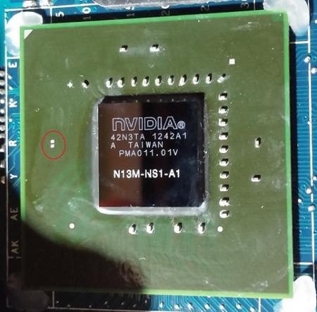

kaberos Posted February 29, 2016 Share Posted February 29, 2016 Hello, I changed the thermal paste on my e6430 and I accidentally damaged (it's lost now) one SMD part of the GPU. Does anyone know what the component is (capacitor/resistor/something else) and what is its value? I know I'm an idiot. :/ Quote Link to comment Share on other sites More sharing options...
Khenglish Posted March 1, 2016 Share Posted March 1, 2016 @kaberos That will be a capacitor. It is very unlikely that you will notice a difference with it missing. Quote Link to comment Share on other sites More sharing options...
kaberos Posted March 3, 2016 Share Posted March 3, 2016 On 1. 3. 2016 at 2:00 AM, Khenglish said: a capacitor. It is very unlikely that you will notice a difference with it missing. Yes, there is difference with it missing. Whole dGPU is not working, so any digital video output is not working, even in dock. Quote Link to comment Share on other sites More sharing options...
Khenglish Posted March 3, 2016 Share Posted March 3, 2016 Wow ok, I'll check mine for you then. It might be a few days before I get to it though. Quote Link to comment Share on other sites More sharing options...
timohour Posted March 4, 2016 Author Share Posted March 4, 2016 (edited) measured mine and showed .980 It is probably 1 KΩ VGA is directly connected to your iGPU both on the laptop and the dock. So it would probably work. Edited March 4, 2016 by timohour Quote Link to comment Share on other sites More sharing options...
kaberos Posted March 4, 2016 Share Posted March 4, 2016 Thank you! Yes, VGA works, but neither of the monitors which I am using has no VGA input. Quote Link to comment Share on other sites More sharing options...
Khenglish Posted March 5, 2016 Share Posted March 5, 2016 On 2/29/2016 at 3:38 PM, kaberos said: Hello, I changed the thermal paste on my e6430 and I accidentally damaged (it's lost now) one SMD part of the GPU. Does anyone know what the component is (capacitor/resistor/something else) and what is its value? I know I'm an idiot. :/ So I just checked mine and that is the only resistor on the entire package, and thus the only required component. The resistance is 40k. Quote Link to comment Share on other sites More sharing options...
kaberos Posted March 6, 2016 Share Posted March 6, 2016 18 hours ago, Khenglish said: So I just checked mine and that is the only resistor on the entire package, and thus the only required component. The resistance is 40k. Well i am quite confused. Timohour said 1K, you said 40K. That's little bit different value. Thank You anyway. Quote Link to comment Share on other sites More sharing options...
timohour Posted March 6, 2016 Author Share Posted March 6, 2016 7 hours ago, kaberos said: Well i am quite confused. Timohour said 1K, you said 40K. That's little bit different value. Thank You anyway. I may have done something wrong. I will try tomorrow to measure it again but I suggest you go with what Khenglish suggested. Quote Link to comment Share on other sites More sharing options...
Khenglish Posted March 6, 2016 Share Posted March 6, 2016 10 minutes ago, timohour said: I may have done something wrong. I will try tomorrow to measure it again but I suggest you go with what Khenglish suggested. I measured it with the core removed, so there is nothing on the motherboard that can be altering the value. It turns out I don't have a stencil for gf108/gf117/gk107 chips so there will be some delay before redoing the gf117 core. 4850m -> 4890 core is taking precidence at this time and is well underway. 1 Quote Link to comment Share on other sites More sharing options...

kaberos Posted March 14, 2016 Share Posted March 14, 2016 On 6. 3. 2016 at 11:58 PM, Khenglish said: I measured it with the core removed, so there is nothing on the motherboard that can be altering the value. It turns out I don't have a stencil for gf108/gf117/gk107 chips so there will be some delay before redoing the gf117 core. 4850m -> 4890 core is taking precidence at this time and is well underway. 40K resistor was right one. With 1K resistor, notebook was detecting GT620M, with .960 resistor notebook was detecting some Nvidia Tesla model, without resistor, notebook was detecting some audio device. Quote Link to comment Share on other sites More sharing options...
