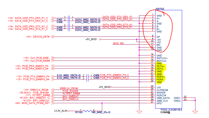

Making the custom hardware is the smaller problem, port 4 is the big deal. Maybe Dell could enlighten us regarding this part...
I don't think that anybody would care. The only way is if we find this out ourselves.
I have checked through the schematics  pg. 29 (a few months ago) but haven't found anything that would give an answer, so I gave up.BKSMwVm.png
This is a ss from pg 29 where you can see the JSATA2 connector. As I have commented a while ago, this is a double sided sata odd connector. On one side is a normal sata (inside the red "circle") and the other is a unique pcie connector. The pins that I highlighted are those needed for the PCIe connection (either x2 using EC or x4 using the above mentioned). I you read the thread from the beginning there was a discussion on this matter. @sskillz also detached his JSATA 2 connector but we had no luck enabling these PCIe lanes. The answer is probably inside this P5MKF usb 3.0 bay. But I never got my hands on it. Since this was a computer I bought to use @ work I couldn't justify the extra cost on it.

Probably you are going to be able to use some, but definetely not all. AFAIK the pad-disance is the same but you need to modify the mini pcie card in order to fit it in there so you may loose some pins. I can't recall though which pins were accessible and which weren't.
Regarding your previous post, I wouldn't agree more but I need to see it in order to believe it. The connections are there for sure, but I can't testify that it is port 4.
EDIT: OK found an old photo. you are maybe loosing pins 14 and 25 and maybe 26. Seems like the rest are accessible. Can't say for sure though.
But why would you need other signals. They are not needed for x2 or x4.

1 minute ago, kondilac said:
Thanks. Since i know the dimensions and pad distance of the MPCIE i can use them to create a little PCB that i can use to experiment. This is the next thing on my todo list after finishing my docking-pod, which is near :)
Ok, keep in mind that I never actually measured it. What I said is supported only by my observations when I tried to enable port 4. It may be slightly different. You can also measure your odd connector in order to find the exact external dimensions. Keep us posted.
