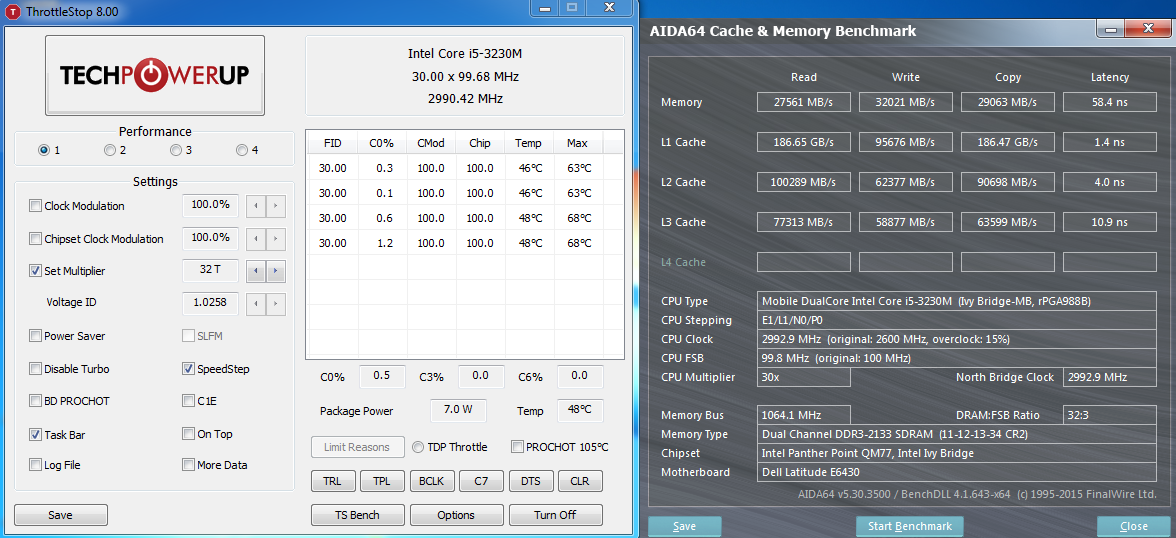

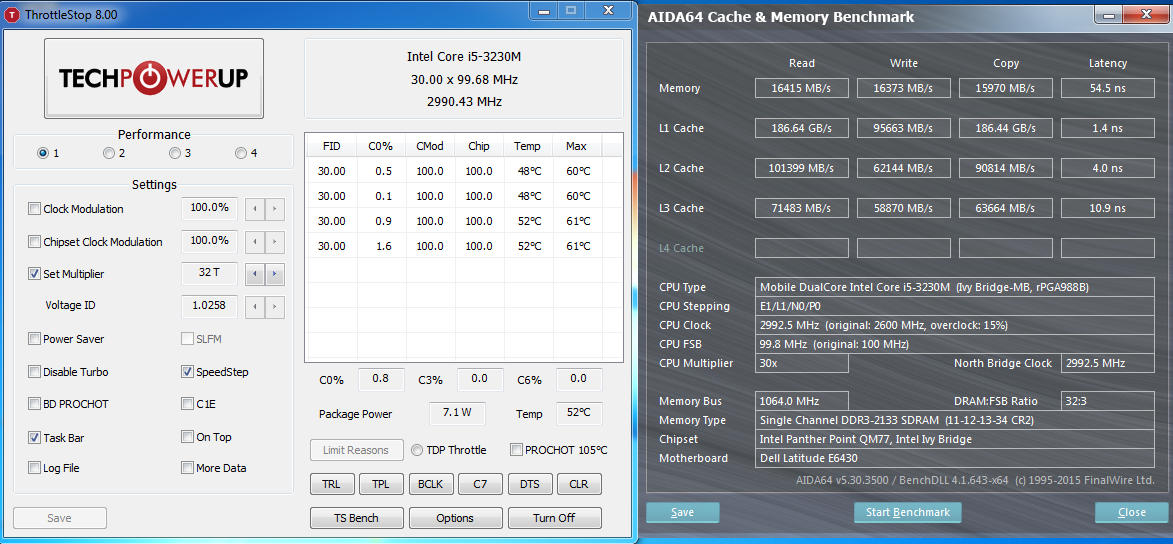

... You could run an AIDA test to confirm but I believe that your CL11 2T is faster than my CL12 1T. A bunch of performace results here.
Single and dual channel benches @ 2133 CL11 CR2
Also it turns out that after a shutdown, there is no problem booting up, but restarting causes black screen, and problems even when trying to coldstart. iGPU has no artifacts, and everything is fine once i can get it to boot.

I successfully upgraded the SB i3, to an IB i5-3230M for 15$. Since my HyperX 2133Mhz kit is already migrated to the Dell, the first boot revealed that the memory controller of the i5 cant cope with the PnP (JEDEC) 2133Mhz @CL11. I locked the memory speed down to 1600Mhz CL11 , replacing one of the kingstons with a samsung module, just to be able to check the new CPU is working properly. Yes it does, and a little bit of TSBench revealed that it does outperform my Haswell-ULV on the same clock not only with lower power consumption (15.1W thanks to the Haswells IVR and integrated PCH VS 10.9W) but a 32M TSBench completes almost a second faster. The Haswell system has a very lean w8.1 x64 install, and the Ivy has a bloated w7 x64. (no throttling occurs, both cpus are running @2.4Ghz during the whole bench)
The other thing which makes me very happy that when C-states are disabled in the bios, i can still toggle C1E using Throttlestop for the Battery profile(I was able to do the same on 1st gen. Core i anno, but unable to do it with 4th.gen.), and although it does not enable C3, C6 and C7, but still has a substantial impact in idle power consumption (3.1W vs 7.1W). And the advantages of disabled C states in my usage scenario is huge, so the ~+1W power consumption when idling is a fair trade-off for me.(This i5 idles around 2.5W with all C states enabled, although i have not tinkered with the settings so far to see if this can be reduced)
The next thing on my list is finding the limit of the memory controller, but i'll have to dig into the topic deeper... My kit is a Kingston HX321LS11IB2K2/16, if anybody with the same kit would share their settings that would be great.

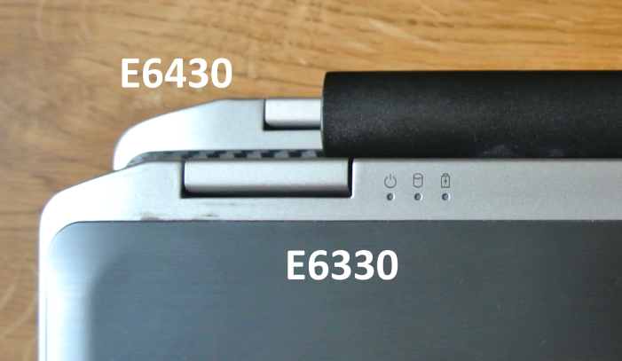

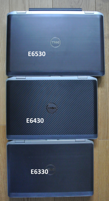

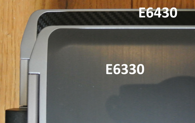

Sure, I did a small comparison, since I have the complete E6X30 series at home smile.png
The E6430 still fits in my favourite bag, as the E6330 did. Especially if you have the large battery in the E6330, it's deeper than the E6430 with the regular battery. The E6430 is about 1.7cm wider.
This are the specs:
  • E6330, iGPU model, 65Wh battery
  • E6430, iGPU model, 60Wh battery
  • E6530, dGPU model, 97Wh battery
1) I've put them on a body scale (bad precision):
  • E6330: 2.0kg
  • E6430: 2.4kg
  • E6530: 3.0kg
2) Pictures:
I really like that carbon-effect foil on the e6430. DIY?
It's at least 2nd hand... but it looks very professional. I guess it's no factory option, since I didn't find anything on the part list.
Perhaps the cover was scratched and the seller applied it to increase the value.
I'm still trying to decrease the battery wear with training, but nevertheless it's not yet time to replace the battery (~25-30%). In conrast my E6330's battery is almost in mint condition (0,1% wear). It was in a good shape when I got it last year and I turned off Express Charge...
