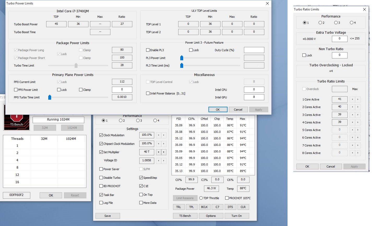

Oh well, thanks @timohour for your help, but it doesn't work. 4c bench keeps always max 44W and the results are the same. Should I do something other than this?
try to enable Intel Power Balance set CPU 31 and GPU 0.
Nothing
It won't go over 45W no matter what? Not even for a short time?
Yes, max 45W, and I don't think is a faulty PSU.

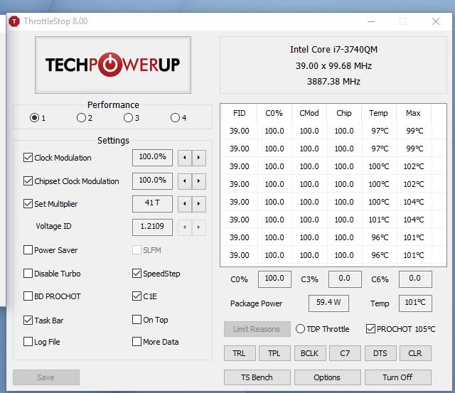

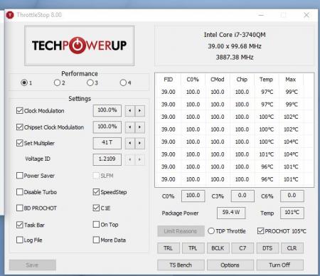

UPDATE: It WAS a faulty PSU. Tried with another: it keeps 4c x39 rock solid for some seconds (until 105°). Yeah for us :)
And now this:
http://www.ebay.it/itm/Alluminio-Dissipatore-Aluminum-Heat-Sink-For-Compute-Led-Power-IC-Transistor-New-/231643140574?hash=item35ef01d1de:g:L-0AAOSwMmBVweAH
Nothing
[ATTACH=CONFIG]16305[/ATTACH]
Nice!!!
It shouldn't go up that fast though... Do you have the bottom lid closed?
Cause mine @3.98GHz with Prime95 after 6 minutes of full load with open bottom lid temperature wouldn't cross 95°C...
UPDATE: If this is with TSBench seems like your chip is not very good thermally. You can see here that my 3720QM @ 3.8GHz is ~ 50W @1.2109V. 59.4W is almost 10W more at the same voltage!

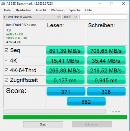

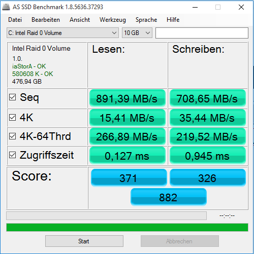

Here, an little benchmark of my two PM830post-34661-14495001112464_thumb.png.
Normally, we can now create a RAID0 array...
Here, an little benchmark of my two PM830[ATTACH=CONFIG]16467[/ATTACH].
impressive!!! I have been dreaming for a while for such a setup... It can be costly though..

Nothing

Finally, i reached "adult" status on this board, and now i can post by myself :).
I successfully upgraded the SB i3, to an IB i5-3230M for 15$. Since my HyperX 2133Mhz kit is already migrated to the Dell, the first boot revealed that the memory controller of the i5 cant cope with the PnP (JEDEC) 2133Mhz @CL11. I locked the memory speed down to 1600Mhz CL11 , replacing one of the kingstons with a samsung module, just to be able to check the new CPU is working properly. Yes it does, and a little bit of TSBench revealed that it does outperform my Haswell-ULV on the same clock not only with lower power consumption (15.1W thanks to the Haswells IVR and integrated PCH VS 10.9W) but a 32M TSBench completes almost a second faster. The Haswell system has a very lean w8.1 x64 install, and the Ivy has a bloated w7 x64. (no throttling occurs, both cpus are running @2.4Ghz during the whole bench)
The other thing which makes me very happy that when C-states are disabled in the bios, i can still toggle C1E using Throttlestop for the Battery profile(I was able to do the same on 1st gen. Core i anno, but unable to do it with 4th.gen.), and although it does not enable C3, C6 and C7, but still has a substantial impact in idle power consumption (3.1W vs 7.1W). And the advantages of disabled C states in my usage scenario is huge, so the ~+1W power consumption when idling is a fair trade-off for me.(This i5 idles around 2.5W with all C states enabled, although i have not tinkered with the settings so far to see if this can be reduced)......

Could you help me with something? Could you test if your i5-3230M has any unlocked multipliers? It is confirmed that i7-37x0QM and i7-38xQM have 4 unlocked multipliers, meaning that the maximum 4C turbo for an 3720QM is x38 opposed to default x34.
The maximum multiplier on your i5 is x32. Could you use the UEFI variables to set your 1-Core Ratio Limit it something a little over x32 (let's say x33) and check if it has any impact on your maximum multiplier reported with Throttlestop? It would be great if dual core i5-32x0Ms or i5-33x0Ms have some unlocked multipliers. If the same rule applies an i5-3380M would go up to 3.8GHz 2C and 4GHz 1C...
Also, if you have some time. It would be helpful to investigate if we can OC the iGPU on an i5. You can check here how it worked with the i7. I tested with my i3 and it was a no go. Let's find out if it works with the i5s
