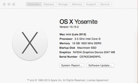

Finally, I made it! Mac Mini 2012 + Evga GTX 960 on OS X 10.10.2 and Windows 8.1 EFI working flawless smooth, except GPU's coil whine noise on max load..

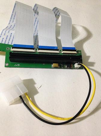

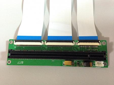

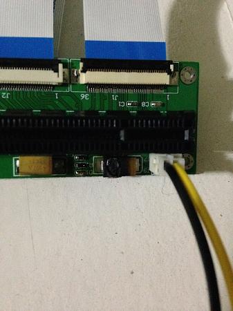

3. Try to avoid powered risers. They could not properly power your AKiTiO. To make sure that your AKiTiO is properly powered, go to Apple logo -> About This Mac -> System Report -> Thunderbolt, if you don't see here AKiTiO then your power riser isn't powered your AKiTiO as it should.
Some power risers could be defected from the box. And they could burn your GPU if your PSU don't have Circuit protection. For example, my Sintech Riser was defected. Use Barrel to Molex instead riser power.

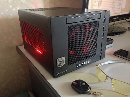

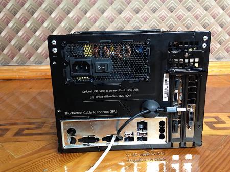

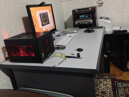

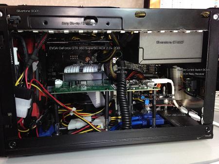

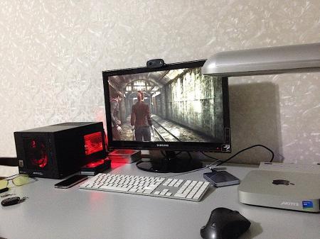

My eGPU built photos with the Silverstone SG05 case:

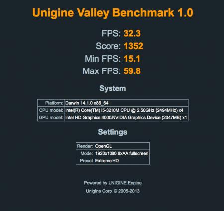

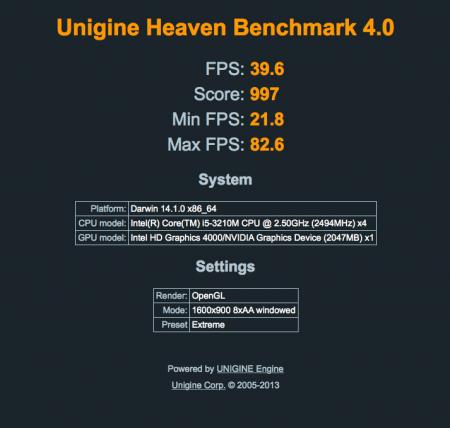

OS X Screenshots:

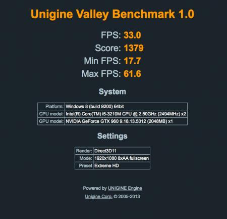

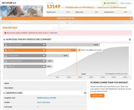

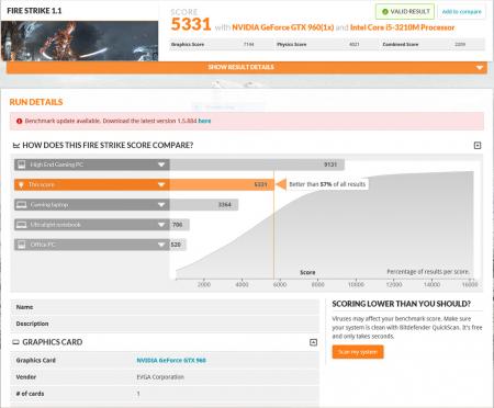

3dmark results screencaps in spoiler
3dmark13-FS.gpu=7144
more photos available on my Google Drive
