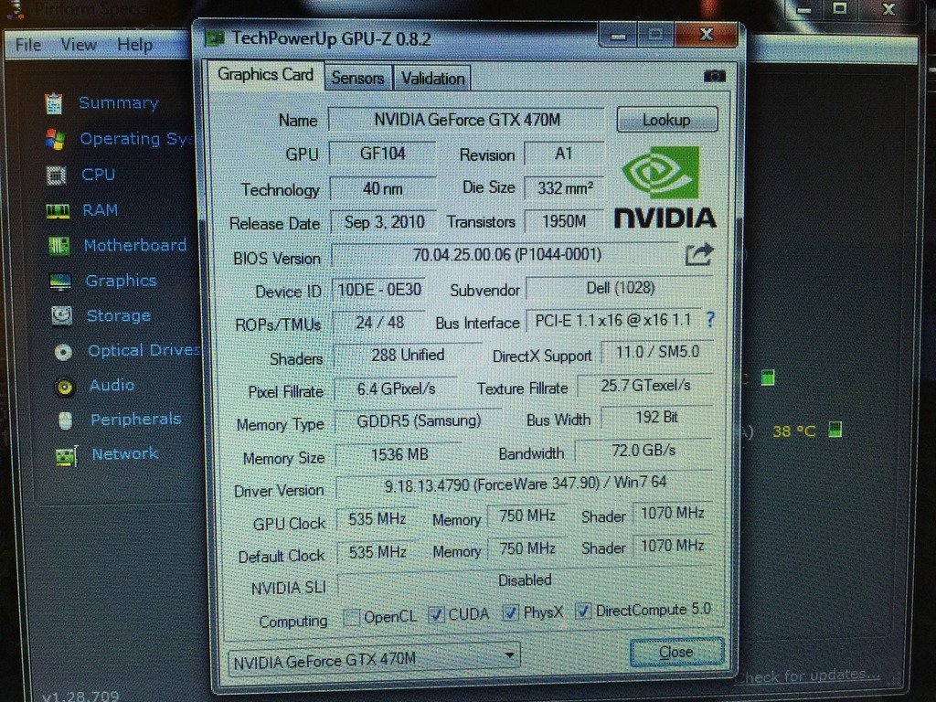

so yesterday i traded my Xbox one (i actually bought it for 99 cents last year) for a co workers Alienware m15x, its got the core i7 820qm, 8gb ram, no hard drive (i threw a 500gb sshd in and imaged it) it had a gt 240m (i put a gtx 470m in it). the laptop is kinda beat up and will need a new bottom (like $15 on eBay) but i got the gtx 470m and the laptop for my xbox one so i dont think it was a bad deal.

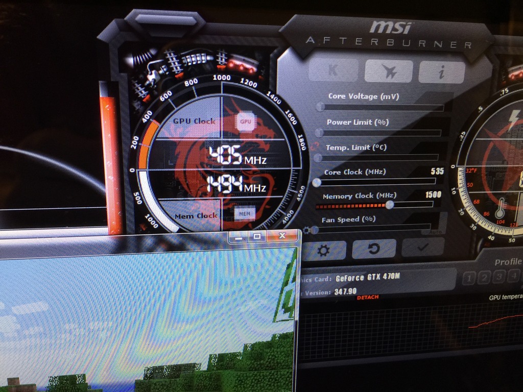

i installed the gtx 470m yesterday and it wasnt taking the card so i created a DOS bootable thumb drive and upgraded the bios. And presto she fired right up. i couldnt find the drivers for the card anywhere and the nvidia ones wouldnt work, so i used one of those driver utilities to find the drivers (the program seemed sketchy but it worked). so now i have the right drivers and everything however the card is running really slow, 50mhz clock speed, 135mhz memory clock.
so thats where im at, im currently moving so i will wait on ordering the parts but i plan to get all new casing and a new keyboard. i tried msi afterburner and i cant adjust the clock speed on the card at all so im considering selling the gtx 470m since dell doesnt support it and getting a gtx 460m.

do you know about stealth mode??? try that i think thats the problem.
I haven't heard of stealth mode, by the name I'm guessing it favors battery life over performance and underclocks everything? I'll look into it tonight but when I tested it last night it was running really good and ran every game I had downloaded at max settings.

Alright, well that's good to hear. I didn't have stealth mode on, but ever since I flashed the vbios I haven't had a problem with it. I'm surprised at how cool it's running now aswell.
It seem to run stable (no blue screens or other issues/errors). So I'm gonna call it good, thanks for all your help.
The GTX460M has native support for dell drivers.
The gtx470m was not supported at that time. Good to know that it works. :)
