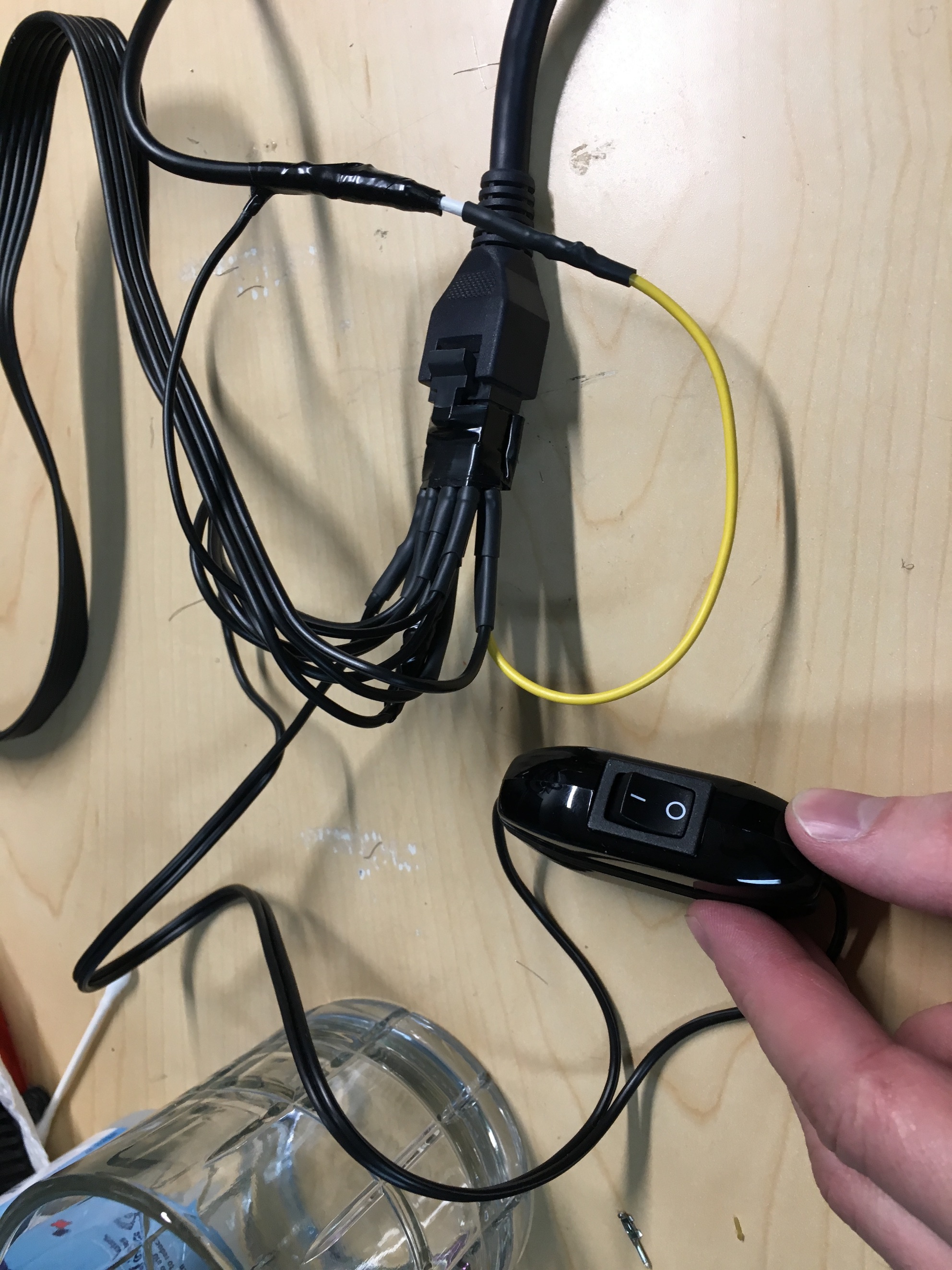

36 minutes ago, n8ballz said:
Instead of the paperclip I used a switch. It turns everything off or on.
Thanks. I wanted to avoid messing w/ any wiring, but is this easy to do? Any soldering necessary?
