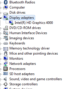

kman4you Posted March 20, 2015 Author Share Posted March 20, 2015 yes my laptop boot in windows but device manager only shows the intel HD4000 graphics and dont recognize 580m Quote Link to comment Share on other sites More sharing options...
kman4you Posted March 21, 2015 Author Share Posted March 21, 2015 @Klem brother, my laptop boot in windows but no 580m is available. as you can see Quote Link to comment Share on other sites More sharing options...

Khenglish Posted March 21, 2015 Share Posted March 21, 2015 yes my laptop boot in windows but device manager only shows the intel HD4000 graphics and dont recognize 580mThis is normal. The card will not appear until you install a driver. You will have to .inf mod the driver to get it to install. See how to here: http://forum.techinferno.com/nvidia/5249-%5Bguide%5D-modding-nvidia-oem-inf-files.html Quote Link to comment Share on other sites More sharing options...
kman4you Posted March 21, 2015 Author Share Posted March 21, 2015 @Khenglish i've done the same but at the point (Device manager -> Display Adapters ->) i only see intel HD4000 graphics.no nvidia gtx 580m is shown there. Quote Link to comment Share on other sites More sharing options...

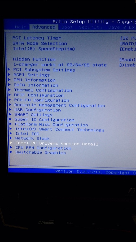

kman4you Posted March 22, 2015 Author Share Posted March 22, 2015 @Klem how can i control fanspeed in BIOS. I didn't find any option to control fan speed,because discrete graphic card is missing ,my nb fan is running on full,i am using unlocked bios made by Xonar.link <http://forum.techinferno.com/msi/1839-msi-g-series-unlocked-bios.html> . there are alot of options and i am not messing with any option because i am new to BIOS stuff Quote Link to comment Share on other sites More sharing options...
kman4you Posted March 22, 2015 Author Share Posted March 22, 2015 @Klem these are the options of my nb BIOS Quote Link to comment Share on other sites More sharing options...
Bios Modder Klem Posted March 22, 2015 Bios Modder Share Posted March 22, 2015 @Klem how can i control fanspeed in BIOS. I didn't find any option to control fan speed,because discrete graphic card is missing ,my nb fan is running on full,i am using unlocked bios made by Xonar.link <http: forum.techinferno.com="" msi="" 1839-msi-g-series-unlocked-bios.html=""> . there are alot of options and i am not messing with any option because i am new to BIOS stuffWithout discrete graphic card in this model of laptop, fan will run at full speed. It is normal, and this you cant solve. Unlock or mod bios does not solve this issue, and you need connect discrete graphic card.</http:> Quote Link to comment Share on other sites More sharing options...
