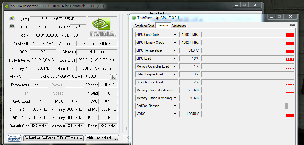

ironer1 Posted February 24, 2015 Author Share Posted February 24, 2015 So after the clean and re-pasting thermal helped me but i see another strange thing. Gpu-Z and Nvidiainspectior, Memory clock is seems different. wht should i have to belive? Quote Link to comment Share on other sites More sharing options...
octiceps Posted February 24, 2015 Share Posted February 24, 2015 So after the clean and re-pasting thermal helped me but i see another strange thing.Gpu-Z and Nvidiainspectior, Memory clock is seems different. wht should i have to belive?[ATTACH=CONFIG]14182[/ATTACH]Both are correct. GPU-Z sensor shows actual memory frequency, Inspector doubles it because DDR (double data rate). Quote Link to comment Share on other sites More sharing options...
