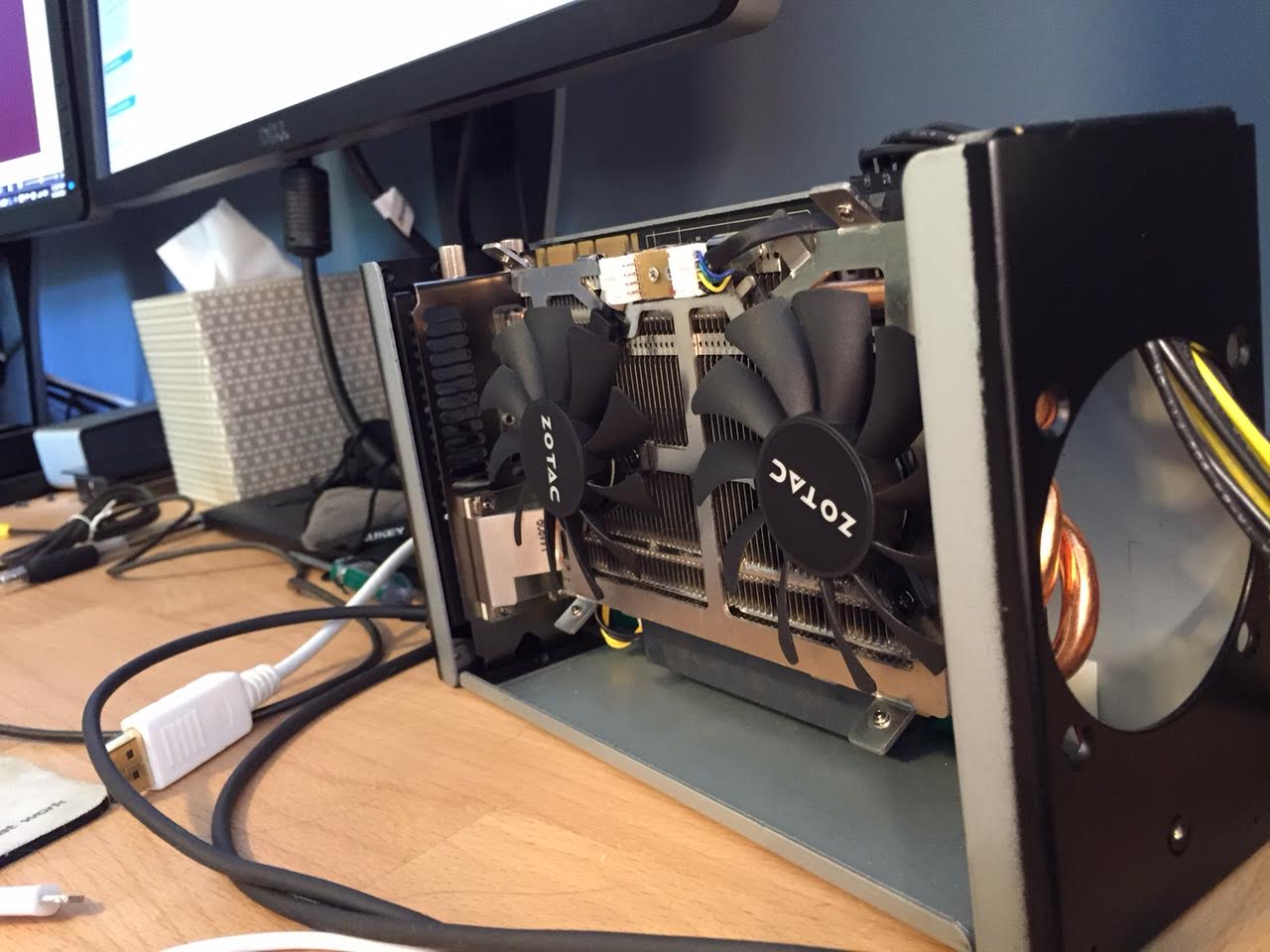

giordy Posted January 20, 2015 Share Posted January 20, 2015 Hello guys, new user here! I stumbled upon your forum a while ago while trying to find a way to upgrade my retina macbook pro graphics card in order to be able to run my Oculus Rift DK2 at a decent frame rate. After reading your guides I went ahead and bought the following: 1) Akitio Box 2) Corsair RM450 power supply 3) Zotac GTX970 (outer shell removed) I also put together a Molex -> barrel adapter to power everything up, next mod I'm going to do is to dremel out a hole for the epci connectors so that I can close the box up. After modifying the kext files, changing the boot parameters and downloading the Nvidia drivers I was able to get the card recognized under Yosemite but I'm the initial benchmarks that i ran with xbench with the rift attached don't show much improvement. EDIT: I tried a couple of tests with GPUTest and it did go up about 300%...tuscany demo and titans of space now run perfectly at 75fps (they were stuttering badly with the GT650M, so on the Mac side I'm a happy camper!! I'm not really interested in running it under Yosemite because performance of the Rift under Mac kind of suck so I have been trying to get Win8.1 to recognize the card, but so far no luck. Right now I have Win8.1 installed on a USB3 SDD that is configured with UEFI, I also installed refind and set it up as this implementation guide suggests (http://forum.techinferno.com/implementation-guides/2367-%5Bguide%5D-2012-15-macbook-pro-retina-gtx560ti%408gbps-tb1-th05-win8-1-a.html) but whenever I boot with the eGPU connected it either never finishes booting (black screen) or restarts. If I boot into windows without the eGPU attached i see both HD4000 and GT650 recognized but I think the system is always using the GT650...any ideas on how to get this to run properly? Any help is appreciated! I'm considering reinstalling windows in bios mode and use egpu setup , but i am afraid that if I do that I won't be able to boot the external SDD and will have to create a proper bootcamp partition Here are some pics of the rig and what I see under Windows. Thanks, Giordy Quote Link to comment Share on other sites More sharing options...

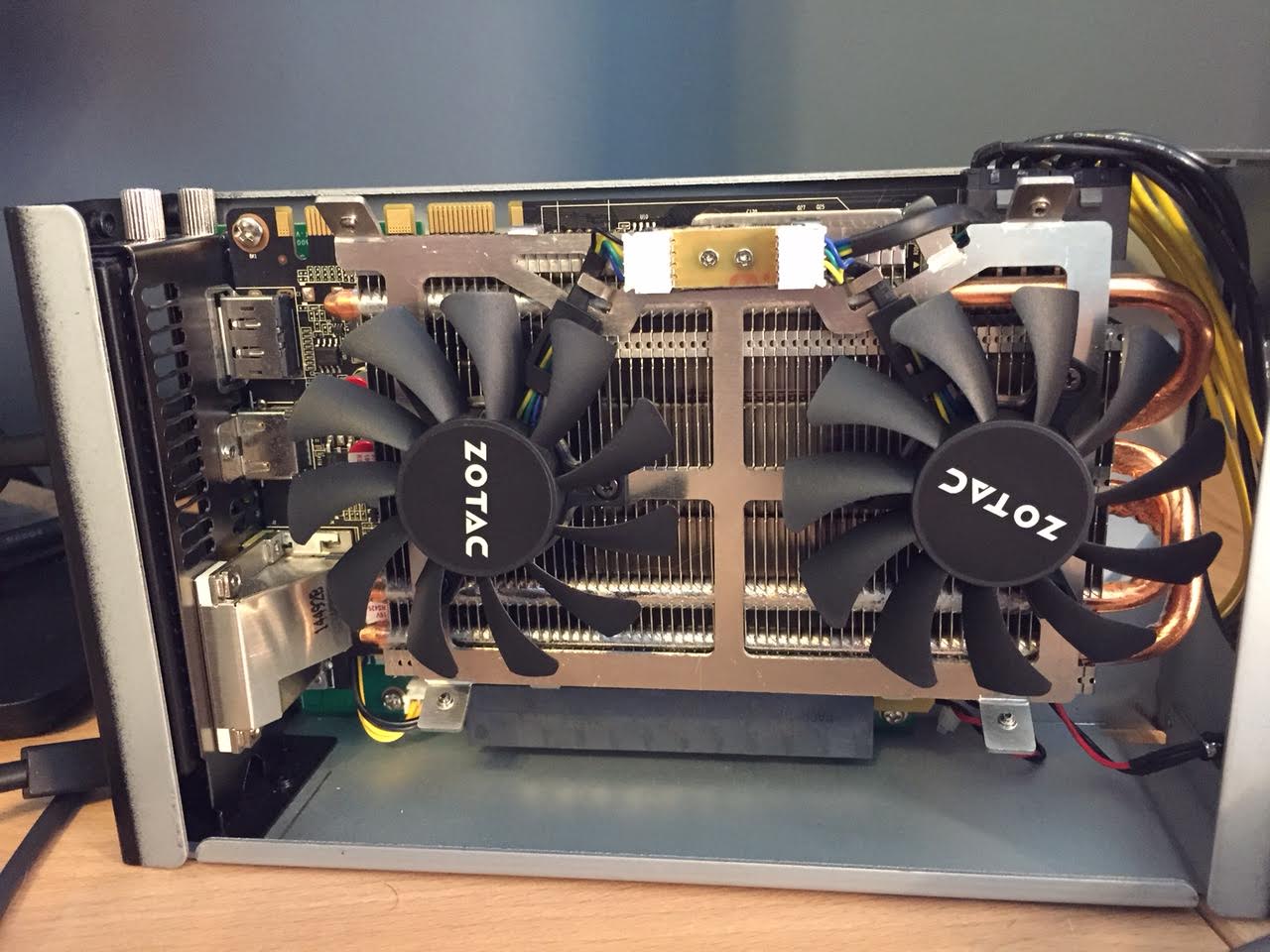

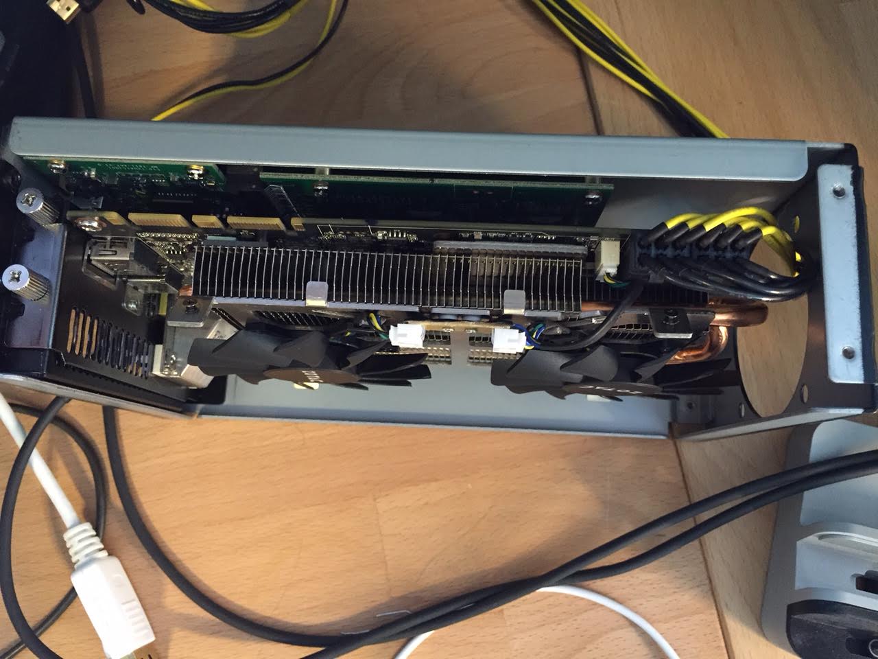

Dschijn Posted April 23, 2015 Share Posted April 23, 2015 @giordy: Could you do me a favour and tell me how much space there is between the GPUs PCIe Powerconnector and the colliding AKiTiO case? Or how much shorter do the PCIe Powerconnectors have to be, to fit inside the case?! Quote Link to comment Share on other sites More sharing options...
giordy Posted April 23, 2015 Author Share Posted April 23, 2015 Hi, there isn't any space, I had to make a hole in the case for it. I also had to mount the fan externally. Quote Link to comment Share on other sites More sharing options...
Dschijn Posted April 23, 2015 Share Posted April 23, 2015 @giordy: Thx, but that wasn't my question. I would like to know: How much space is it from the edge of the PCB of the GPU to the case. Or: How slim would a PCIe plug have to be to fit. @Tech Inferno Fan: Yes, that is sth I was thinking about. Especially with DIY there are even slimmer ways (first and second spoiler): [Guide] How-to Thread für einen abgewinkelten PCIe Stecker Quote Link to comment Share on other sites More sharing options...

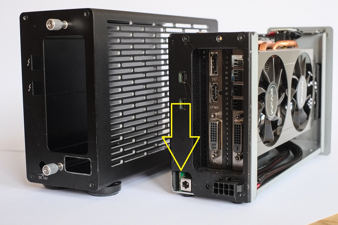

giordy Posted April 23, 2015 Author Share Posted April 23, 2015 the space highlighted by the arrow is about 8 mm long. 2 Quote Link to comment Share on other sites More sharing options...

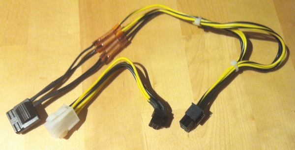

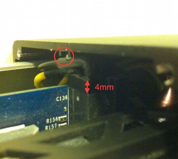

euqlaog Posted April 23, 2015 Share Posted April 23, 2015 It’s very simple to make such a low profile cable by yourself as @jacobsson described: http://forum.techinferno.com/enclosures-adapters/7205-us%24189-akitio-thunder2-pcie-box-16gbps-tb2-38.html#post106447 I used very thin bent “iron wire” for pushing locking wings. Even if the upper part is only 4mm tall, the sharp edges in the middle of the outer shell may cut the cable as you can see, so be careful! FYI, here’s the 8-pin to 4-pin molex cable that I made as well, beside low profile 6-pin cable. I thought that a 6-pin with a single 12V yellow from the ATX PSU may not be capable of feeding 75W for the PCIe slot power. Two thick yellows will do the work absolutely. Quote Link to comment Share on other sites More sharing options...
Dschijn Posted April 25, 2015 Share Posted April 25, 2015 @giordy: Can you please to me one more favour? How much is the distance between the cooling fins (not the fan) to the case at the side. Or, how tall can fans be, if I would like to replace the Zotac fans? Quote Link to comment Share on other sites More sharing options...

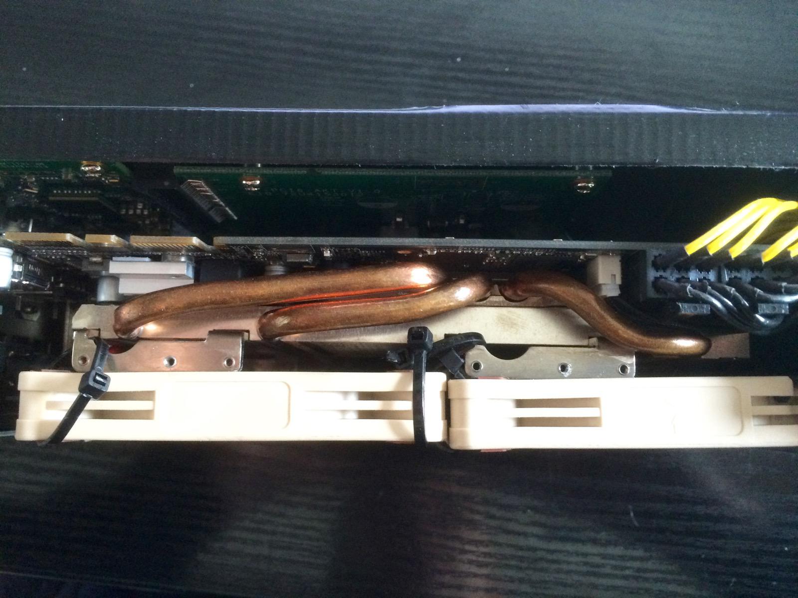

martinm0 Posted June 24, 2015 Share Posted June 24, 2015 @giordy: Can you please to me one more favour? How much is the distance between the cooling fins (not the fan) to the case at the side. Or, how tall can fans be, if I would like to replace the Zotac fans? Since I have my Zotac torn apart, thought I'd answer this question. I'm measuring about 25mm from fins to the edge of the inner chassis. It might be possible to get a normal noctua 92mmx25mm fan in there. Maybe I'll buy the redux model since that's the color I wanted and it should make it flush with the outer case. Note that the Zotac has 5 posts (4 that the fan shroud connects to), so I had to bend those out of the way. UPDATE: So, I lied. Its 20mm from fins to outer case, so standard 25mm fans will not work. I must have been drunk or optimistic. Take your pick. 1 Quote Link to comment Share on other sites More sharing options...
Dschijn Posted June 24, 2015 Share Posted June 24, 2015 Thank martinm0! My Galaxy GTX 970 has similiar posts/pins on the cooler to attach the shroud. Using 25mm thick fans would increase cooling perfrormance a lot, since they can move much more air as the 15mm thin fans. Quote Link to comment Share on other sites More sharing options...
martinm0 Posted June 24, 2015 Share Posted June 24, 2015 I will pick up some new standard fans and see how they fit. The thinner Noctuas I was able to wedge into the bent out brackets so I don't think I need to use anything to affix them in place. But I'm still waiting on the PWM splitter cable, which will take a while to get to the US from Hong Kong, so I won't have much for updates until late next week or even latter. I also ordered 2x 60mm x 60mm x 10mm fans to see if I can fit something either in place of the Akitio fan, or on the opposite side as giordy did (nice to see we think alike!). Now I just have to convince my friend with the CNC machine that I DON'T need liquid cooling and get him to cut some holes in the outer case for me. Quote Link to comment Share on other sites More sharing options...
martinm0 Posted June 25, 2015 Share Posted June 25, 2015 So, I lied. Its 20mm from fins to outer case, so standard 25mm fans will not work. I must have been drunk or optimistic. Take your pick. Quote Link to comment Share on other sites More sharing options...

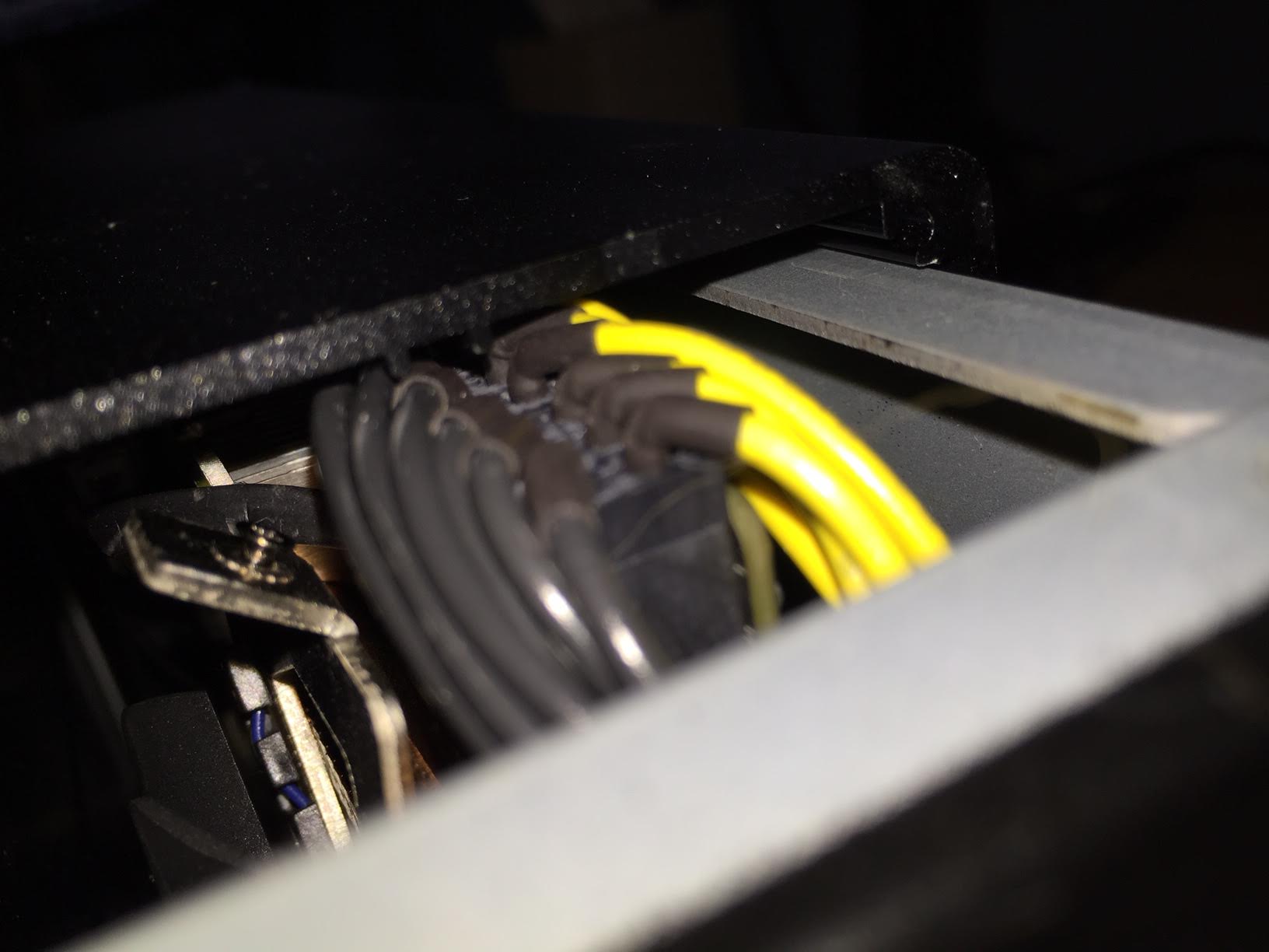

Kerri Posted July 14, 2017 Share Posted July 14, 2017 I found this cable at an online store called KareonKables.Com. This cable worked with my Thunder2 case. The connector on this cable sticks out of the GPU 11mm and I was able to close the case after routing the cable through the bottom corner of the back site of the case, where the 12v jack leaves and opening. Quote Link to comment Share on other sites More sharing options...
