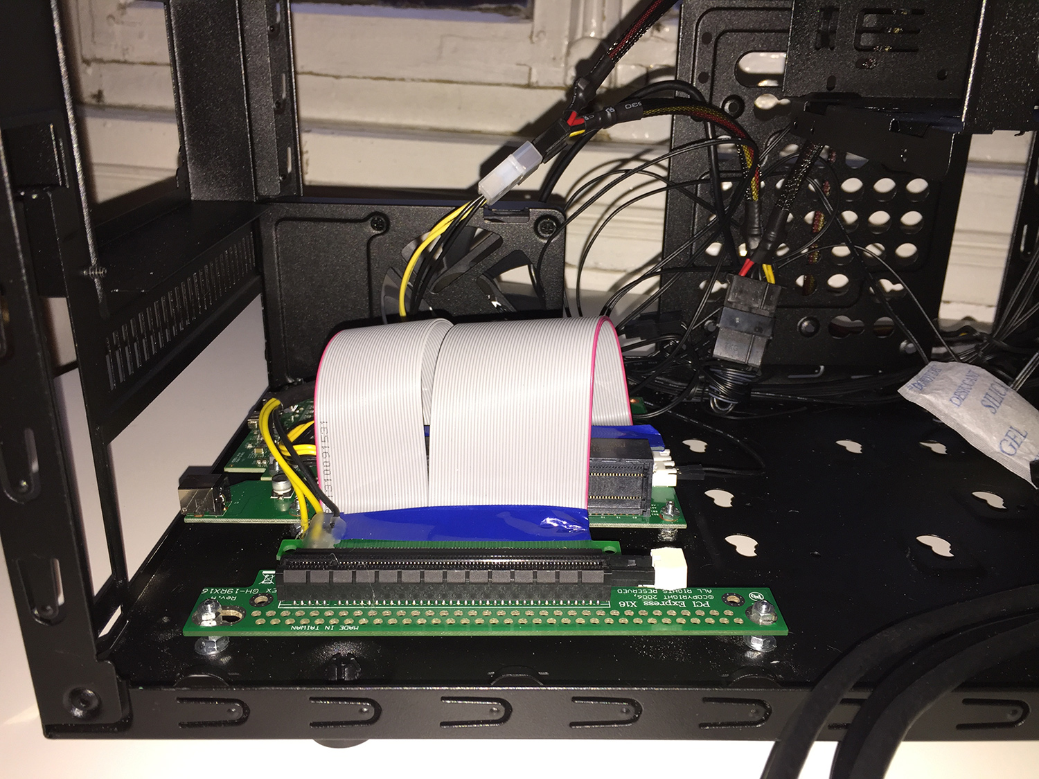

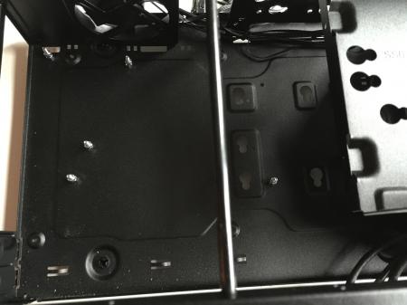

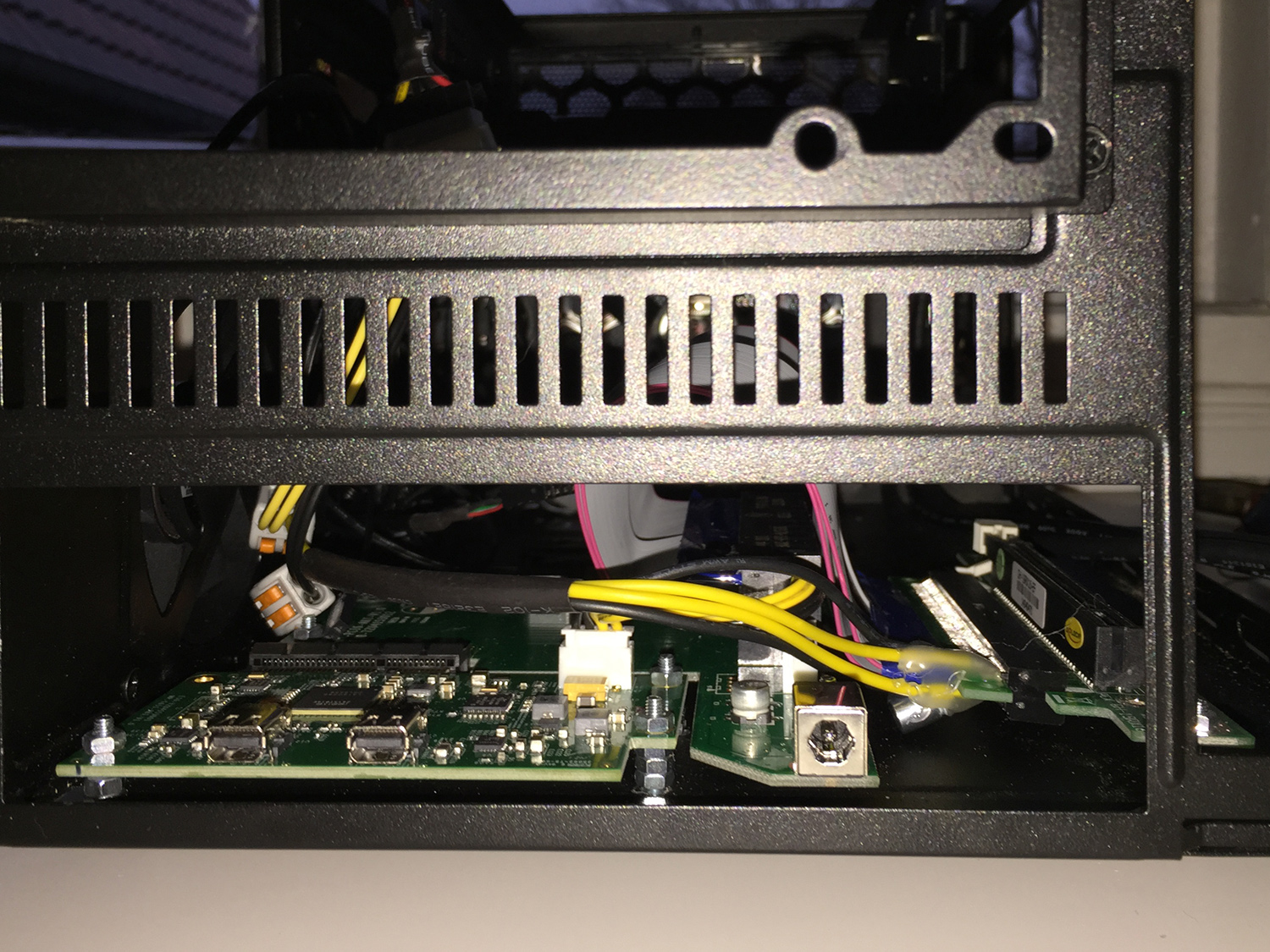

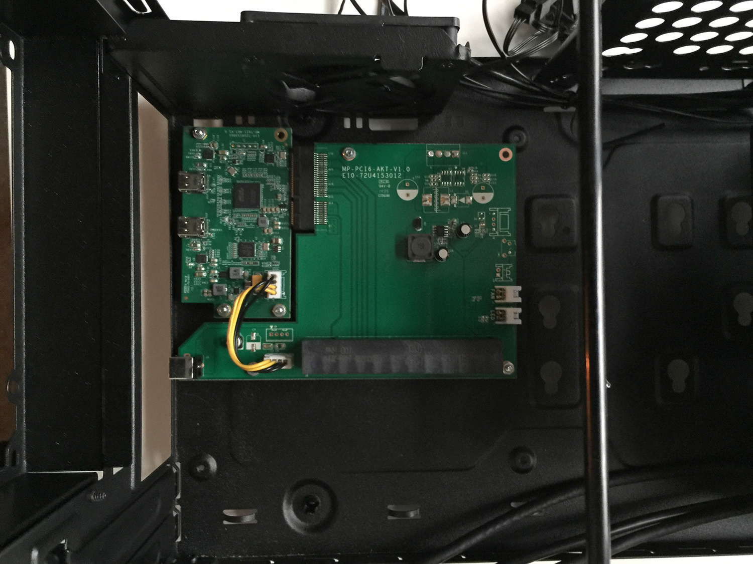

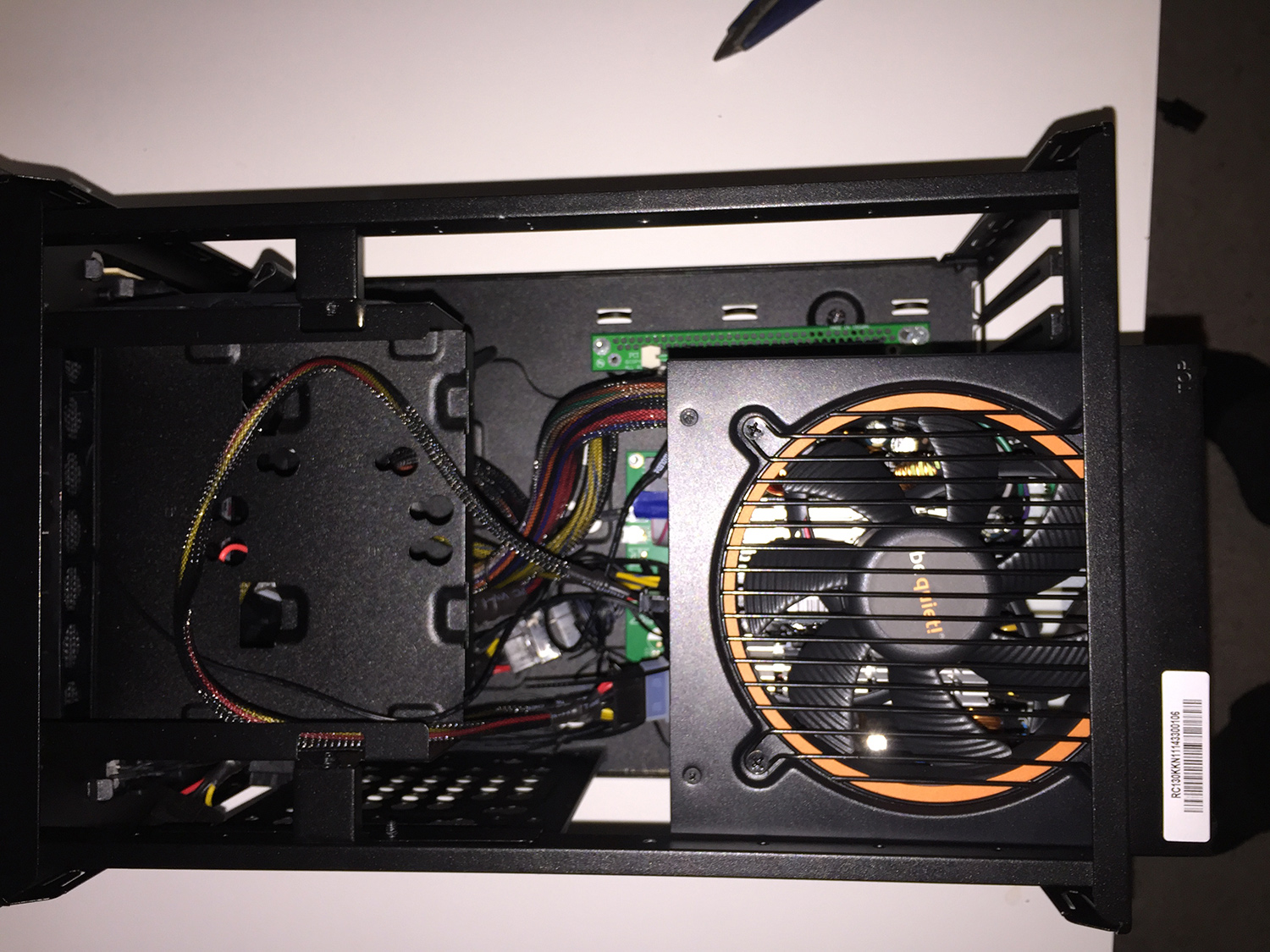

PEPARING THE CASE:

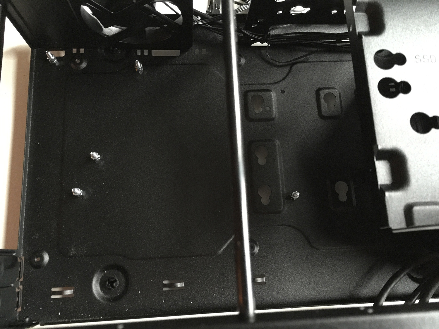

1. I removed everything out of the Akitio Case and used the Akitio-Hardware to mark inside of the Elite 130 where I have to drill new holes. I used screws with nuts as spacer (that way I was more flexible in adjusting it).
2. does it fit? yes...

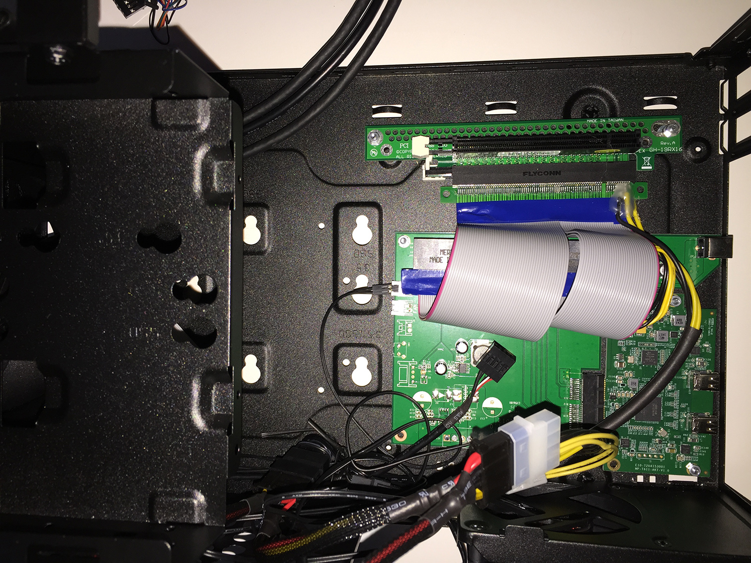

3. I've done the same with the Riser Card, used a graphics card to get the correct position - then I connected the riser card by using the riser cable with the Akitio. Also I connected the Molex with the power cable of the PSU.

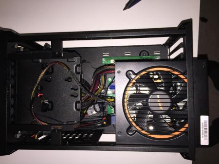

4. ...of course we need the PSU itself also in the case

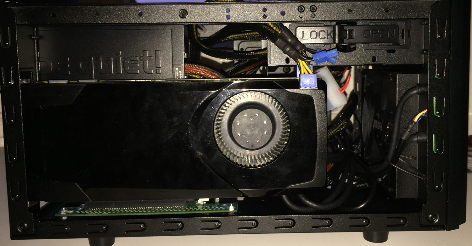

5. lets get in the GTX680

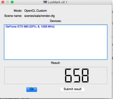

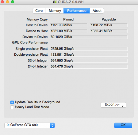

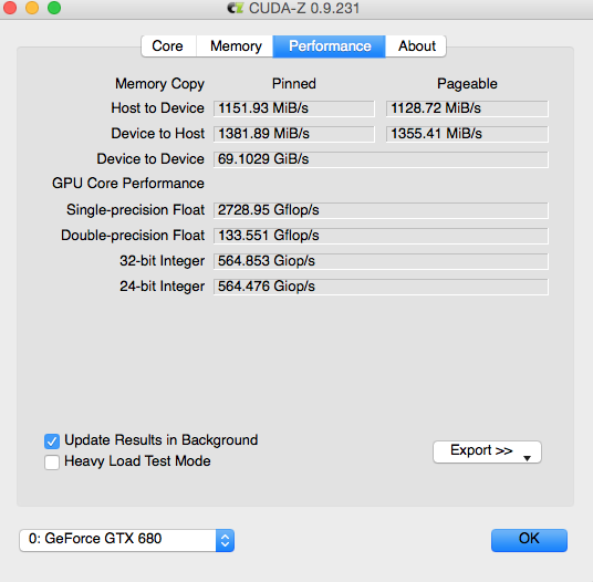

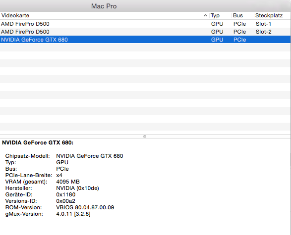

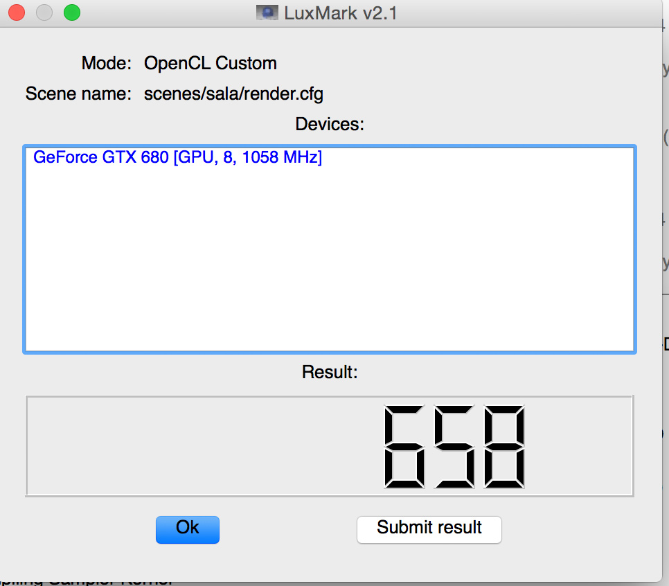

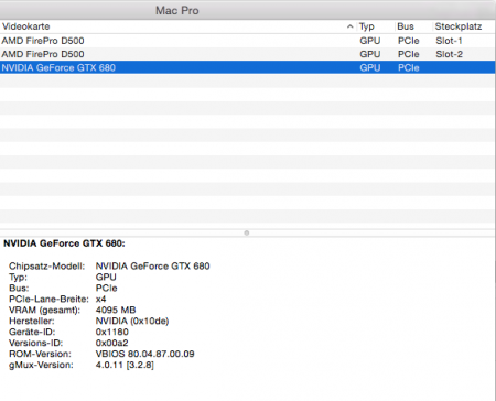

SYSTEM PROFILER , LUXMARK, CUDA-Z:
When rendering the eGPU uses about 180-200 Watts, so far it runs pretty solid.

As you have GTX680 correctly named under system report, I believe all the necessary kexts are loaded. I don’t know what display interface your monitor is connected, but you can try other cables and connectors as well. MVC says “GTX680 4GB cards lost upper DVI port after 10.9.2.”
