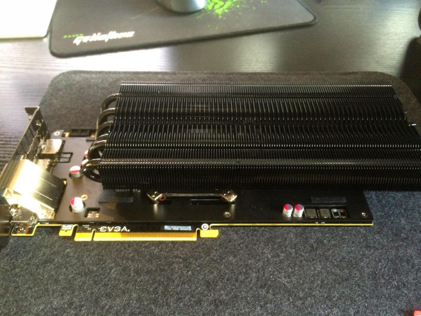

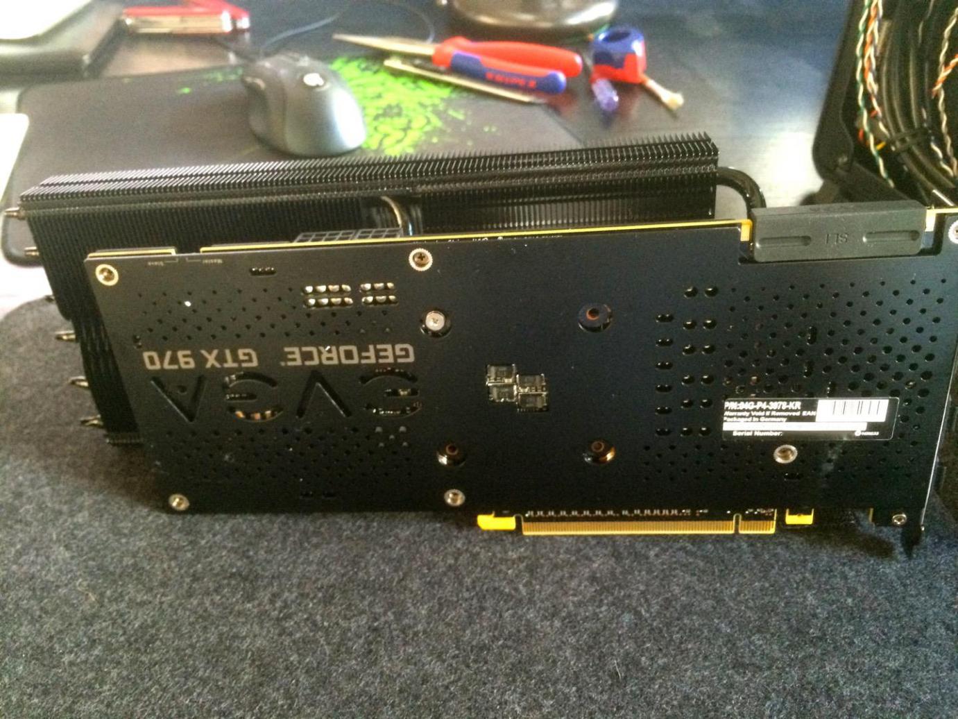

Dschijn Posted February 14, 2015 Author Share Posted February 14, 2015 Changed the cooler on my GTX 970. Now cooled directly with two Noctua NF-F12 industrial (2000 PWM) with fresh air (the case fans). Cooler: RAIJINTEK Morpheus Black Load fans @ 1700rpm: 43-44°C fans @ 1300rpm: 45°C fans @ 1100rpm: 47°C fans @ 650rpm: 55°C Idle fans @ 0rpm: 40°C (after load) Quote Link to comment Share on other sites More sharing options...
