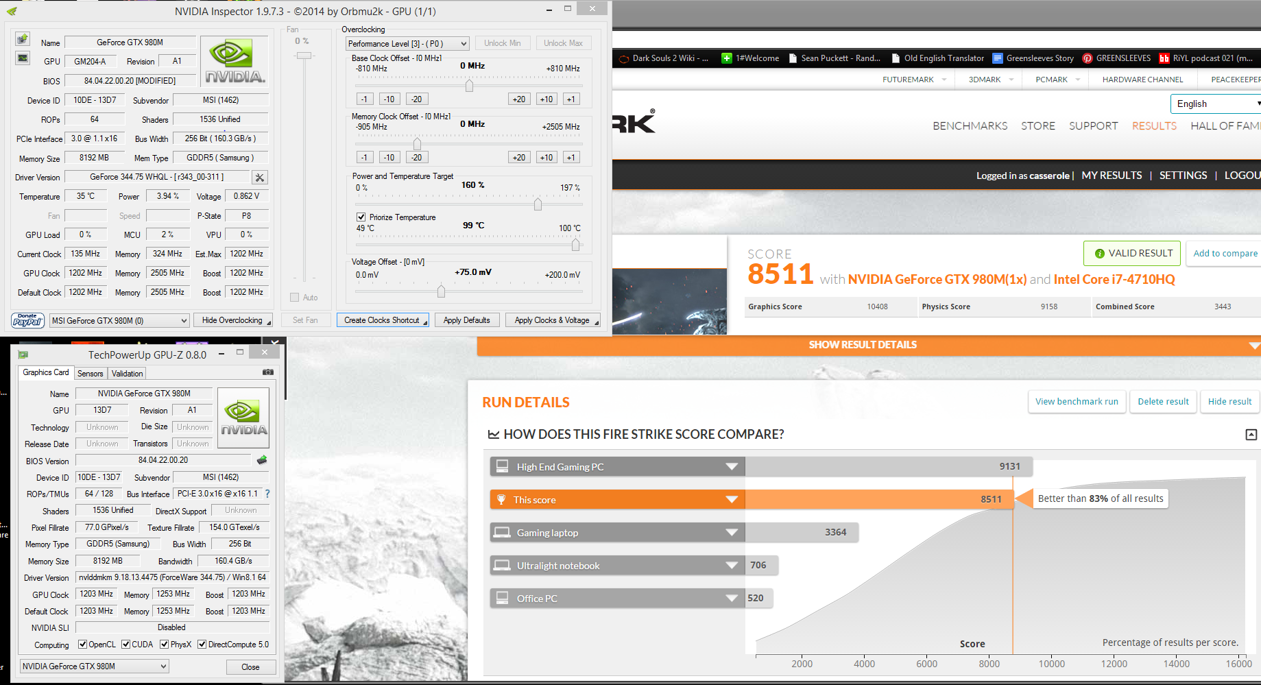

OK so Here's a screenshot - this is running the new vbios with voltage and power target increased. I'm getting a lower score than before in 3DMark FireStrike - with stock I managed well over 9000. If I try to increase the core or memory 3D Mark just crashes... what am I doing wrong???
[ATTACH=CONFIG]13535[/ATTACH]
bump up the voltage? are you using the 330W PSU?
No. I'm using the 230W PSU that came with the laptop - MSI GT72 Dominator Pro.
oh ok, best to see how much the PSU is pulling by getting a wattage meter and see what its being pulled at stock speeds first then see how much you have to work with.
It's the PSU. The vbios disables throttling so that power draw is higher, and is too high during he combined test, which has the highest draw. Your combined score is 1/3 what it should be, meaning your PSU is shutting down, running the test off of battery.

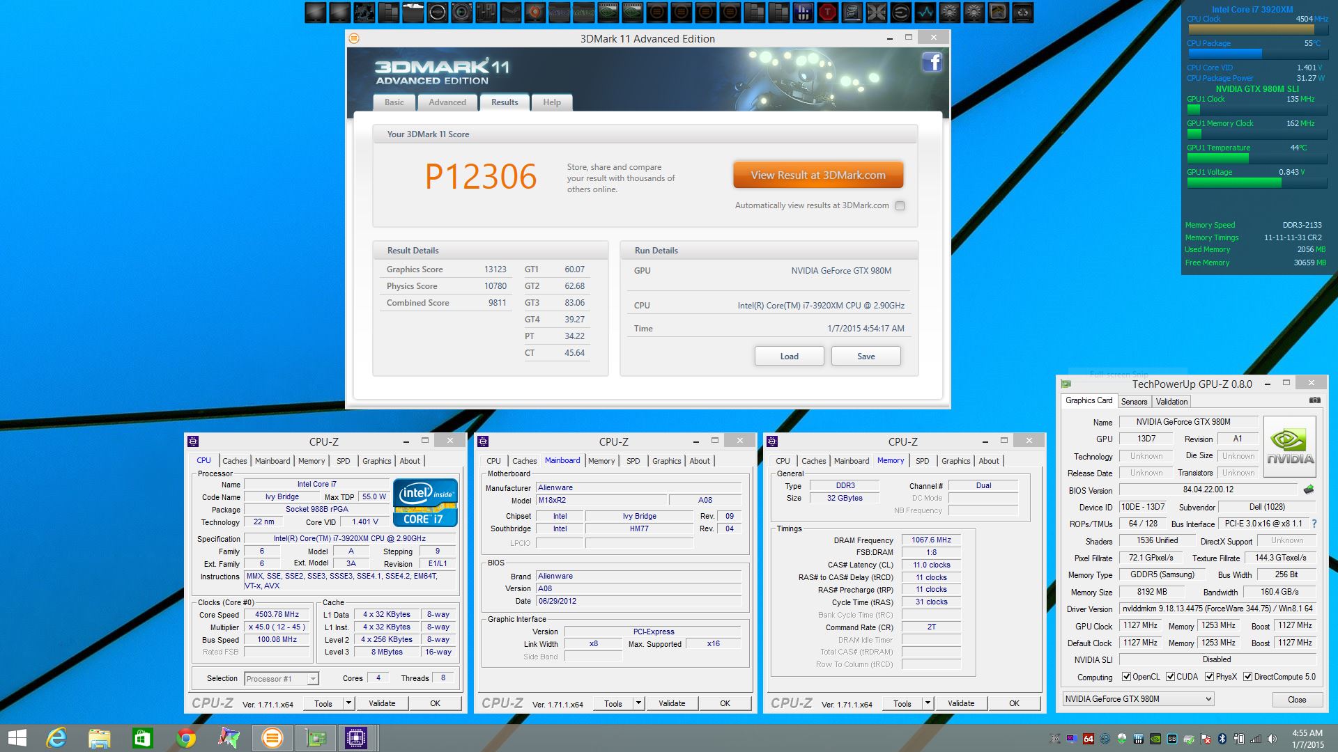

Well, no dice with SLI. Might be a hopeless endeavor... time will tell. I have one 980M working pretty well. Having to settle for using a machine with only one GPU is a massive disappointment, but it will have to do for now until I can afford to buy a machine these will work in that overclocks the CPU as well or better than my M18xR2.
Question: Are any of you P377SM-A owners able to run at least 4.5GHz stable with manageable temps with a 4930MX, or is that also a hopeless endeavor? I prefer the P570WM3, but open to other option if there are any that are good enough. Please let me know. I'm not sure how long I can tolerate a single GPU, especially considering that I expected better performance than 780M SLI when I dropped $1500 on these bad boys.
For you guys that actually like one GPU, be advised these benchmarks drew between 315W and 340W with just one card.
Vantage: NVIDIA GeForce GTX 980M video card benchmark result - Intel Core i7-3920XM Processor Extreme Edition,Alienware M18xR2
3DMark11: NVIDIA GeForce GTX 980M video card benchmark result - Intel Core i7-3920XM Processor Extreme Edition,Alienware M18xR2
Fire Strike: NVIDIA GeForce GTX 980M video card benchmark result - Intel Core i7-3920XM Processor Extreme Edition,Alienware M18xR2
