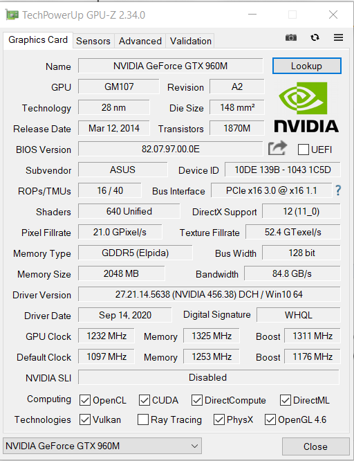

Nikola87 Posted September 27, 2020 Share Posted September 27, 2020 Hi Klem, I wrote you some time ago, but maybe I didn't explain myself well and now I'm confused about my GTX 960M gpu, so I ask you again, if I can do something to unlock clock frequencies beyond +133mhz or memory that does not exceed +144mhz in overclocking because it crashes immediately. Thanks I await your response. Quote Link to comment Share on other sites More sharing options...
Bios Modder Klem Posted September 27, 2020 Bios Modder Share Posted September 27, 2020 21 minutes ago, Nikola87 said: Hi Klem, I wrote you some time ago, but maybe I didn't explain myself well and now I'm confused about my GTX 960M gpu, so I ask you again, if I can do something to unlock clock frequencies beyond +133mhz or memory that does not exceed +144mhz in overclocking because it crashes immediately. Thanks I await your response. Hi! I already answered you, it's not a bios limitation. It's means that memory type on your Nvidia card can't overclock more than +140 MHz. Because on your card soldered Elpida memory chips. Samsung memory chips can overclock much more. Hynix and Micron memory chips also maybe can overclock more than Elpida, but low than Samsung chips. 1 Quote Link to comment Share on other sites More sharing options...
Nikola87 Posted September 27, 2020 Share Posted September 27, 2020 (edited) 3 hours ago, Klem said: Hi! I already answered you, it's not a bios limitation. It's means that memory type on your Nvidia card can't overclock more than +140 MHz. Because on your card soldered Elpida memory chips. Samsung memory chips can overclock much more. Hynix and Micron memory chips also maybe can overclock more than Elpida, but low than Samsung chips. I understand, thanks, so even unlocking only the system bios it can't do anything for gpu, right? Edited September 27, 2020 by Nikola87 Quote Link to comment Share on other sites More sharing options...
