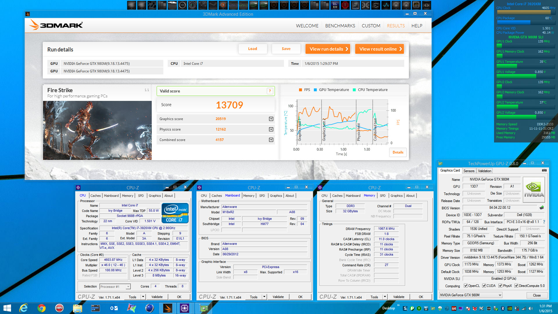

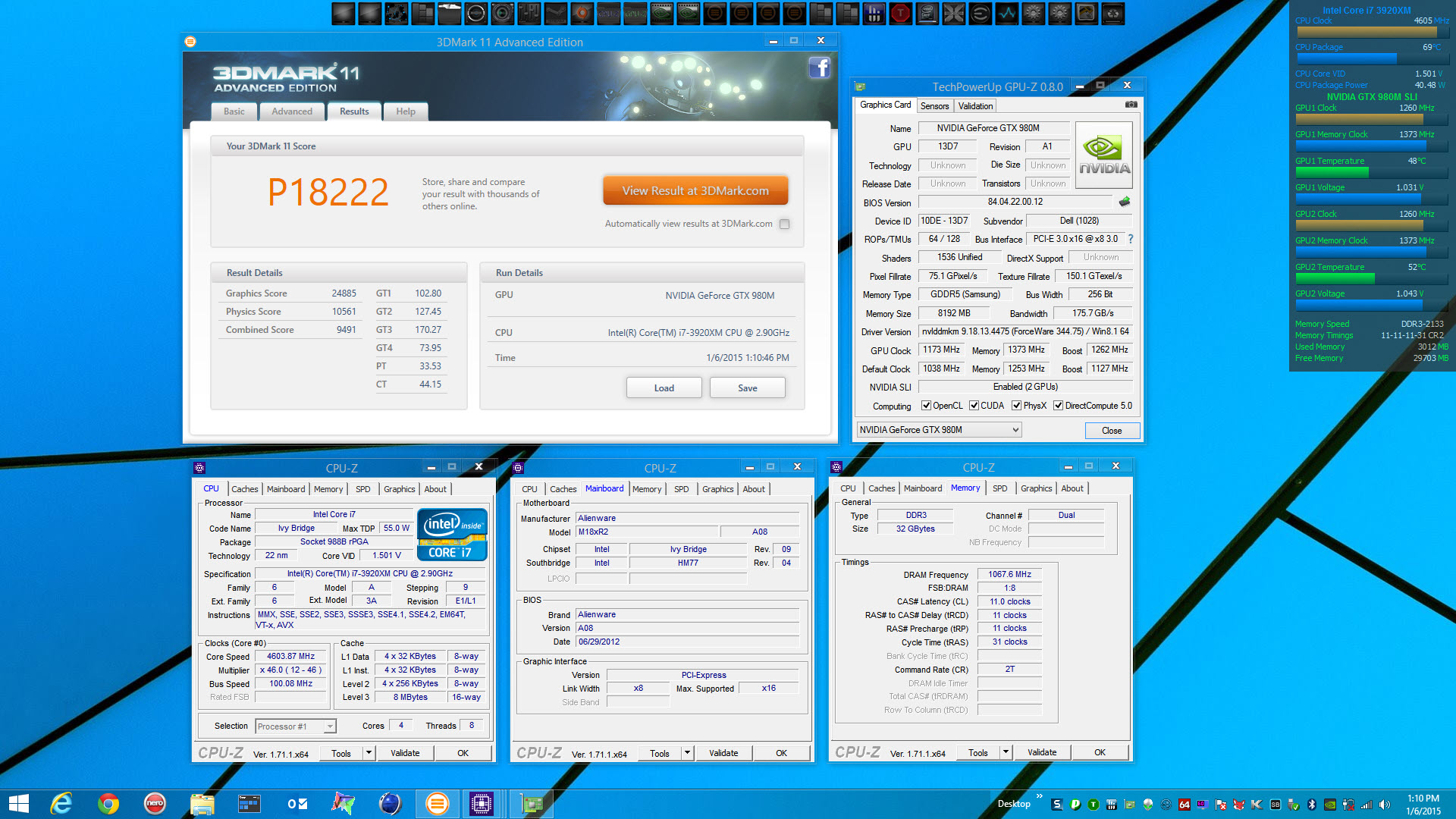

This vBIOS is great! Stock clocks are now the boost ones and they run at 0.95V..
Stock 3D Mark 11: Intel Core i7 3940XM @4.2GHz and stock 970M(running on full boost): NVIDIA GeForce GTX 970M video card benchmark result - Intel Core i7-3940XM,Alienware M17xR4
For Firestrike: Stock 970M (full boost ) + 3940XM @ 4.2GHz: NVIDIA GeForce GTX 970M video card benchmark result - Intel Core i7-3940XM,Alienware M17xR4
Anyways, max stable OC I've done on 344.75 is +300 core and +600 memory (+300 on boost memory clock) with power target on 130% and 1.056V..
Will be doing more benching later today.. Need to ramp the voltage up a bit..
