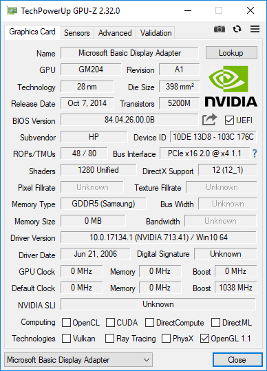

walks Posted June 3, 2020 Share Posted June 3, 2020 Hey Klem, I have an HP Elitebook 8770w with a GTX970M. I would get constant black screens and freeze ups with default MSI vbios, so I loaded a Clevo vbios and made some tweaks to the clocks and volts and now its a little more stable, but I still get black screens and freeze ups daily. I am definitely no expert in vbios modding, so I am hoping you could take a look and provide a modded vbios for this card with your recommended tweaks. I have attached a copy of my vbios and a screenshot from NVIDIA Inspector. Let me know if you need anything else. Thanks! GM204-GTX970M-HP8770w.rom https://drive.google.com/file/d/1C7OGrJWb1hogL-qAwJwkL3kCckbQeX1m/view?usp=sharing Quote Link to comment Share on other sites More sharing options...

walks Posted June 3, 2020 Share Posted June 3, 2020 Ok, what about my stock vbios rom? can something be done with that? msi.GTX970M.6144.GM204.backup.rom: https://drive.google.com/file/d/1dK0lqqLaHXoWMx1GGMW5DNrm4hyfqVs8/view?usp=sharing Quote Link to comment Share on other sites More sharing options...

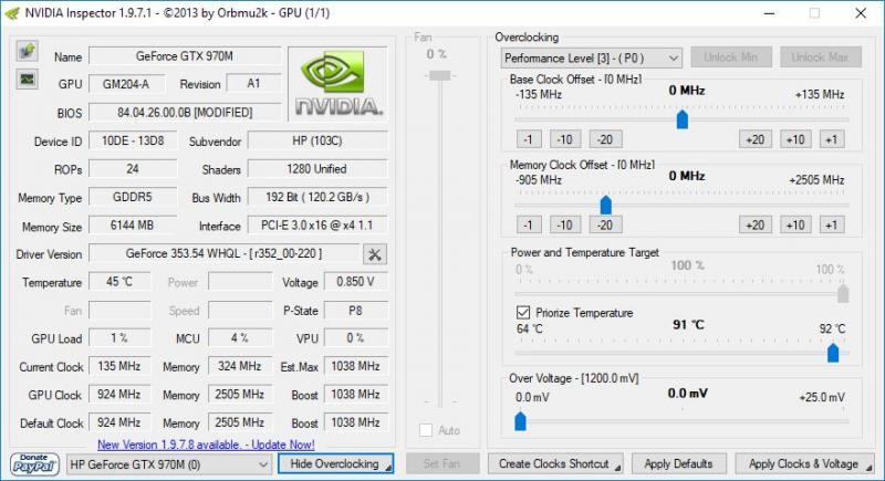

Bios Modder Klem Posted June 4, 2020 Bios Modder Share Posted June 4, 2020 22 minutes ago, MatreyuC said: Currently I just have the latest version for a 970m with matching device ID (BIOS v84.04.67.00.08) I could find on techpowerup.com . Edited 14 minutes ago by MatreyuC Does this BIOS version work fine on your laptop? Post here your screenshot in Nvidia Inspector utility (full window with overclocking sliders). Quote Link to comment Share on other sites More sharing options...
MatreyuC Posted June 4, 2020 Share Posted June 4, 2020 (edited) 7 minutes ago, Klem said: Does this BIOS version work fine on your laptop? Post here your screenshot in Nvidia Inspector utility (full window with overclocking sliders). I'm still getting the same error when I try to attach files, so here is a google drive link for the screenshot as well: https://drive.google.com/file/d/1Jec0CgTYrK746vfM4byDC-njn9sIKUC6/view?usp=sharing As far as I can tell, this BIOS version is perfectly stable, all of them I have tried were as well, so that's why I just figured I should stick with the newest one. I also have the normal default overclocking headroom in MSI afterburner, up to +135Mhz core and +1500Mhz memory. Edited June 4, 2020 by MatreyuC Quote Link to comment Share on other sites More sharing options...
Bios Modder Klem Posted June 4, 2020 Bios Modder Share Posted June 4, 2020 5 minutes ago, MatreyuC said: I'm still getting the same error when I try to attach files, so here is a google drive link for the screenshot as well: https://drive.google.com/file/d/1Jec0CgTYrK746vfM4byDC-njn9sIKUC6/view?usp=sharing As far as I can tell, this BIOS version is perfectly stable, all of them I have tried were as well, so that's why I just figured I should stick with the newest one. I also have the normal default overclocking headroom in MSI afterburner, up to +135Mhz core and +1500Mhz memory. Ok. Check PM. Quote Link to comment Share on other sites More sharing options...

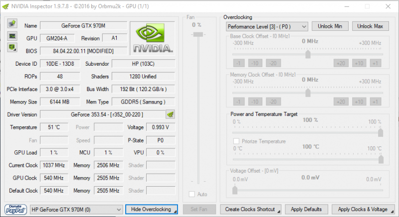

walks Posted June 4, 2020 Share Posted June 4, 2020 Hey, not sure why my stock rom I pulled from my card cannot be modded, but the last one I uploaded was the original rom that came with the card prior to me backing it up and then installing the Clevo vbios from techpowerup. I then decided to compare the two side by side via Maxwell II Bios Tweaker and the settings on both were identical. So there was no real benefit of using the Clevo rom over the stock one my card came with. So I went back to my original Rom and made some adjustments via the Maxwell II Bios Tweaker, and now the card seems to be running stable. Now that I am stable, should I only have to adjust the "Base Clock Offset" and the "Memory Clock Offset" on the "Overclocking" panel to get at least a modest overclock/performance boost? Quote Link to comment Share on other sites More sharing options...
walks Posted June 4, 2020 Share Posted June 4, 2020 Forgot to mention, I can also readjust the Temperature values if a wider range/higher cap will work better for the overclock. Quote Link to comment Share on other sites More sharing options...

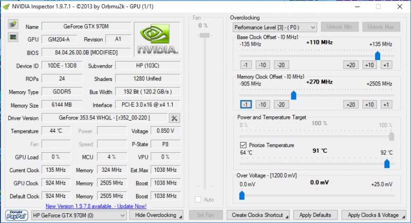

Bios Modder Klem Posted June 4, 2020 Bios Modder Share Posted June 4, 2020 10 minutes ago, walks said: Now that I am stable, should I only have to adjust the "Base Clock Offset" and the "Memory Clock Offset" on the "Overclocking" panel to get at least a modest overclock/performance boost? Just move overclocking sliders to right side in Nvidia Inspector, and then click "Apply Clocks & Voltage". Quote Link to comment Share on other sites More sharing options...
walks Posted June 4, 2020 Share Posted June 4, 2020 (edited) 1 hour ago, Klem said: Just move overclocking sliders to right side in Nvidia Inspector, and then click "Apply Clocks & Voltage". Ok, should I see the values stick after clicking "Apply Clocks & Voltage" ? Below are the values I adjusted the sliders to, but when I click the apply button the settings clear and the defaults are shown again. Is that normal? Before clicking apply: After Clicking apply: However, when I startup Afterburner and adjust the settings, I do see a difference in the Fire Strike tests I am running to gauge the difference in the settings. Edited June 4, 2020 by walks Quote Link to comment Share on other sites More sharing options...
walks Posted June 4, 2020 Share Posted June 4, 2020 Disregard, my previous question about applying the settings. It did not take before, but after rebooting, the settings stick when I hit apply now. Quote Link to comment Share on other sites More sharing options...
