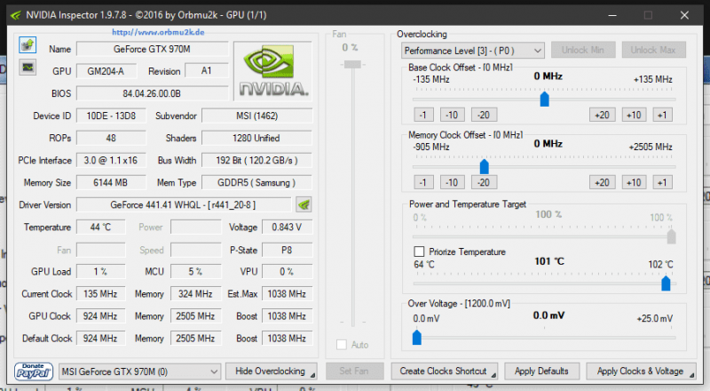

Asavage9794 Posted April 23, 2020 Share Posted April 23, 2020 (edited) Hello. I have a GTX 970M 6GB clevo card I want to overclock. It's limiting me to +135Mhz on the core, and I want to push it higher. I have also noticed the over voltage doesn't work. If you could help me, that would be much appreciated. Below is the attached VBIOS I pulled from my GTX 970M. STOCK_VBIOS_GTX970M.rom Edited April 23, 2020 by Asavage9794 Adding things in Quote Link to comment Share on other sites More sharing options...
Bios Modder Klem Posted April 23, 2020 Bios Modder Share Posted April 23, 2020 (edited) 1 hour ago, Asavage9794 said: Hello. I have a GTX 970M 6GB clevo card I want to overclock. It's limiting me to +135Mhz on the core, and I want to push it higher. I have also noticed the over voltage doesn't work. If you could help me, that would be much appreciated. Below is the attached VBIOS I pulled from my GTX 970M. STOCK_VBIOS_GTX970M.rom 181 kB · 0 downloads Hi! Ok. Check PM. Edited April 23, 2020 by Klem Quote Link to comment Share on other sites More sharing options...

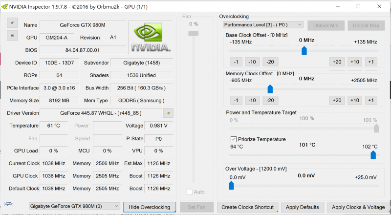

Bunchie16 Posted April 29, 2020 Share Posted April 29, 2020 Hi Klem! I have a Gigabyte P35XV5 with a 980m. Is there any chance you would be able to have a crack at making a modded vBios for it? Stock vBios and NVIDIA Inspector screenshot as requested, but shout if you need anything else! Thanks! GM204.rom Quote Link to comment Share on other sites More sharing options...
Bios Modder Klem Posted April 29, 2020 Bios Modder Share Posted April 29, 2020 1 hour ago, Bunchie16 said: Hi Klem! I have a Gigabyte P35XV5 with a 980m. Is there any chance you would be able to have a crack at making a modded vBios for it? Stock vBios and NVIDIA Inspector screenshot as requested, but shout if you need anything else! Thanks! GM204.rom 118 kB · 0 downloads Hi! Ok. Check PM. Quote Link to comment Share on other sites More sharing options...

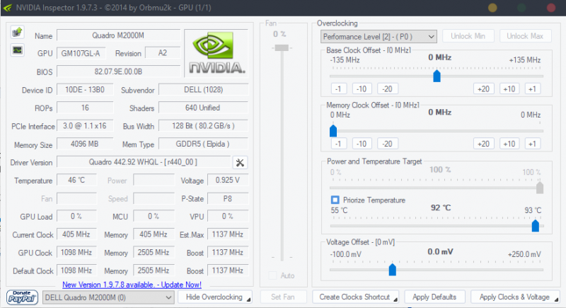

iEstavan Posted May 3, 2020 Share Posted May 3, 2020 (edited) Hello, could you do something with this? Nvidia M2000M used at Dell notebook. Bios in attachment. Thanks in advance. Bios: (cant add attachment) https://www15.zippyshare.com/v/eXBnvJ68/file.htmlGM107.rom Edited May 3, 2020 by iEstavan Quote Link to comment Share on other sites More sharing options...
Bios Modder Klem Posted May 3, 2020 Bios Modder Share Posted May 3, 2020 1 hour ago, iEstavan said: Hello, could you do something with this? Nvidia M2000M used at Dell notebook. Bios in attachment. Thanks in advance. Bios: (cant add attachment) https://www15.zippyshare.com/v/eXBnvJ68/file.htmlGM107.romUnavailable Hi! Ok. Check PM. Quote Link to comment Share on other sites More sharing options...
