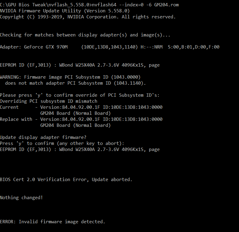

Hi Klem,
im a new member and i need help on modified vbios of my Asus ROG GL2502VT GTX970m. im trying to upload the modified vbios but there is no luck. Error has been shown on below image and Original & Modified vBios was attached. im using MaxwellBiosTweaker_1.36 for vBios modification.
i hope you can help me how can i upload the modified vbios and if you can share some software for vbios editor.

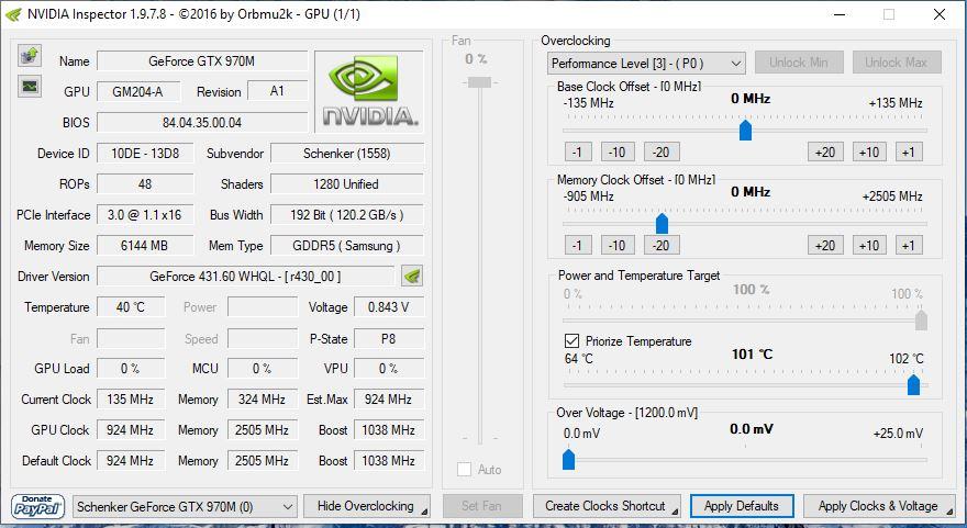

Hey @Klem
Here is my Vbios of my GTX970m 3go for my MSI GS60 6QE 023FR
Is it possible to unlock it and to increase the boost frequency from 1037 to 1172 ( no need to change volt)
 and the stock frequency from 924 to 1059
thanks a lot
Also i tryed to change those parameter by myself using maxwellII bios tweaker but when i flash it say Bios cert 2.0 verification error
wondering if you know why and how pass that ( i used older and bypassed version of nvflash , doesnt matter)
Waiting for your reply
Nk

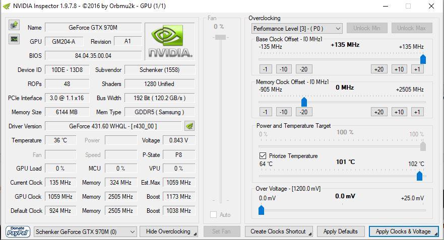

45 minutes ago, Tsubaki67 said:
Hey @Klem
thanks a lot
Nk
GM204.rar

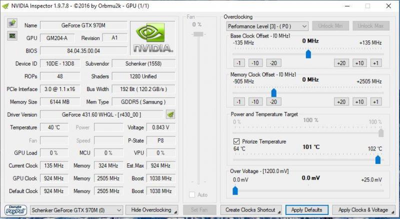

Hi!
To flash your modified vBIOS just use special NVFlash version v5.287 or v5.218 from this link:  https://www.overclock.net/forum/71-nvidia-drivers-overclocking-software/1521334-official-nvflash-certificate-checks-bypassed-gtx-950-960-970-980-980ti-titan-x.html
6 minutes ago, Klem said:
Thanks a lot
I already tryed those version, i think maxwellII bios tweaker is not working properly on my vbios
Can you try mod it with your programm so i can try again to see if this is the problem ?
( i also dont know how unlock things with maxwellII bios tweaker)

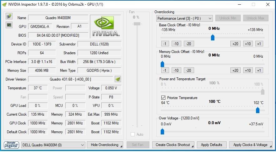

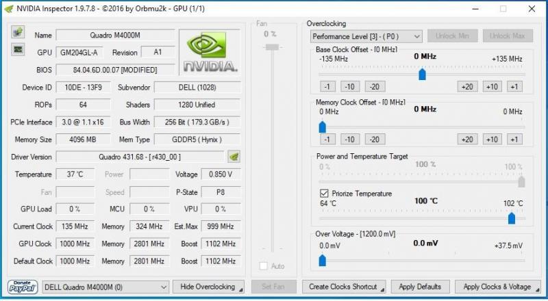

17 hours ago, pseudodeed said:
Hello can anybody unlock this bios file for OC, please? Thank you
Overcklocking does not working for VRAM and for GPU too.
I have a dell M6800. Thanks
M4000M_GM204.zip
Hi!
Please post here your screenshot in Nvidia Inspector utility (full window with overclocking sliders).
  • Bios Modder
43 minutes ago, pseudodeed said:
I dont know how i can increase the powertarget. Please can you make me a second *.Rom with  120W Powertarget?
Thank you.
Ok. Check PM.

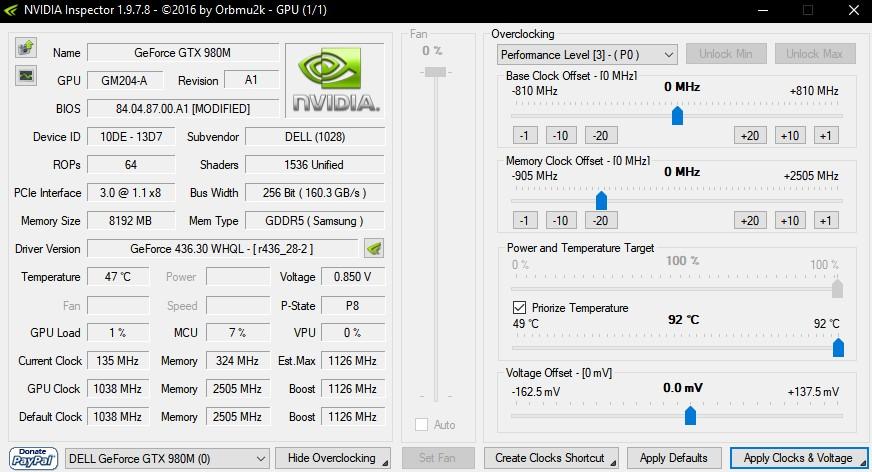

Ok 2 things...
#1 Can a mod please Delete the post above mine by user jenilia122  that is a link to a very shady Filipino potential phishing site.

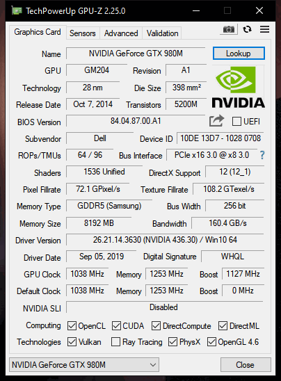

#2 Is anyone still modding/Unlocking Alienware 17 R3 vBios?
Attached Files: Current vBios being used, and GPU-Z and Nvidia Inspector screencaps of the GPU.
GM204.rom
Edited by tutsuo

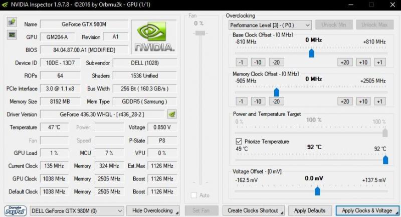

On 10/13/2018 at 3:46 PM, bazza2000 said:
Hello forum first post .
I got my hands on a Alienware 17r2 with a 980m 4gb GFX . I bought it very cheap knowing it comes with a lot throttling issues which ive dealt with via repaste and getting good setting using throttle stop , I was pointed in the direction by another forum about getting custom vbios which will help with this headache of a Alienware ,
long story short can you please help me Klem as my knowledge is limited in the vbios settings
Thank you inadvance if you can cheers
GM204.rom
i woud be really grateful  for a modded undervolted vbios i completely forgot abiout this post as i solved my issues by using windows 7 but as its now
EOL  ive upgraded to windows 10 and im now getting serious throttling thanks again if you can help me
