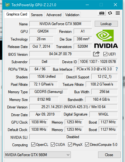

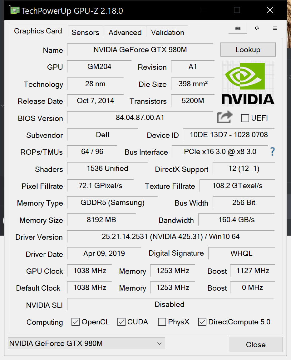

mirage_bg Posted March 28, 2019 Share Posted March 28, 2019 Hi, Klem! Can you unlock the voltage slider in MSI Afterburner/NVInspector and unlock the max o/c limit (+135Mhz) on my Quadro M5000M? Here is the screenshot of GPU-Z and the vbios.rom: bios.rom Quote Link to comment Share on other sites More sharing options...
Bios Modder Klem Posted March 29, 2019 Bios Modder Share Posted March 29, 2019 8 hours ago, mirage_bg said: Hi, Klem! Can you unlock the voltage slider in MSI Afterburner/NVInspector and unlock the max o/c limit (+135Mhz) on my Quadro M5000M? Here is the screenshot of GPU-Z and the vbios.rom: bios.rom Hi! Ok. Check your PM box. Quote Link to comment Share on other sites More sharing options...

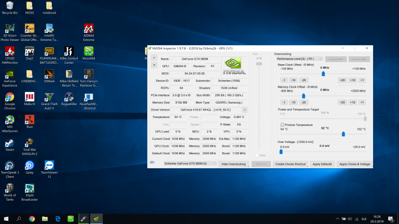

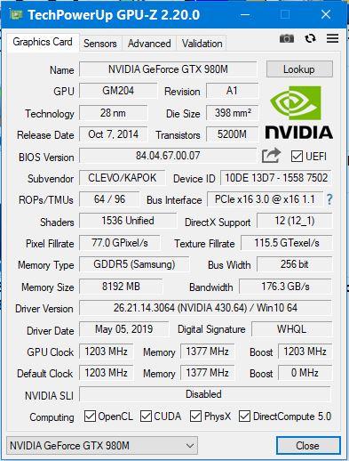

mys3544 Posted March 29, 2019 Share Posted March 29, 2019 (edited) Hi @Klem I have an Eurocom sky X4 / Clevo P750DM-G with GTX980m 8GB with G-SYNC (BIOS attached) is there any working version of your unlocked BIOS that is compatible with my device ? Or can you please unlock my current BIOS ? Thank you bios.rom Edited March 29, 2019 by mys3544 Quote Link to comment Share on other sites More sharing options...
Bios Modder Klem Posted March 29, 2019 Bios Modder Share Posted March 29, 2019 (edited) 5 minutes ago, mys3544 said: Hi @Klem I have an Eurocom sky X4 / Clevo P750DM-G with GTX980m 8GB with G-SYNC (BIOS attached) is there any working version of your unlocked BIOS that is compatible with my device ? Or can you please unlock my current BIOS ? Thank you bios.rom Hi! Ok. Check PM. Edited March 29, 2019 by Klem Quote Link to comment Share on other sites More sharing options...

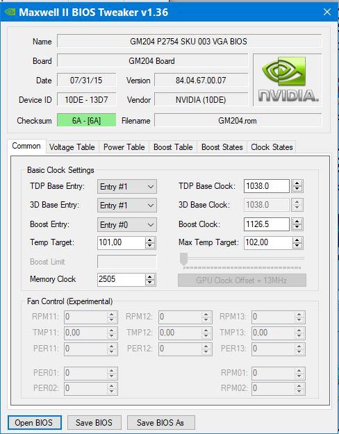

poorejj Posted April 8, 2019 Share Posted April 8, 2019 @Klem I'm not sure who I should contact who might be able to help me on here, or even be willing to. Last Saturday I installed a Quadro M4000M in my Dell Precision M6700. I got it working... Had to modify the INF file in the driver package to get it to install, but it is working well now. What I need help with is overclocking this thing. I can get +135 on the core with Nvidia Inspector. I installed Maxwell bios tweaker II and I am just not experienced enough to mess around in here yet. I had modded a vbios a couple years ago with Kepler bios tweaker and it worked well, but I'm real rusty and don't want to mess up the new card... Any help would be appreciated. I am looking for something modest. It would be great if I could get a little more on the core like maybe +200 or +250 (I'm not sure what these are capable of, but I wouldn't want to run within 25mhz of max. I would like something any version of these cards regardless of the silicon lottery should be capable of) and a memory boost would be nice which I cannot get with Nvidia Inspector. Thanks Quote Link to comment Share on other sites More sharing options...
Bios Modder Klem Posted April 9, 2019 Bios Modder Share Posted April 9, 2019 10 hours ago, poorejj said: @Klem I'm not sure who I should contact who might be able to help me on here, or even be willing to. Last Saturday I installed a Quadro M4000M in my Dell Precision M6700. I got it working... Had to modify the INF file in the driver package to get it to install, but it is working well now. What I need help with is overclocking this thing. I can get +135 on the core with Nvidia Inspector. I installed Maxwell bios tweaker II and I am just not experienced enough to mess around in here yet. I had modded a vbios a couple years ago with Kepler bios tweaker and it worked well, but I'm real rusty and don't want to mess up the new card... Any help would be appreciated. I am looking for something modest. It would be great if I could get a little more on the core like maybe +200 or +250 (I'm not sure what these are capable of, but I wouldn't want to run within 25mhz of max. I would like something any version of these cards regardless of the silicon lottery should be capable of) and a memory boost would be nice which I cannot get with Nvidia Inspector. Thanks Hi! You can post here your stock vbios from your card, I'll take a look. Quote Link to comment Share on other sites More sharing options...
poorejj Posted April 9, 2019 Share Posted April 9, 2019 GM204.rom Cool. Thanks Klem Quote Link to comment Share on other sites More sharing options...
Bios Modder Klem Posted April 9, 2019 Bios Modder Share Posted April 9, 2019 1 hour ago, poorejj said: GM204.rom Cool. Thanks Klem Ok. Check PM. Quote Link to comment Share on other sites More sharing options...

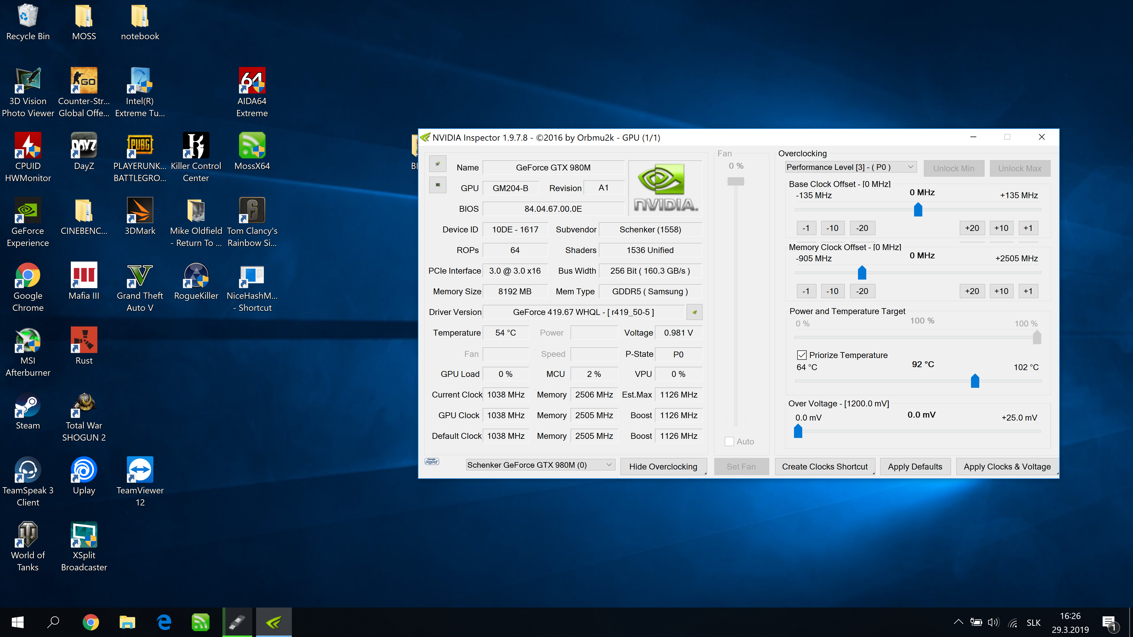

mirt1981 Posted May 13, 2019 Share Posted May 13, 2019 Hello ! Have an gtx 980m to unlock . . . tested it self by inet guides but no luck Klem can you help . . . . . . GPU and Ram are on Stock 0c Limit Quote Link to comment Share on other sites More sharing options...
mirt1981 Posted May 13, 2019 Share Posted May 13, 2019 (edited) 0riginal without GPU . . . . . . VRAM 0C Voltage Limit Edited May 13, 2019 by mirt1981 Quote Link to comment Share on other sites More sharing options...
Bios Modder Klem Posted May 13, 2019 Bios Modder Share Posted May 13, 2019 Hi! Send me your stock vbios, I'll take a look. 1 hour ago, mirt1981 said: Hello ! Have an gtx 980m to unlock . . . tested it self by inet guides but no luck Klem can you help . . . . . . GPU and Ram are on Stock 0c Limit Hi! Send me your stock vbios, I'll take a look. 1 Quote Link to comment Share on other sites More sharing options...

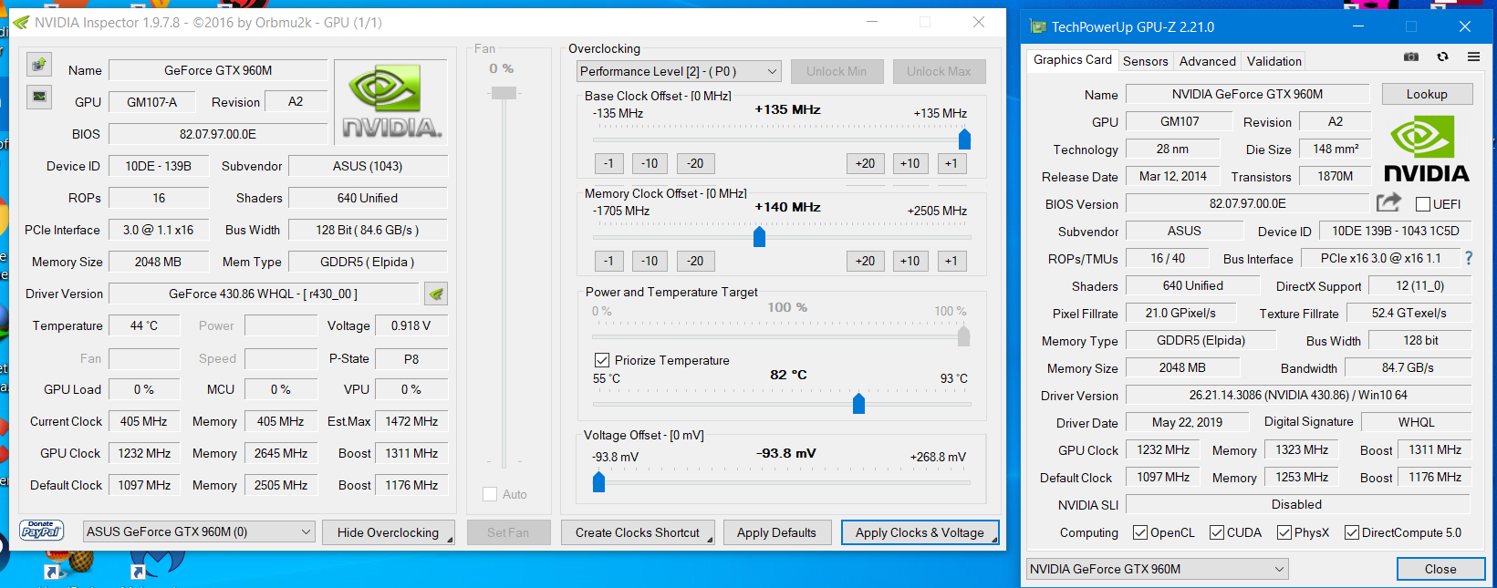

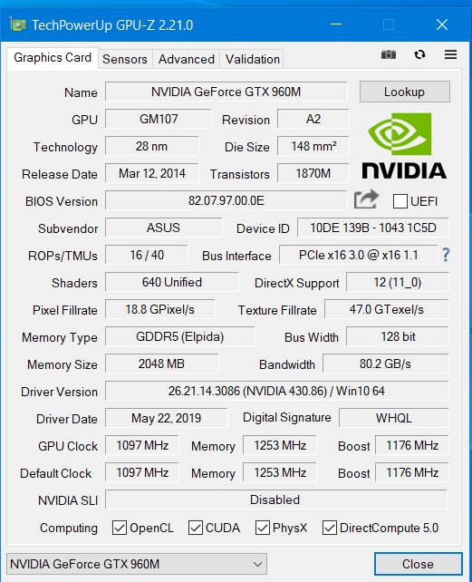

Nikola87 Posted May 29, 2019 Share Posted May 29, 2019 Hi Klem, I have an Asus Rog GL552VW-DM149 laptop with the latest version 300 of the bios. I tried the overclock GTX 960M but I noticed that the max limit of the mem clock is +140MHz and going a little further it already starts crashing. Can anything be done to unlock this limit? I have seen on the web that some have taken it up to +450/+700MHz with the same card, how is it possible? I await your news, thanks. Quote Link to comment Share on other sites More sharing options...
Bios Modder Klem Posted May 29, 2019 Bios Modder Share Posted May 29, 2019 1 hour ago, Nikola87 said: I noticed that the max limit of the mem clock is +140MHz and going a little further it already starts crashing. Can anything be done to unlock this limit? Hi! It's not a bios limitation. It's means that memory type on your Nvidia card can't overclock more than +140 MHz. Because on your card Elpida memory chips. Samsung memory chips can overclock much more. Hynix and Micron memory chips also maybe can overclock more than Elpida. Quote Link to comment Share on other sites More sharing options...

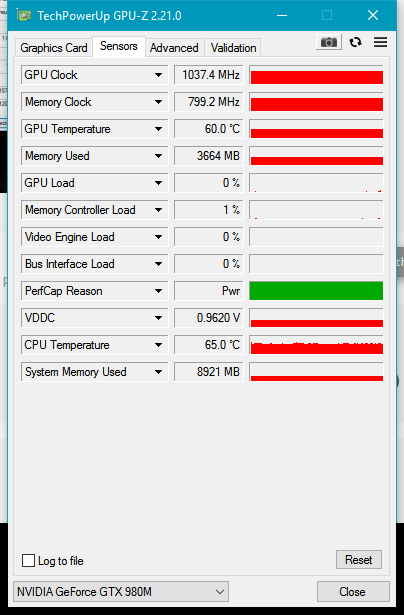

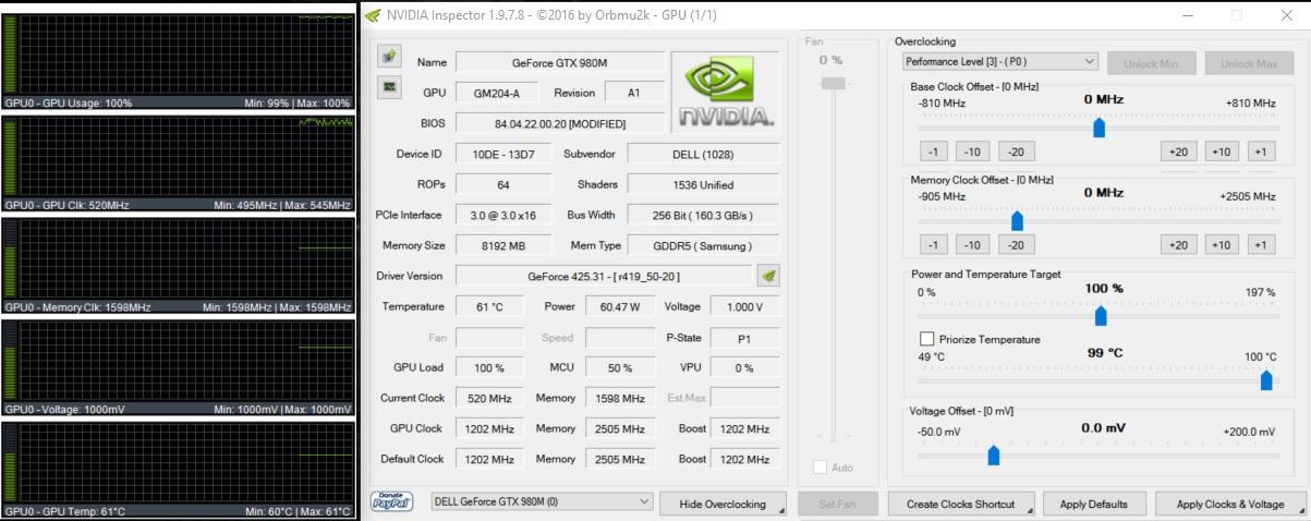

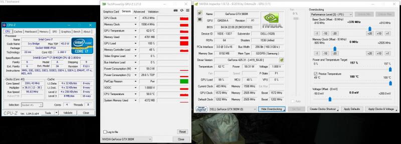

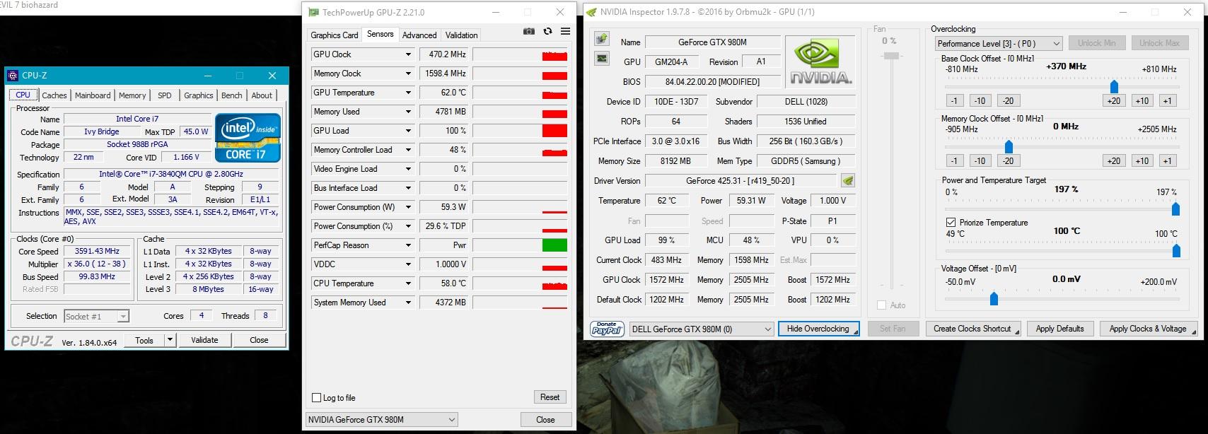

Manu369 Posted May 29, 2019 Share Posted May 29, 2019 (edited) Hi Klem, can you please unlock my current BIOS ? I have a throttle on my gpu usage (about 475mhz max when used but 1126mhz in idle with the vbios Nvidia GTX 980m - 'OC edition' rev0 ). With the original bios, I have more limited by memory clock this time, 799mhz max and 1037mhz for the gpu clock Thk a lot ! dell_980m_original.rom Edited May 30, 2019 by Manu369 Quote Link to comment Share on other sites More sharing options...
Bios Modder Klem Posted May 30, 2019 Bios Modder Share Posted May 30, 2019 6 hours ago, Manu369 said: I have a throttle on my gpu usage (about 475mhz max when used but 1126mhz in idle with the vbios Nvidia GTX 980m - 'OC edition' rev0 ). Hi! Delete all overclock in Nvidia Inspector, put all settings to default, and create new screenshot with the vbios Nvidia GTX 980m - 'OC edition' rev0 (under 3D load) Quote Link to comment Share on other sites More sharing options...
Manu369 Posted May 30, 2019 Share Posted May 30, 2019 (edited) It's weird it's indicated gpu clock max 541Mhz but when I don't use any 3D application, the clock bring me up to 1126Mhz Edited May 30, 2019 by Manu369 Quote Link to comment Share on other sites More sharing options...
