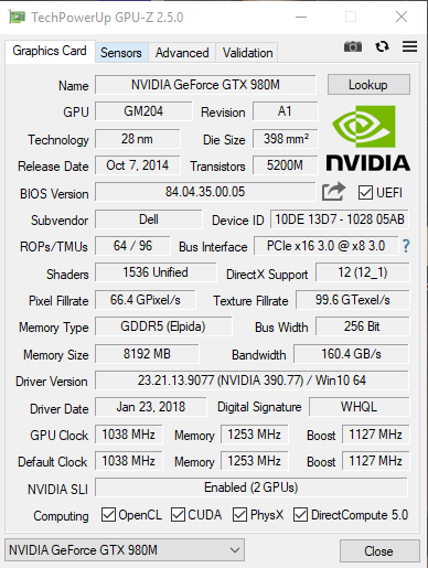

intimidating big guy Posted April 15, 2018 Share Posted April 15, 2018 (edited) My issue: After installing the modified bios, and raising voltage in Inspector to 1.06v (cannot handle at stock the 1202mhz) I now no longer run into my original TDP throttling issue however during gaming of the Witcher 3 (close to 100% GPU load) every 5 minutes I encounter 60-90 seconds of ~80% reduced FPS and audio stuttering as well. This did not happen with the original bios that came with my Dell 980m. My laptop is the Dell M6800. I have isolated the issue to hardware/bios, the issue persists even after a clean OS and software install. Is there a modified Dell 980m bios floating around? Perhaps there is some incompatibility between my motherboard and the new GPU bios. I Have played around with clocks, voltage, power settings, etc to no avail. Edited April 15, 2018 by intimidating big guy Quote Link to comment Share on other sites More sharing options...
