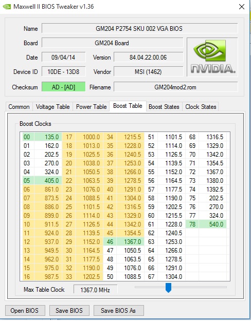

Hey John,

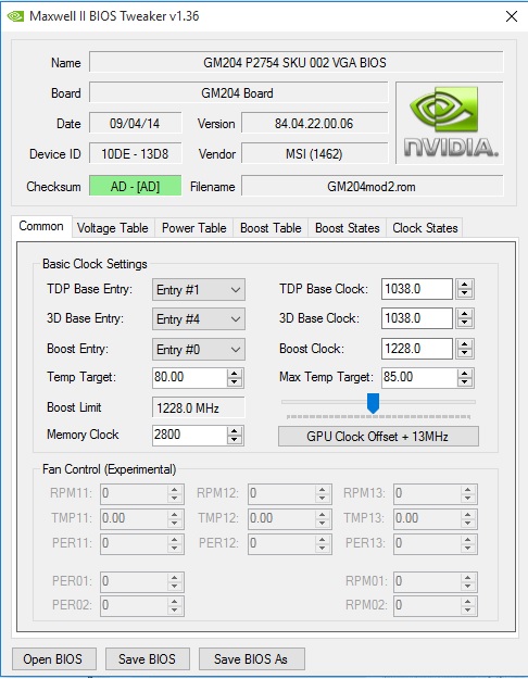

Started quickly this morning to try to mod my bios :)
So I have changed very basic things in Maxwell bios tweaker :
- TDP Base Clock
- 3D base clock
- Boost clock
I have input the same values for the 3 (1202Mhz - As a reminder, I'm trying to overclock a 970m 6GB), I do not care about having a boost for now hence why I have input the same value.
The base value for my card are :
- 924Mhz base
- 1038Mhz 3d base
- 1038Mhz boost
I know that it can reach easily the value I have entered as a lot of these 970m go easily at 1500Mhz for the core with what I have read (maybe pushing the voltage a little for some)
Once I have changed to 1202Mhz the 3 values with bios tweaker (I have also lower down the temp target and max), I have saved the Bios and flashed it without any issue.
I have reenabled the GC and restarted. I have opened GPUz but unfortunately, the value in GPUz were still the base one of my card. I have extracted my modified bios again and check with Maxwel Bios tweaker if the value I have changed were still changed and they are the updated value (See attached printscreen)
Therefore, the conclusion is that the bios modification has been taken in account in the bios but are not effective (I assume).
There must be something I'm missing , another parameter to change in MBT if I want my overclock to be effective :) Or maybe a story of Nvidia driver to change ?
Thanks for any help !
Edited by Barthelemy

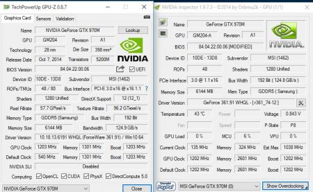

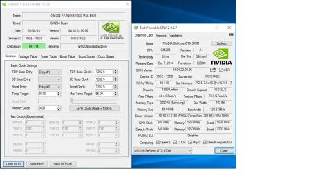

Some new developments :
without changing previous modifications (3 values at 1202.5Mhz), I changed the max table clock (in the boost table tab) to the same value (1202.5Mhz).
I flashed again and oh surprise, my values changed : (see attached)
So GPUz and Nvidia inspector detect the change of values.
I ran a steam VR performance test to confirm my overclock. Unfortunately, looking at the current clock in Nvidia inspector during the test, I see a max of 1038Mhz (the original boost clock).
There has been some improvement but still, there is a parameter I forget to apply the Bios modification ?
Maybe an important detail : it is blocked at 1038Mhz for the core clock..but for the memory clock, it has applied (unlocked) the overclock of 100Mhz (2500 to 2600Mhz) that I have chosen, the current memory clock reaching 2600Mhz during the test.
Thank you for any help
adding information

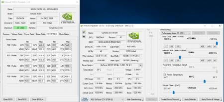

Ok, changing the boost states table is doing the trick, My GPU is now running max at the values I specified. I just changed GPC max values to 1202.5Mhz for P00, P01 and P05. Not too sure if I need to change anything for P08, I left it with the default value.
Now I guess this is about fine tuning and a lot more parameters :)
Without changing anything else, I can't go over 1300Mhz for the core, crashes. I have not pushed the memory (still 2600Mhz), will try now.
And then, I will up the voltage a little to see if I can go further for the clock core :)

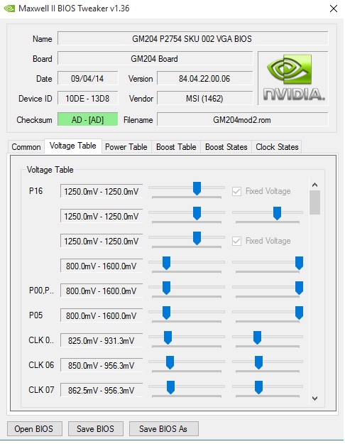

Anyway, I continued the tests today and I modified the Voltage as it seems that I can only have a stable core overclock at 1228Mhz (and 2800Mhz for the memory - I did not really pushed the memory for now, I'm interested in the core mainly)
I went to the voltage table and modified the 3 first sliders/values associated to a Pstate 16 (strange, Nvidia inspector does not see any Pstate 16). I have just increased the voltage from 1200mvolts to 1218mvolts (1 cranck) for the first one and did the same for the rest (increase by 1 cracnk). Result, no success, on my core overclock test value (1266mhz) it is crashing.
on the second test, I noticed at the bottom of the voltage table, a voltage slider not associated with any CLK or Pstate, I decided (randomly I must say :whistle:) to increase that voltage from 1200mvolts to 1218mvolts. No result as well, it is crashing.
I guess I'm missing something here (Again !).
Could it be that I need to push more my voltage to have an effect on the overclock stability ?
Thank you

I got back on my Bios stable overclock and tried to push the voltage/core frequency through Nvidia inspector, very limited voltage increase that way (25mVolts) but it does not change anything, crashes when going over 1250Mhz core value.  I have the feeling that I will need to push much more the voltage if I want and overclock stability at higher frequencies ? Am I right ?
Also, I read in this topic  that the MSI GT72 could have an issue of power supply, is it the case ? Did I understand well ?
Thanks for making me  a normal forum member, it looks like I can now download the modded bios of this subject, tempted :P but no, I will try to find out some ways to make that voltage increase work !
I have been shared a vbios of a normal and mod bios of a Desktop grahic card (Titan x), I will "cheat" a bit looking at what values have been modified to help me for my modification :whistle:
I have done something :whistle:  Just modifying the voltage table (each crank !! following the boost table kind of), I can now go over the 1250Mhz, I have topped at 1350Mhz. And more importanly, I have unblocked the voltage slider In Nvidia inspector Overclocking tab.
Big step up, I can defo unlock my voltage in my overclocking software via the voltage table in MBT. However, still blocked a +135Mhz on the core clock slider.
However, Even if my card can peak at 1363 Mhz (via Nvidia inspector) during a Steam VR performance, it is mostly staying lower than this averagely, It does not max out continously like it used to do, is it a sort of throttle ?
added screenshots
