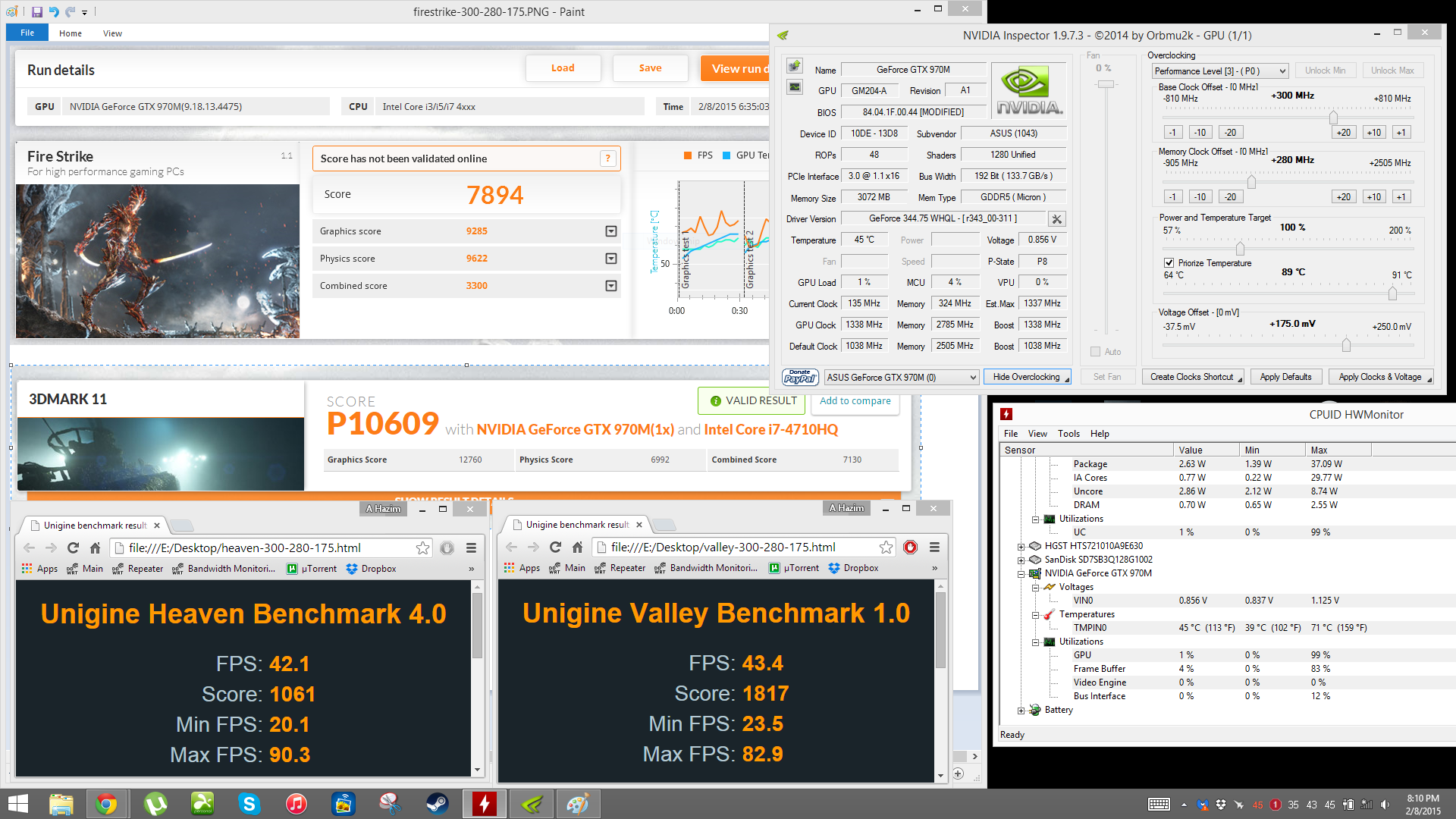

Hey. Yes i have flashed it and its good so far. Im running at 300 core & 280 mem with 1.1 volt. Scores around 10k in 3dmark11, 1800 in valley and 1k in heaven with maxed out settings (1080p) temps around 70degree C. I'll post benchmarks screenshots once i get on my laptop after work.
UPDATE with benchmark.

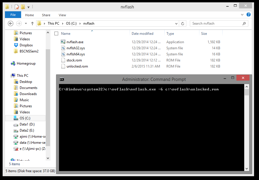

I am running an Alienware 17 R5, 8 gb GTX 980m, windows 7. The card works fine, was just looking to overclock. I cannot get mnvflash to do anything. When I try to open it and hit enter, it automatically closes when I try to type any commands. What am I doing wrong!? About to rip my hair out here!
You don't run it from the nvflash file. You should open an elevated command prompt then type in the commands. In my case: c:\nvflash\nvflash.exe -6 c:\nvflash\XXXXX.rom where XXXX is the vbios file name located in the nvflash folder.
Pic to help you out:
PS: Don't forget to disable the display driver in the device manager before running the above command. ;)
[ATTACH=CONFIG]14008[/ATTACH]
