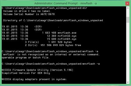

@svl7 : Any chance you can mod nvmflash to be usable with UEFI (Alienware 18)?
It tries to find the adapters but is stuck. Right now I can`t even flash my GTX 970Ms on this locked down machine :/
I`m looking to downvolt my GPUs because HWInfo can only do 0, low and high fan settings. And the low is almost enough but I need to downvolt them to be able to.
Here is what I get using mnvflash. I tried having it on for 5 minutes but its stuck
