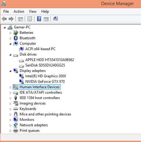

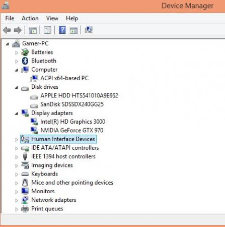

So, my MBP 2011 HDD broke down two weeks ago. So I replaced it with my previous HDD from Mac Mini (whom I replaced with SDD). This HDD has a Windows 8.1 bootcamp. I tried to implement the eGPU bootcamp on my Mini before with no success.

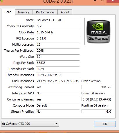

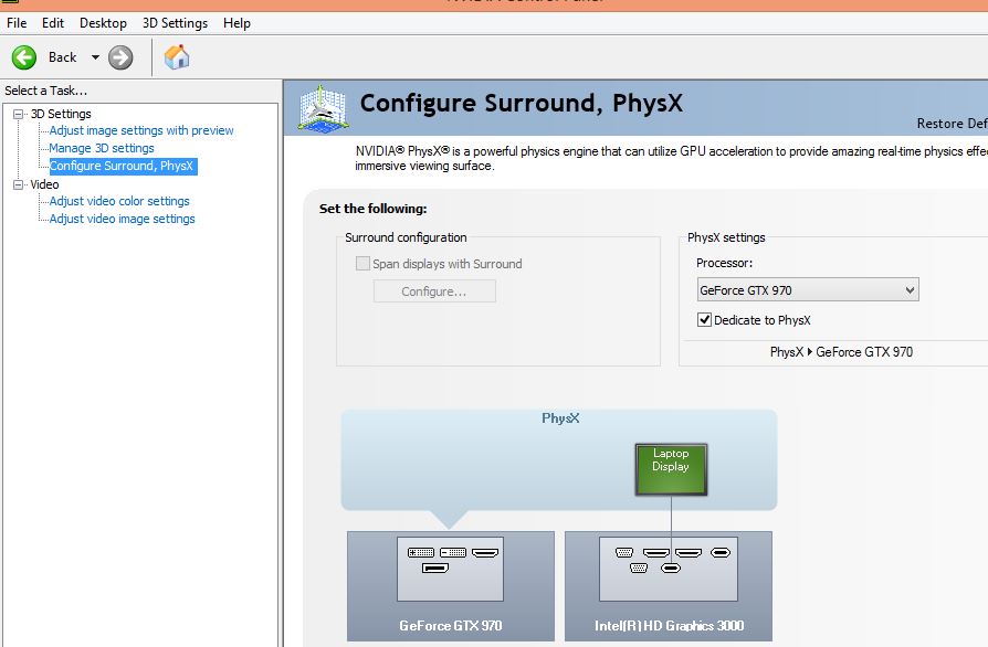

So I installed the HDD and run OSX, fine. Then, I tried to setup my Bootcamp again with eGPU. So here we go, rebooted my machine to Windows 8.1, GPU was automatically detected and I installed the latest driver. Restarted with external display, and it worked painlessly.
Another test I made was to run the eGPU/Bootcamp without the external monitor. It worked as soon as I boot to Windows no extra configurations made. So here you go sharing my benchmark scores.
System
2011 13" Macbook Pro : i5-2415M 2.3Ghz, 8GB RAM, HD3000 iGPU
Windows 8.1 64-bit UEFI install
GTX970 eGPU @ 10Gbps-TB1 via AKiTiO Thunder2
Benchmark Results

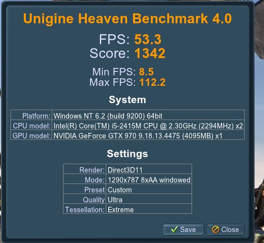

3dmark-FS.gpu (internal LCD) = 6739
3dmark-FS (external LCD) = 9225
Unigine gave me 1342
Other screenshots for additional info
