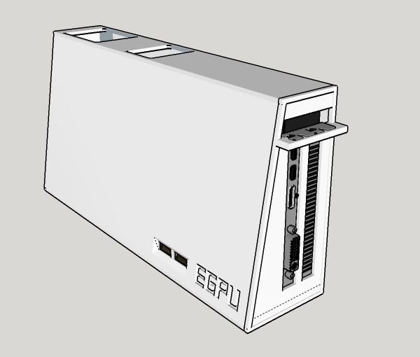

Hi,
I've made this for my PE4C with the intent of 3D printing it.
But I got back on my gaming laptop and aren't using my eGPU much lately. So I've drop the idea.
I'm dropping the project files here hoping it could prove useful. It may still need some adjustments.
Here.
PS: I took the first filesharing website I've found.
So that's where my post went. I was worried I had broken one of the forum rules ^^
Instead of a generic enclosure, I could make one for Akitio Thunder2 and/or for the EXP GDC if somebody provide me enough pictures.
