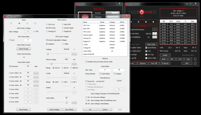

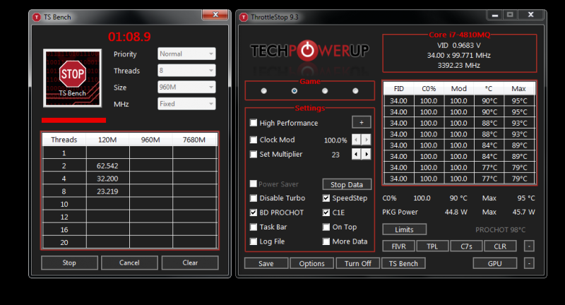

amfire32 Posted March 25, 2022 Share Posted March 25, 2022 Theoretically for lq cpu 4810MQ you can overclock up to: 42x for the first core 41x for the second core 40x for the third core 40x for the fourth core Beyond you can not go because the multipliers are locked by the factory. However, using the CPU at 4ghz for all 4 cores on a notebook such as the GT70 from MSI involves the overcoming of two limitations 1) The temperature that reaches over 90 degrees under stress and involves a reduction of the clock. 2) Limit on power consumption (TDP) which should have a peak of 65-70w for a few seconds and then stabilize around 47w. If you exceed the temperature limit or the TPD limit any overclock you set will be cut in performance. Who wants to improve the performance of this cpu must work on optimization. You have to find the right compromise by setting a "clock" speed that does not make the temperatures rise above 90 degrees and that does not exceed the limitations imposed by the TDP (Thermal Design Power). You can download the program THROTTLESTOP that at the moment has arrived at version 9.4. For this you can also act on the voltage trying to favor a slight undervolt of the cpu. Quote Link to comment Share on other sites More sharing options...
amfire32 Posted March 25, 2022 Share Posted March 25, 2022 This is the configuration of a gt70 that I have. I am using the frequency of 3.4ghz for 4 cores. The temperature under stress is 95 degrees. TDP comes in at 45w I have done a voltage drop of -80.1 mV This is the maximum configuration I was able to achieve with my notebook that can run 24 hours without going into THROTTLING. Quote Link to comment Share on other sites More sharing options...
