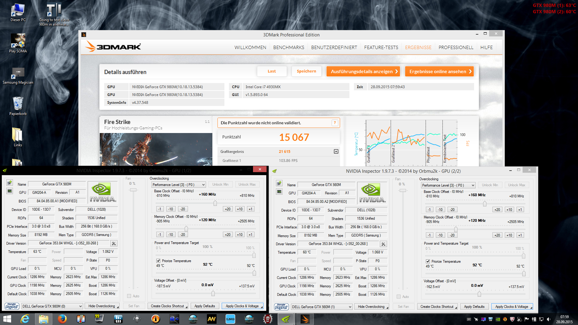

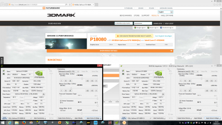

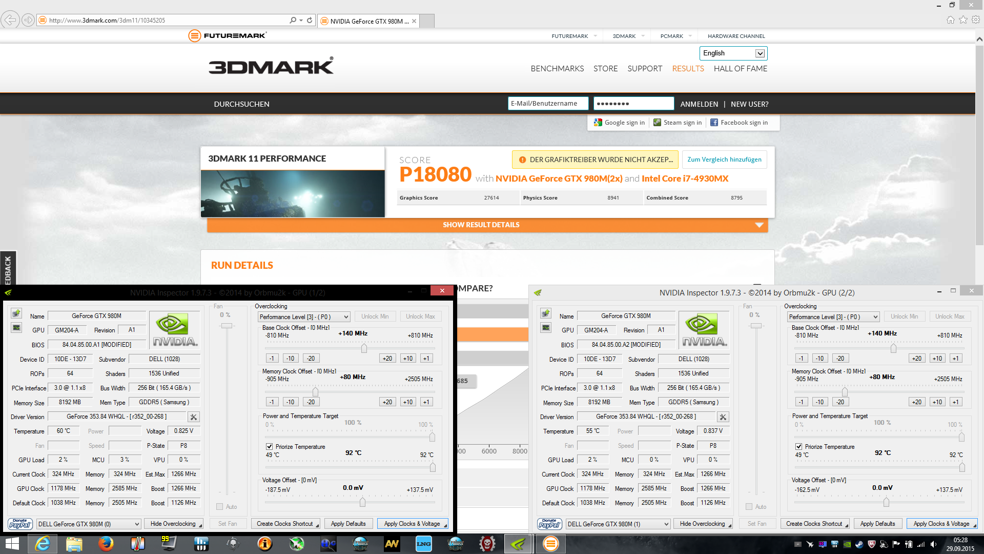

Navigator Posted October 1, 2015 Share Posted October 1, 2015 Firestrike with prema vbios mod - - - Updated - - - 3d11 with prema vbios mod Quote Link to comment Share on other sites More sharing options...

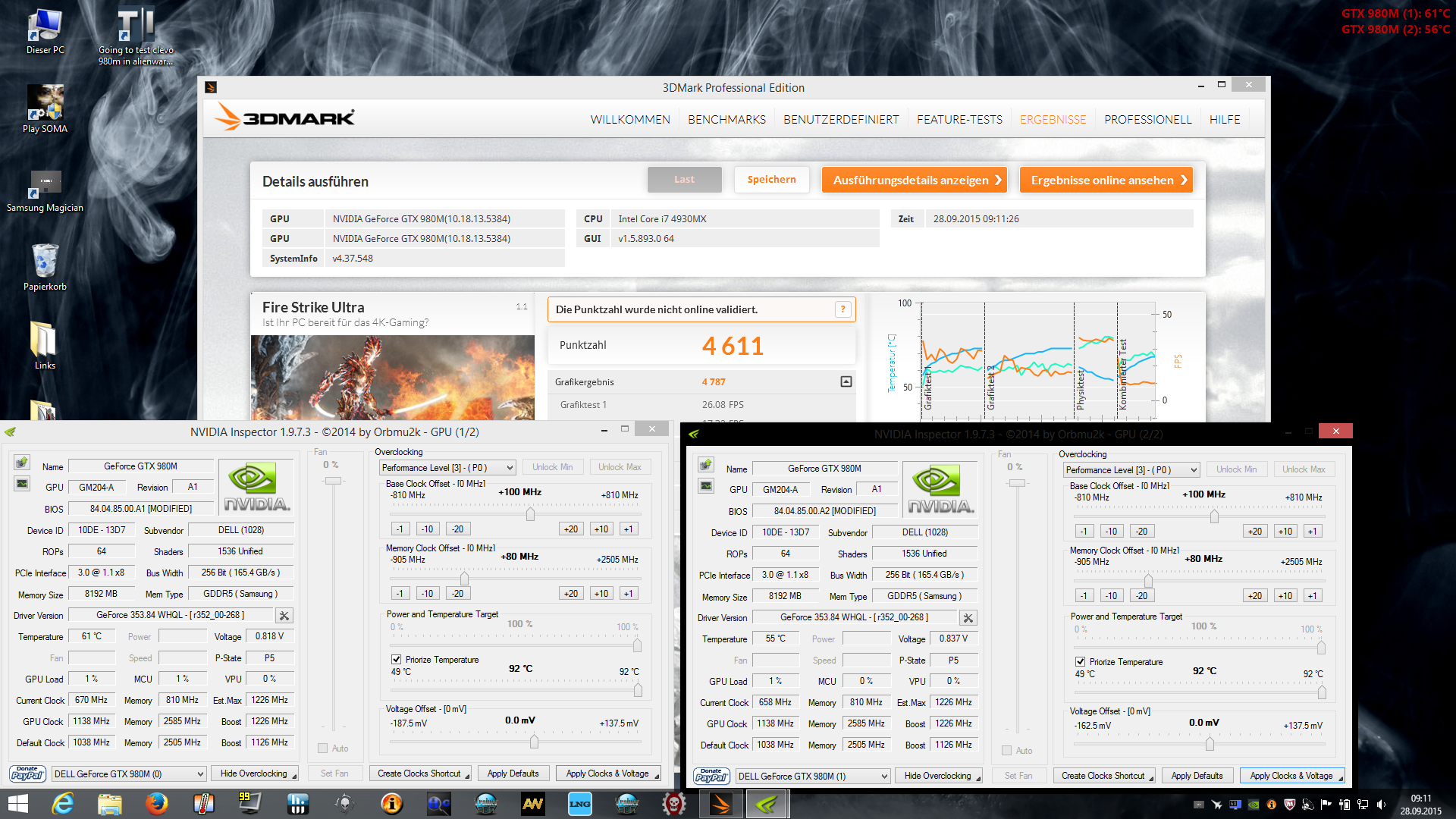

Navigator Posted October 1, 2015 Share Posted October 1, 2015 firestrike 4k with prema Quote Link to comment Share on other sites More sharing options...
