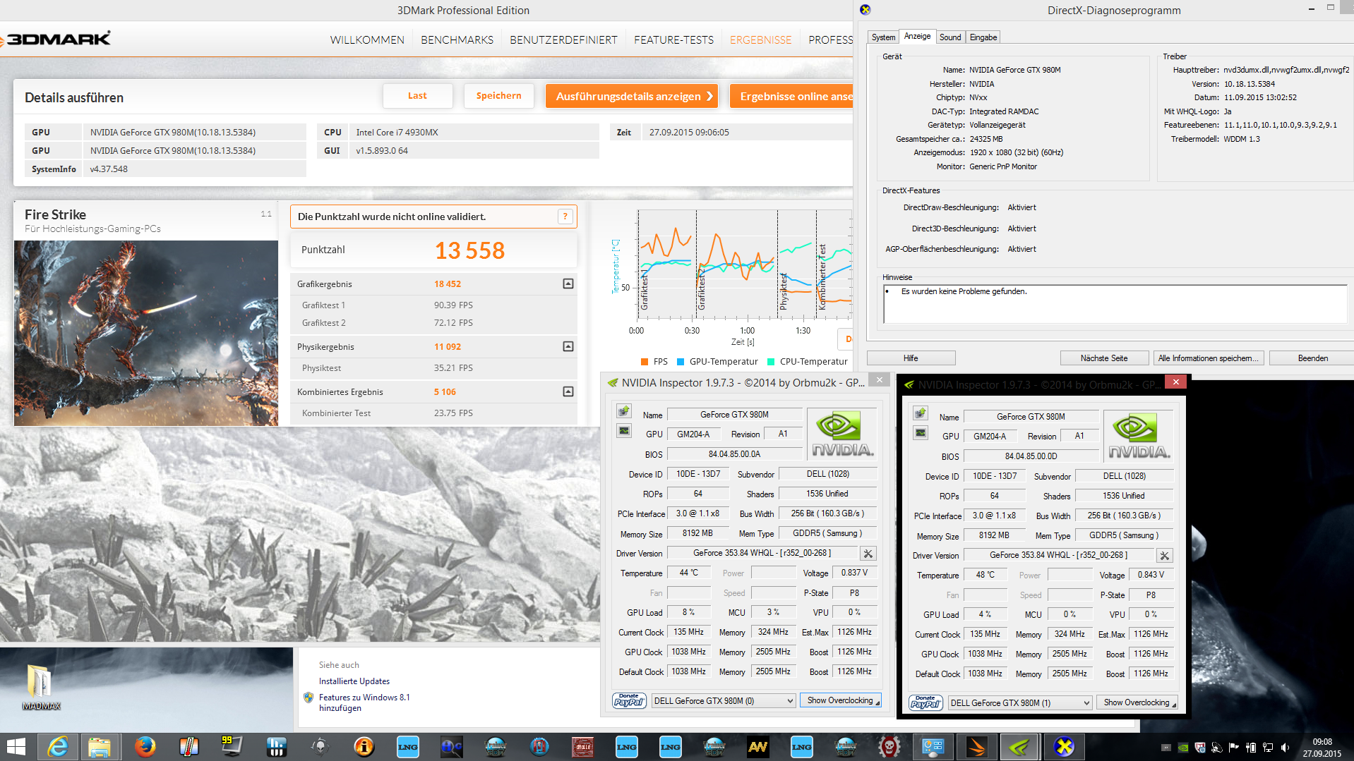

Navigator Posted September 27, 2015 Share Posted September 27, 2015 since 25 September on us site the new alienware 18 bios and vbios is out.i flashed the bios.and then i flashed the vbios on my ceg clevo Cards.the result makes me happy.the Cards run now cooler.max 74 degrees.the fan mode is now useless and the fan works now on Card 2.the vbios have the same firestrike Points like the prema vbios with no overclock 13400-13700 with no cpu overclock.no shutdowns bsod but i see at 15-20 minutes ghosting on Desktop Background on colour dark Grey.the only original Driver from Windows works without Driver sign out on Windows 8.1 353.84.you have to activate the Driver automatic install from Windows update and bevor you habe to deinstall all with ddu. have somebody a solution for other Driver original from nvidia to work.my english is poor and i hope all guys understand my post.greetings from vienna Quote Link to comment Share on other sites More sharing options...
Guest Posted September 27, 2015 Share Posted September 27, 2015 @Navigator that's the new BIOS fixing the throttle for you on stock clocks, not the vBIOS. Could please flash my Mod again to see if the FANs still both run properly. Just to know if the FAN fix is in slave vbios or also in the system BIOS/EC. The M18xR2 has massive throttle with the new official Dell GTX980M vBIOS': He even has pixels jumping around the screen when the GPU switches clocks. Quote Link to comment Share on other sites More sharing options...

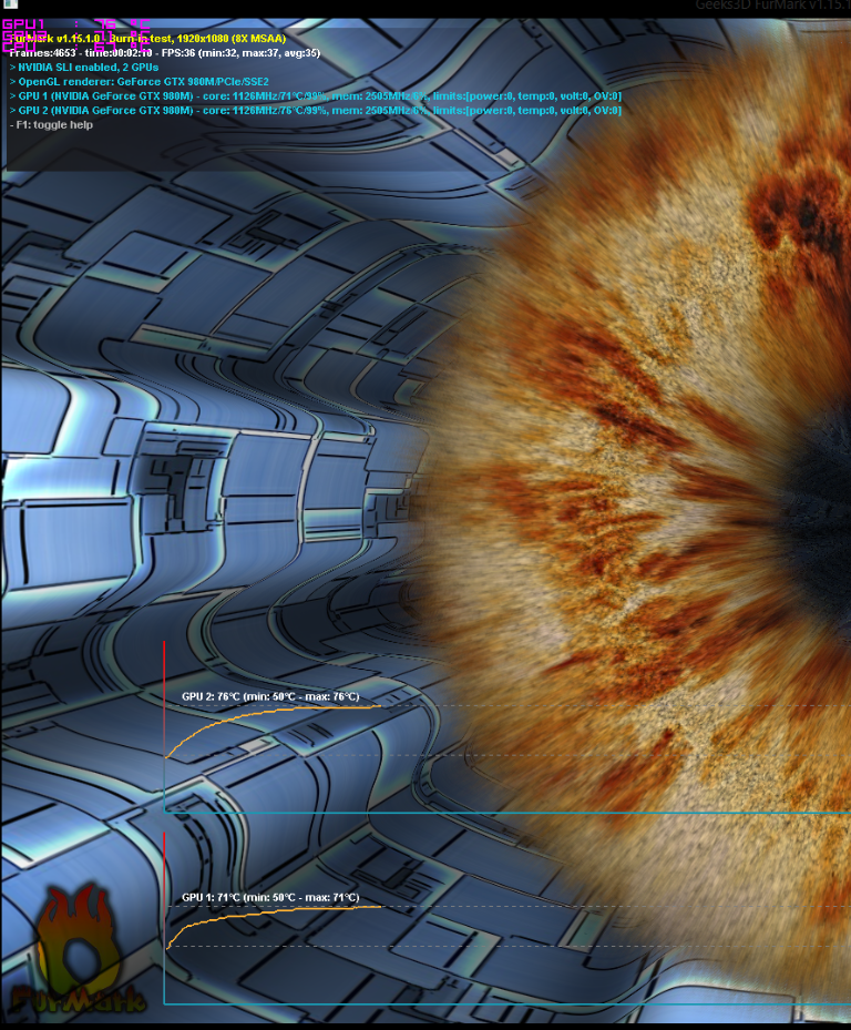

Navigator Posted September 27, 2015 Share Posted September 27, 2015 i have repeated tests with furmark and the Card is running full at 1126 and 2505 Memory.with prema bios i had shutdowns.dont now too high temperature oder too much watts. i seen no switching from p0 to ather p Status. the two Cards have two different vbios from dell.running furmark with 1920x1080 Fullscreen 8x msaa.no throttling.with prema many shutdowns and the accu going from 100% in minutes to 88-70% down.with the witcher 3 shutdown.the most shutdown with call of duty aw.no ist running smooth.ohh i have seen no Pixels.the only Thing is after 10-20 minutes ghosting on Desktop wallpaper.only on dark grey Quote Link to comment Share on other sites More sharing options...
Guest Posted September 27, 2015 Share Posted September 27, 2015 I would like you to use the Mod now that you have the new system BIOS, I know that it had problems before because the second FAN wouldn't operate properly. Dell's BIOS fixed your throttle problems not the vbios. Just need to get info on the second FAN. Quote Link to comment Share on other sites More sharing options...
