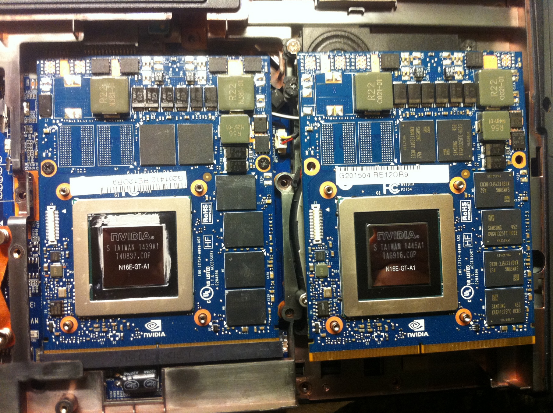

tanzmiester Posted May 15, 2015 Share Posted May 15, 2015 hey guys, can you spot the difference? i ve got 2 different 970m board revisions, which do you think is more advanced? Quote Link to comment Share on other sites More sharing options...
Robbo Posted May 16, 2015 Share Posted May 16, 2015 hey guys, can you spot the difference? i ve got 2 different 970m board revisions, which do you think is more advanced?I've heard conflicting info on this topic - regarding the number or MOSFETS that are along the top of the card. I think there was a user @Khenglish that was saying that the cards with 2 MOSFETS had MOSFETS that were more 'advanced' and efficient somehow, therefore requiring only 2 in contrast to the previous 4 that were common. If you're willing to test them to their limits then you might be able to answer that question for yourself - by flashing one of those modified vBIOS from Prema or svl7, then overclock and see how stable & high they overclock. Sure, there's a silicon lottery between the two cards anyway, but I'd probably just keep the one that overclocks the best. Quote Link to comment Share on other sites More sharing options...
tanzmiester Posted May 16, 2015 Share Posted May 16, 2015 there is another ellement that is missing on the new card, just below the left upper corner. Quote Link to comment Share on other sites More sharing options...
Robbo Posted May 16, 2015 Share Posted May 16, 2015 there is another ellement that is missing on the new card, just below the left upper corner.True, I see that now that you point it out, not sure what that is. Either way, if I had your cards I would take the approach I outlined in my previous post. If you want to have 2 cards for sli maybe you can still do the testing I mentioned & then send back the card that doesn't overclock as well and request a card with the identical design of the card you're keeping. Quote Link to comment Share on other sites More sharing options...
Guest Posted May 16, 2015 Share Posted May 16, 2015 I think it maybe just a different layout for Hynix and Samsung vRAM!? Quote Link to comment Share on other sites More sharing options...
