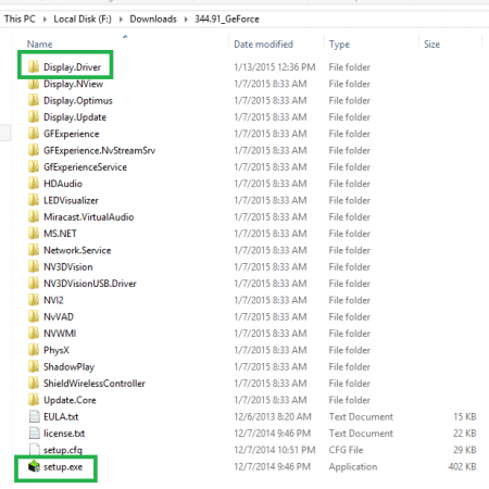

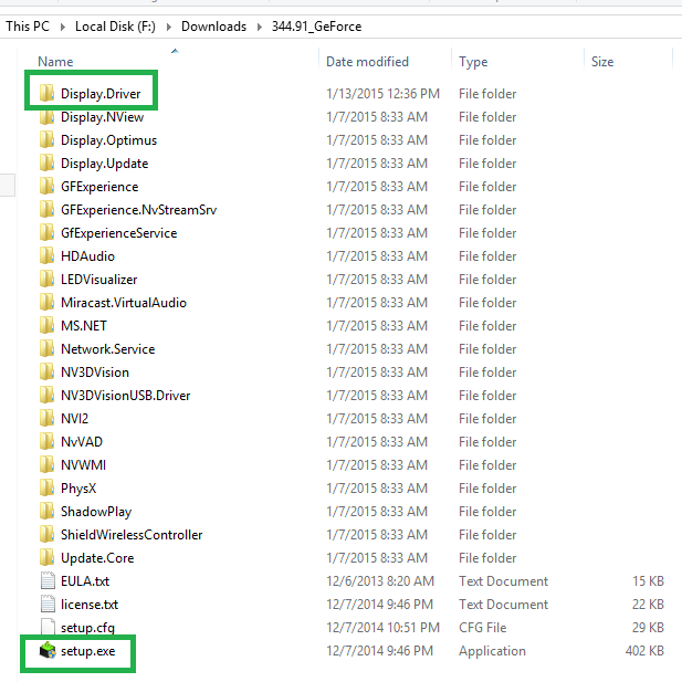

svl7 Posted January 24, 2015 Share Posted January 24, 2015 Any Nvidia driver with 980m support, but you'll need to modify the .inf file.Check this thread from @J95. Quote Link to comment Share on other sites More sharing options...
Player2 Posted January 24, 2015 Share Posted January 24, 2015 Any Nvidia driver with 980m support, but you'll need to modify the .inf file.Check this thread from @J95.Thanks. Could you name the thread for me because there is no link.so I know we're to look thanks Quote Link to comment Share on other sites More sharing options...
thegh0sts Posted January 24, 2015 Share Posted January 24, 2015 Thanks. Could you name the thread for me because there is no link.so I know we're to look thanksThere's a specific post in this thread.http://forum.techinferno.com/alienware/8113-going-test-clevo-980m-alienware-m17x-r4-m18x-r2-aw17-98.html#post118582I bookmarked this cos i know i will need it too! 2 Quote Link to comment Share on other sites More sharing options...

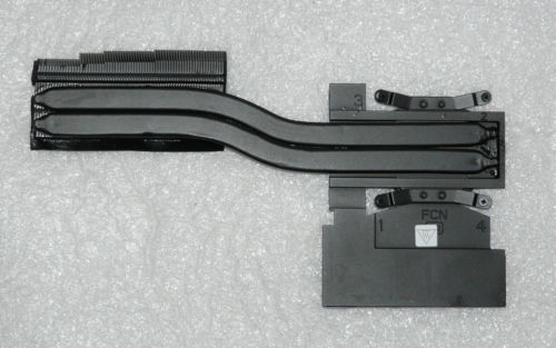

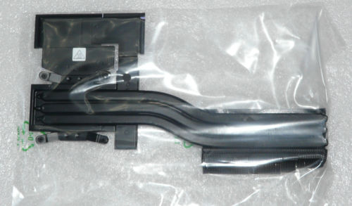

davenam Posted January 24, 2015 Share Posted January 24, 2015 I am planning on buying R5 and installing 980m. Does anyone know which of those two heatsinks is correct for m17x R5 + 980m ? Quote Link to comment Share on other sites More sharing options...
thegh0sts Posted January 24, 2015 Share Posted January 24, 2015 I am planning on buying R5 and installing 980m.Does anyone know which of those two heatsinks is correct for m17x R5 + 980m ?[ATTACH=CONFIG]13773[/ATTACH][ATTACH=CONFIG]13774[/ATTACH]3-pipe heatsink is the standard.Most the threads about InstallingDrivers are way over my head. I'm just going to have to read more and try and figure it out .most are for Windows 8. Unless someone wants to walk me through it it's not going to happen any time soon. I'll just keep reading up on it.I'm so close yet so far away.just do the following from the post i linked earlier:Extract driver w/ 7-Zip/winrarExtracted driver folder "34x.xx-notebook-win8-win7-64bit-international-whql" -> copy NVWMI folder.Display.Driver folder -> copy/overwrite nvcv.inf(NV drivers v344.91) or nvcvi.inf (NV drivers v347.09, v344.80, v344.75) nvcvui.inf/v347.12.Extracted driver folder -> run setup.exe Quote Link to comment Share on other sites More sharing options...
davenam Posted January 24, 2015 Share Posted January 24, 2015 3-pipe heatsink is the standard. in this upgrade movie - he has 2-pipe heatsink ... which confuses me might both be ok ? Quote Link to comment Share on other sites More sharing options...
thegh0sts Posted January 24, 2015 Share Posted January 24, 2015 in this upgrade movie - he has 2-pipe heatsink ... which confuses me might both be ok ? Player2 has a 2-pipe heatsink though a 3-pipe is preferable. Quote Link to comment Share on other sites More sharing options...
Player2 Posted January 24, 2015 Share Posted January 24, 2015 in this upgrade movie - he has 2-pipe heatsink ... which confuses me might both be ok ? I used 2pipe on my 17 with 780M with overclock without issue and I currently have the my 2 pipe on my 980m and it fits fine. 980m should run cooler than 780m so you should be fine with either one Quote Link to comment Share on other sites More sharing options...
