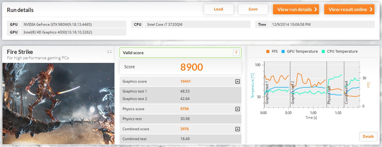

My 3Dmark results yesterday. <---
Haven't OC my CPU or anything yet, though I may end up doing so sometime soon, we'll see.
