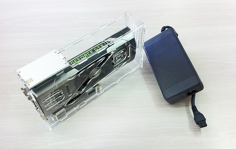

Bizon is trying to get over US$336 profit for his US$610 kit (EXP GDC V6). With each sale he makes he can buy a USD$200-$270 AKiTiO Thunder2 PCIe Box in profit along + quite a few McHappy meals for his mates.
Pls dislike (thumbs down) the above youtube Bizon (RU) video to warn customers of being ripped off
If you feel that charging US$610 (21,990 RUB) for his BizonBox, comprising of US$274 worth of parts listed below is an insult to Russian eGPU fans then pls dislike his video linked
or clickable above to warn potential customers.
USD$99 EXP GDC V6 + 220W Dell DA-2 AC adapter
USD$130 Sonnet Echo Expresscard Pro
USD$20 Acrylic cover
with customized Bizon labelling
* US$25 Thunderbolt cable

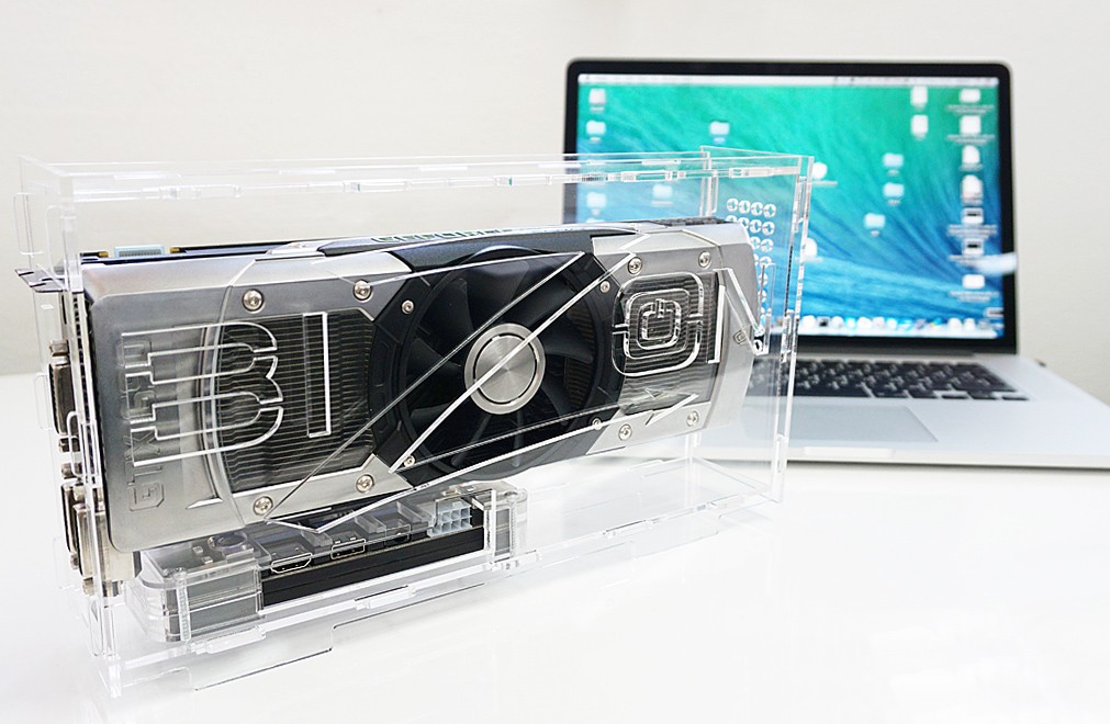

It looks like they have produced a ready to use box including the GPU. I know its hard to read but just use google chrome and auto translate, I speak Russian and the translation is pretty legit.
Хотите купить Mac Pro или Mac, но дорого? | Внешние видеокарты Ð´Ð»Ñ Ð½Ð¾ÑƒÑ‚Ð±ÑƒÐºÐ¾Ð² MacBook (Thunderbolt, Expresscard, eGPU)
Bizon Kits come in different variants.
1. Only Box
2. Nvidia GTX 750,760,770 or 970
There is also a video preview, which pretty much speaks for itself.
The price is the downturn, around 900 USD coming with the nVIDIA GTX 760.
