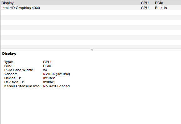

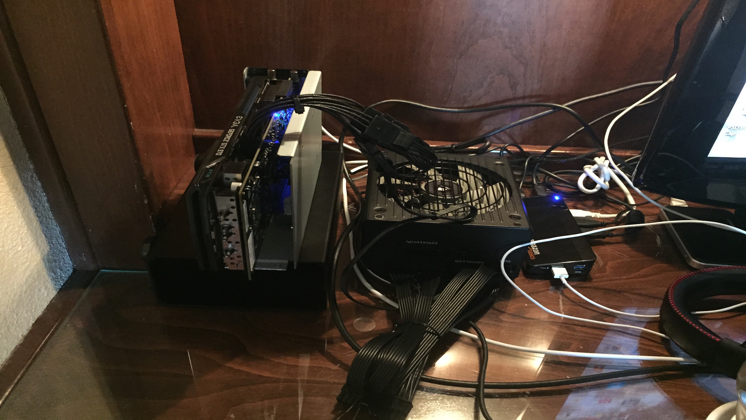

kmitza Posted December 1, 2014 Share Posted December 1, 2014 hy guys,my eGPU is the akitio thunder 2 with a pci raiser and the gtx 970. my power supply is the FSP raider 550W which is connected to the GPU and to the PCI raiser. the akitio is powered by ist own power supply. my computer is a mac mini mid 2011, i5, 16GB ram running os x 10.10.1the eGPU works, but it crashes when i start rendering in premiere pro cs6 and restarts the computer. i have the latest web driver and cuda driver installed.please help! Quote Link to comment Share on other sites More sharing options...
Dschijn Posted December 1, 2014 Share Posted December 1, 2014 Can you please try without the AKiTiO power supply, if you are using the powered riser! Do not use powered riser + AKiTiO PSU at the same time. Quote Link to comment Share on other sites More sharing options...

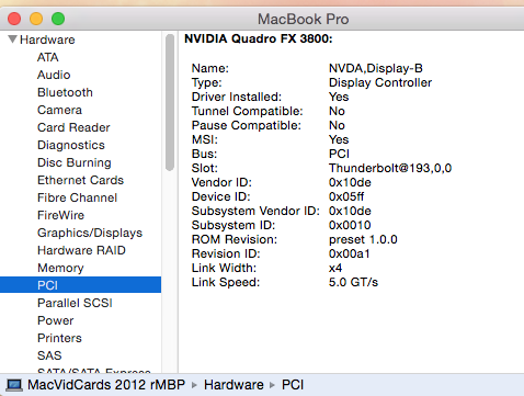

Tech Inferno Fan Posted December 5, 2014 Share Posted December 5, 2014 The Smoking Gun, Apple working on eGPU on Thunderbolt for nMP and others (macrumors) as posted by MacVidCards ( @MVC ) : The Smoking Gun, Apple working on eGPU on Thunderbolt for nMP and othersBeen debating where and when to post this. Juicy. Shows that Apple has a lab somewhere that is working on eGPUs. The very thing I posted about a few weeks ago. (CUDA coming to nMP near you) I decided to try out a variety of cards as they are lying around here. I can write an EFI that gives boot screen, etc but unlike cMP these cards still have no info in the "PCI" section of Profiler. Instead, the usual "There was an error...blah, blah,blah" of unflashed cards. Imagine my surprise when I tossed in an old Quadro 3800 and saw the attached screen. Why oh why would the "Graphics and Displays" section have those TB specific fields? Somebody put them there and it wasn't me. I would guess that Apple has been quietly working on this for some time but has held off introducing either as a favor to Intel, to sell more computers, or just because they are mean. In any case, the system profiler knows what an eGPU is. I would guess that they have a routine in that blocks this info on more common and recent cards, but somehow older obscure cards still show up like this. We will be offering a limited number of eGPU options, but my guess is that eventually Apple themselves will. Or maybe not, I have found that my rMBP becomes an awesome gaming machine when I dock it with TB GTX980. Then I undock and take with me. At which point my 2014 dog-slow Mini becomes a gaming machine, via the same GTX980. So, you could buy 1 pricey GPU and use it with all of your TB equipped Macs. When you wanted to run CUDA on your nMP, BANG ! Crisis 4 on your MBA? BANG ! Sounds far too useful and sensible for Apple to market it. In any case, there it is, proof it is either coming or was tested and set aside. We'll see which. Quote Link to comment Share on other sites More sharing options...

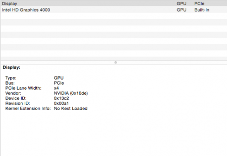

abhisheknath Posted December 11, 2014 Share Posted December 11, 2014 Hey guys,Firstly I would like to thank this forum for being a fantastic resource in realizing my goal of setting up an e-gpu. My setup consists of the following components:- Zotac GTX 970- Akitio TB2 enclosure without riser- Antec earthwatts 650 PSU + paperclip- Macbook pro 13" Iris- OSX Yosemtie 10.10.1 + web driver 343.01.02f01With the Zotac's fan shroud off, it fits handily into the akitio enclosure and I have a pretty clean setup. I am however worried that I without a riser I am putting too much strain on the Akitio's external PSU. That having been said I was able to play civilization 5 on high detail + 2560x1440 for a couple of hours without issues. I have some random questions:- Is there a way to monitor the temperature of the zotac gtx 970 on OSX? - Is there a way to provide power to the Akitio board from an external PSU while still having my Zotac gtx 970 fit inside it.Much appreciated! When I have this running stably I'll put up an implementation guide.Thanks,Abhi Quote Link to comment Share on other sites More sharing options...

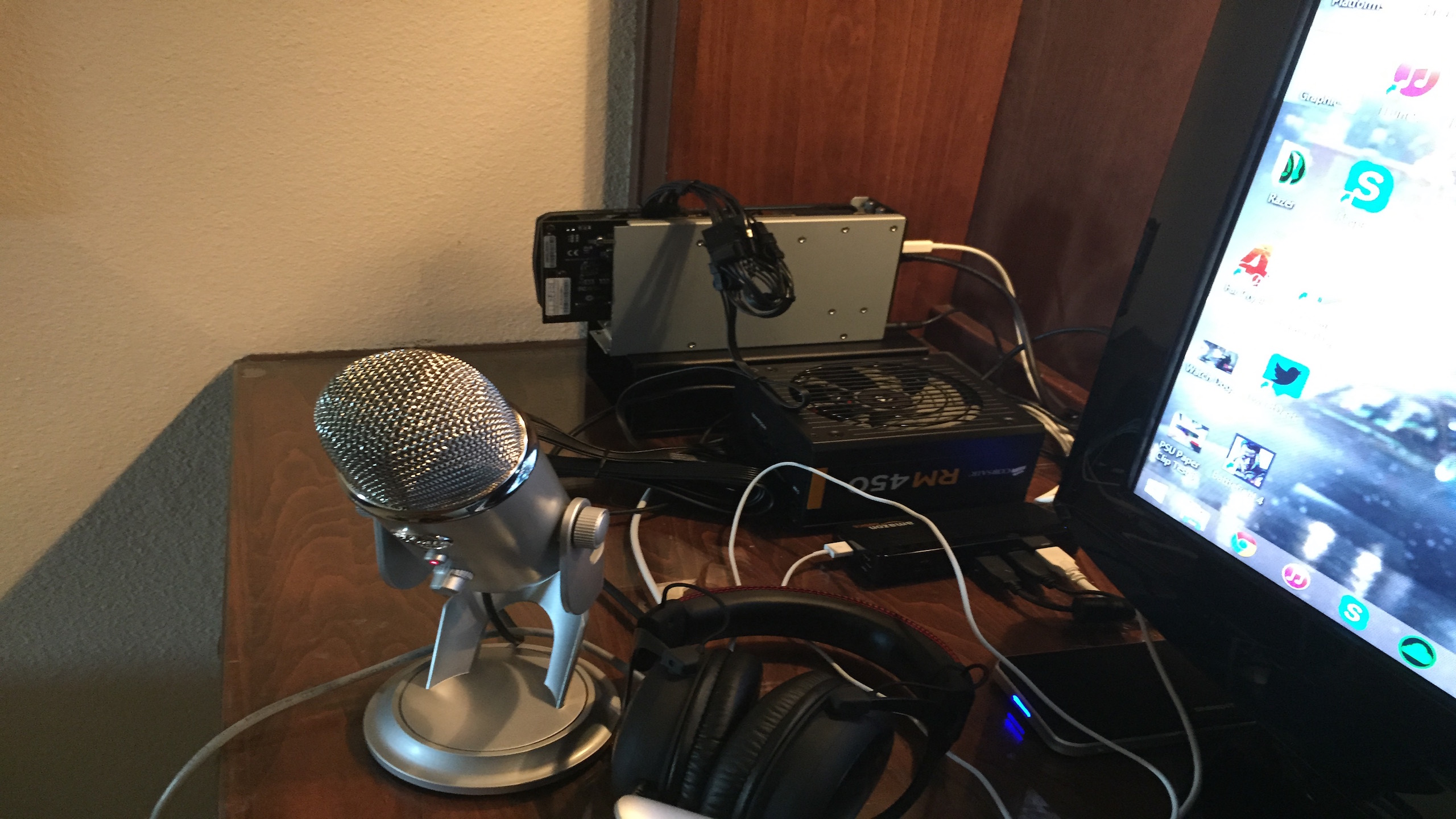

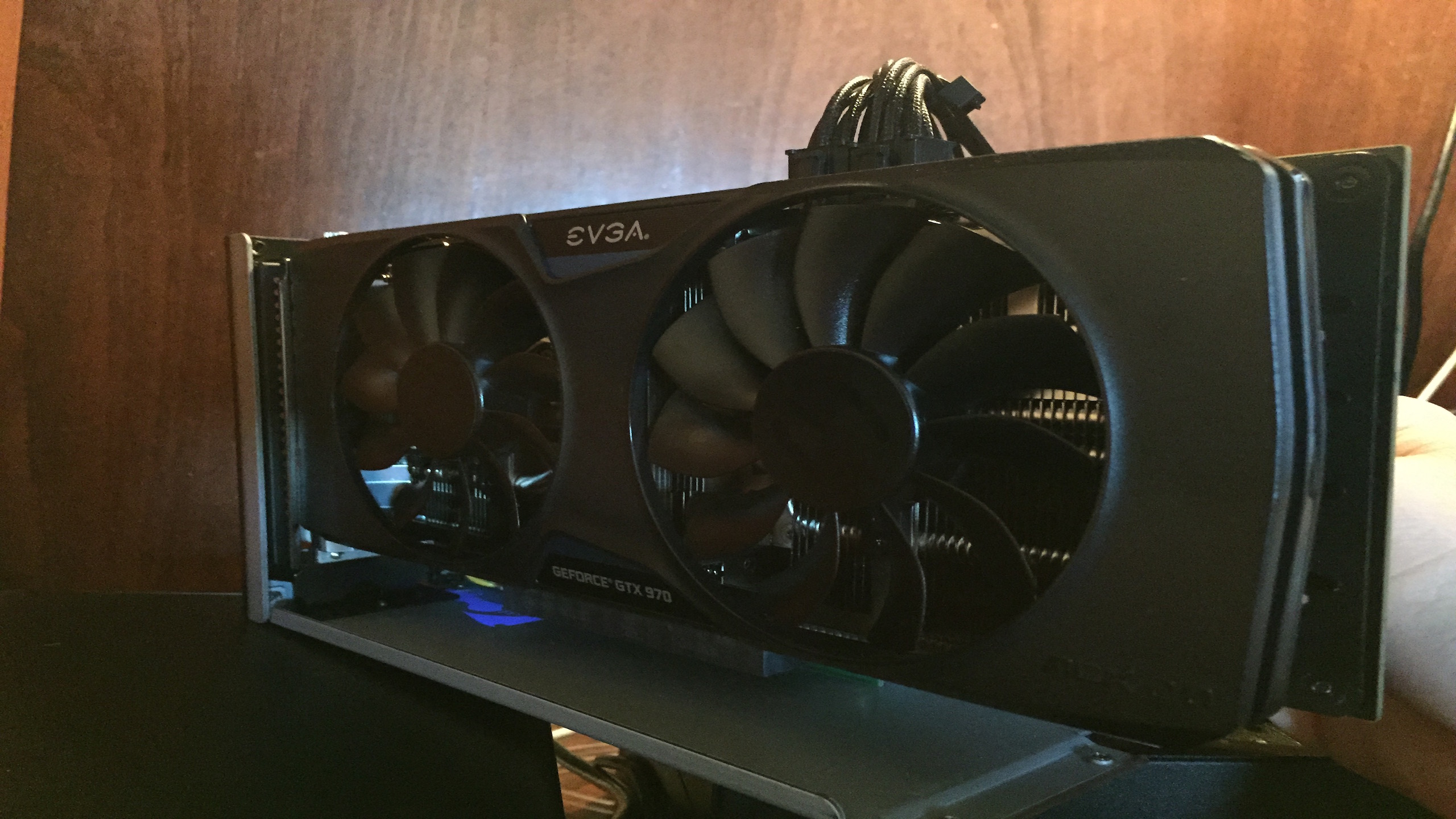

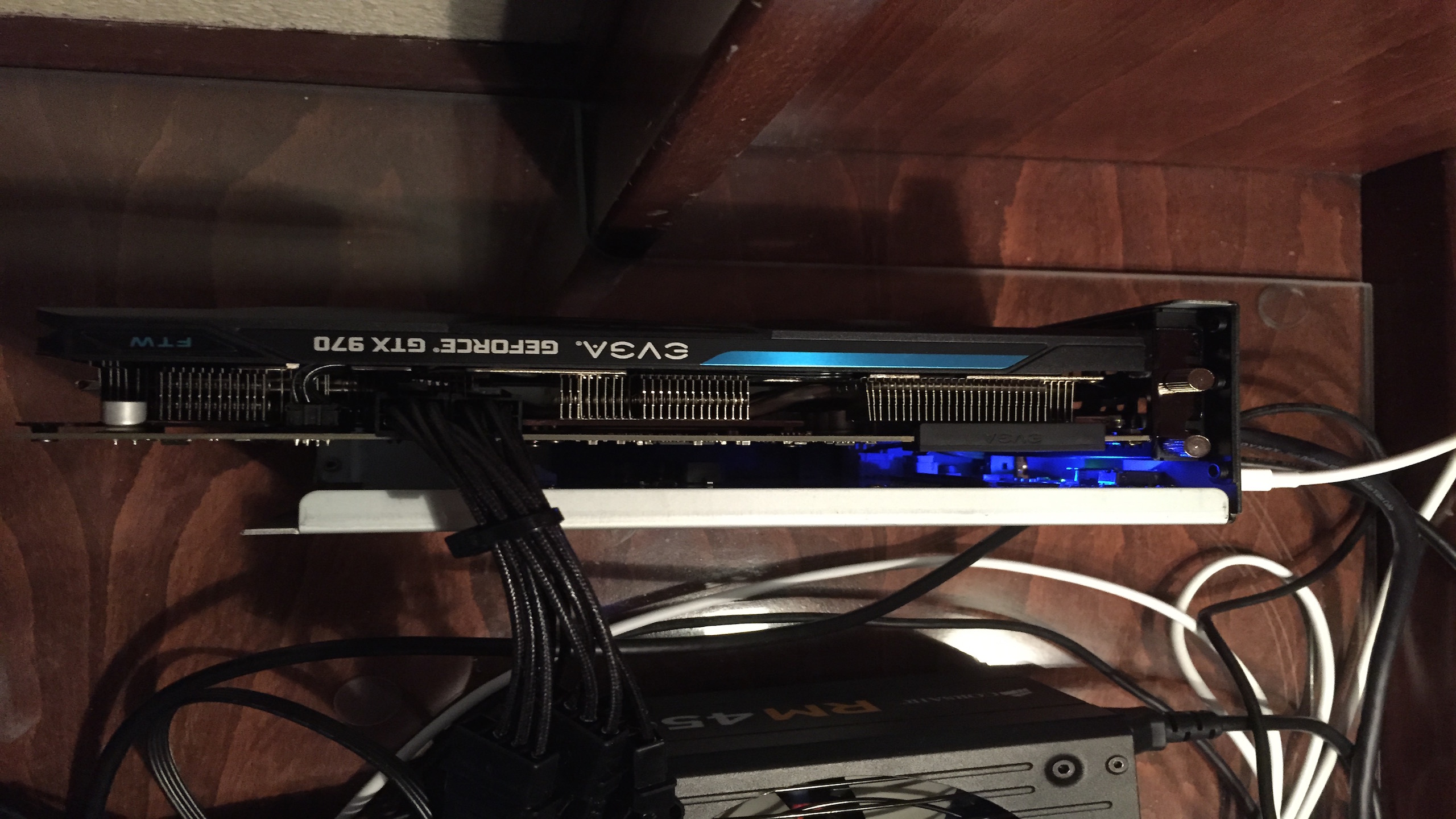

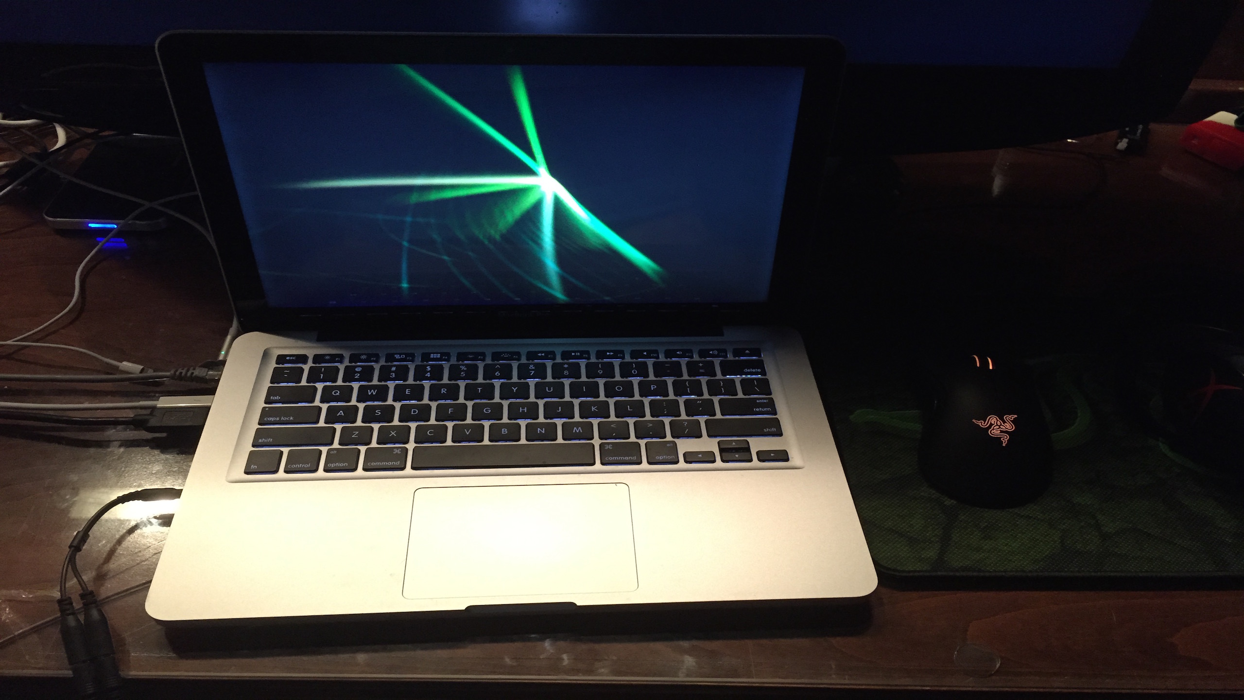

Shadow_Bullet Posted January 6, 2015 Share Posted January 6, 2015 Okay so I have been using my EGPU in Windows for about a week now and everything has been great other than a few crashes here and there but I expected that. Today I decided I would get it to work in OS X. I did not have the "joy" that I did have in Windows. I have modified all KEXT files, installed the CUDA driver and NVIDIA Web Driver. Allowed signing of driver certificates in terminal, I cleared my KEXT cache. However when I boot into OS X after following the startup procedures all it shows up as is "Display" as you can see below, If anyone could help me figure out why this is happening it would be greatly appreciated @Tech Inferno Fan @Dschijn @Sachin10 @entzoe . Also just some pictures of my setup in case you guys are interested If these images seem disproportionate it's because I scaled them to 2560x1440 to upload them here. 1 Quote Link to comment Share on other sites More sharing options...
Dschijn Posted January 6, 2015 Share Posted January 6, 2015 GTX 970 and OSX isn't the best combination right now. Quote Link to comment Share on other sites More sharing options...
Dschijn Posted January 6, 2015 Share Posted January 6, 2015 You shouldn't bother of trying to make it work in OSX. I stoped trying after many failed attempts. GTX 970 and OSX isn't the best combination right now.In the end I'm pleased it didn't work for me. In OSX I connected the external display directly to the MBP and have a much quieter system. For Windows I disabled the direct connection (TB -> DisplayPort) and am only using the MB screen with the external display connected via DVI to the eGPU.If you really need OSX eGPU, you should consider making a step back to a GTX 780 (Ti). Quote Link to comment Share on other sites More sharing options...
