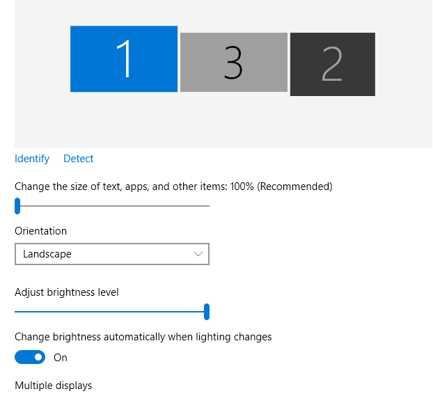

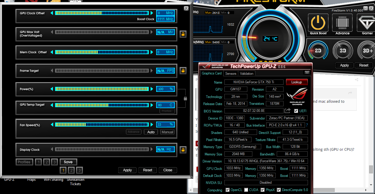

iddinmx Posted February 17, 2016 Share Posted February 17, 2016 (edited) Hello, Currently I am using Windows 10 with Akitio + GTX 750 Ti on my MBP Late 2011. Sometimes when I play games on windows for around 1 hour+, the fps suddenly dropped down till 10-20fps. And then after a few minutes my windows hang and I have to force shut down. May I know what's the problem? Am I pushing my GPU too long or something? Thanks in advance! Edit: is it normal to have 3 screens shown on my display properties? 1 : my internal screen 2 : ext monitor connected to eGPU 3 : I think my internal with eGPU, not so sure? Should I disconnect the internals 1st and 3rd and just left only my external monitor open? Thanks in again! Edited February 17, 2016 by iddinmx Quote Link to comment Share on other sites More sharing options...
Dschijn Posted February 17, 2016 Share Posted February 17, 2016 (edited) On 16.2.2016 at 2:22 PM, Kr4nG said: Sweet thanks ill give it a shot. What about the sleep? Is my egpu and mac allowed to sleep? You can try I never tried… In Windows you can Hibernate with the eGPU, though… @iddinmx You are not sure what No3 is? Than disable it What was your PSU again? Are you overlocking the GPU oder undervolting sth (GPU or CPU)? Edited February 17, 2016 by Dschijn Quote Link to comment Share on other sites More sharing options...
iddinmx Posted February 17, 2016 Share Posted February 17, 2016 I'm using the Dell DA-2 220W. It works perfectly. Only powered through the barrel plug since my GPU doesn't have any power input needed. I think I OC-ed my GPU before but only using the official software from ZOTAC website. I used the firestorm software and quick boost until 3D+, that's all. But recently I just reset to default setting so I am not so sure whether my current settings is the normal stable one. Can you check for me? Kinda new in GPU OC, but not going to need it later. Thanks! Quote You can try I never tried… In Windows you can Hibernate with the eGPU, though… @iddinmx You are not sure what No3 is? Than disable it What was your PSU again? Are you overlocking the GPU oder undervolting sth (GPU or CPU)? Quote Link to comment Share on other sites More sharing options...
