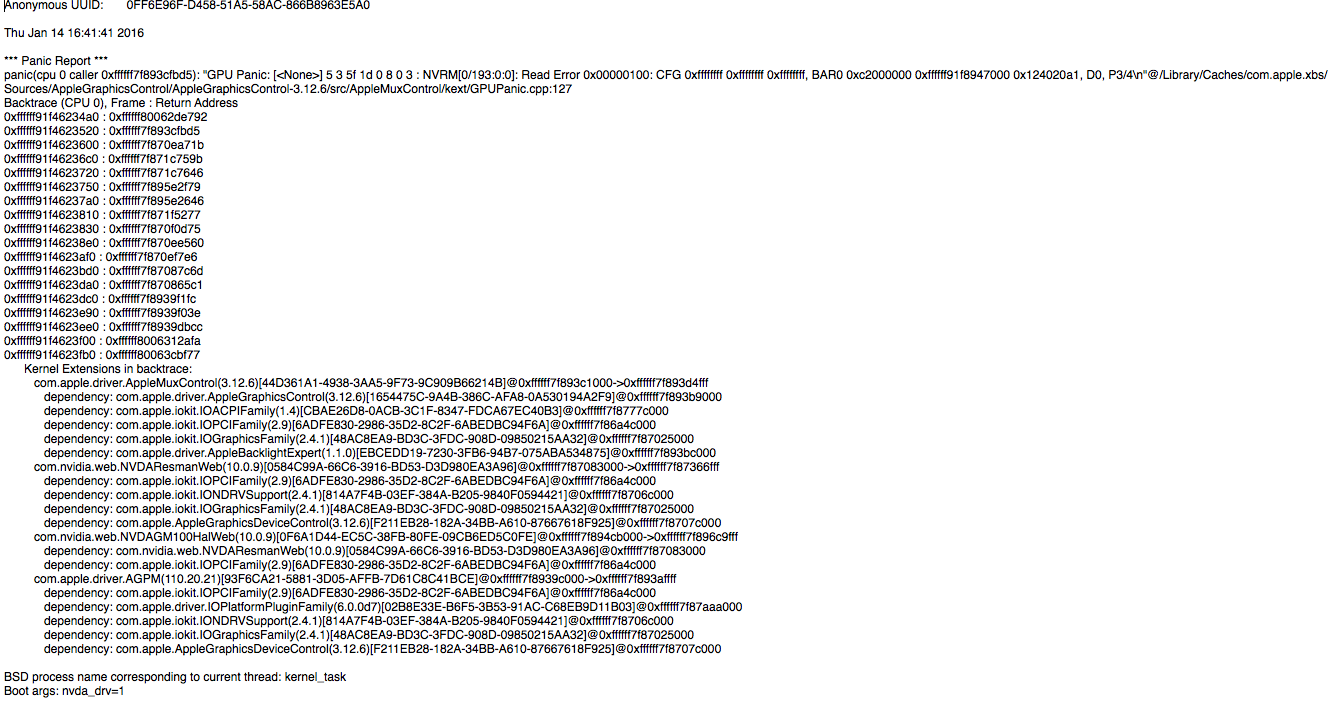

@Dschijn first I tried with Dell DA2 and then with an external PSU ATX 450W. It powered fine with the PSU and the system recognized de eGPU, but after some time, my Mac restart indicating kernel panic. I think it could be a problem of having one integrated GPU, one discrete and the eGPU.

@Dschijn Yes. From the PSU ATX 450W a barrel plug to power the Akitio and with the molex plug to power the Zotac GTX 970. That's the method I'm using now because with the DellDA-2 I didn't got to power it. Furthermore, the system was under a little load (all the metal parts were under load if you touched it). Next week I will try again with the Dell DA-2.
Anyway, now I'm using the PSU ATX 450W and the system recognize the eGPU. After a little time, it restart indicating kernel panic. I attach the error report. It could be the drivers? My Mac have one integrated (Intel 4000)  and one discrete (G650M) and now the eGPU and I'm using both CUDA drivers and WEB drivers from NVIDIA on OS X.

@DannyFK What kind of 450W PSU is it? Most people think that any PSU with more than 300W should work, but especially old PSUs can't handle high loads on the 12V rail and make the GPU crash.

It's an Agiler PSU ATX 450W from an old Pentium IV PC. I'will change by other of the same type this afternoon.
On the other hand, my mac have an integrate card and a discrete and I think that the problem is due to the switching mode between the three cards.

I bet that the PSU is way too weak to power the GPU! With not enough power the GPU is crashing and taking the whole MacBook with it (because the system is suddenly without an GPU).
@Dschijn You were right. With another PSU the system running so nice. I used Disable Monitor to disable the internal LCD of the Mac and disable "automatic change graphic mode" in System Preferences like @goalque said.

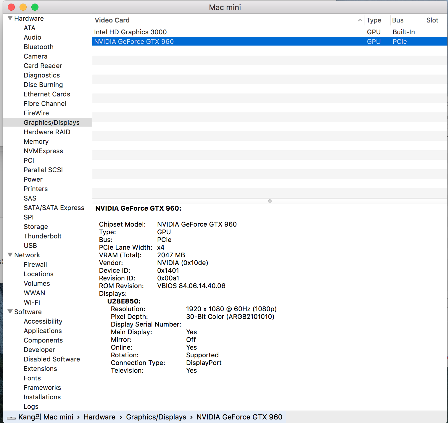

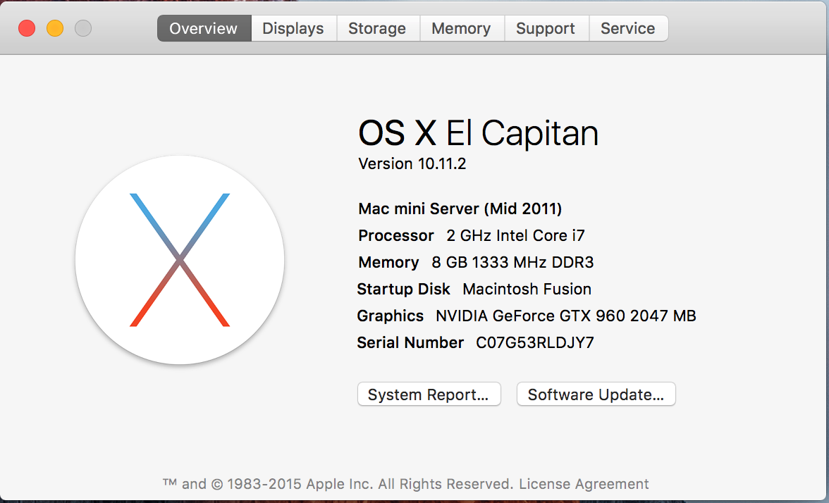

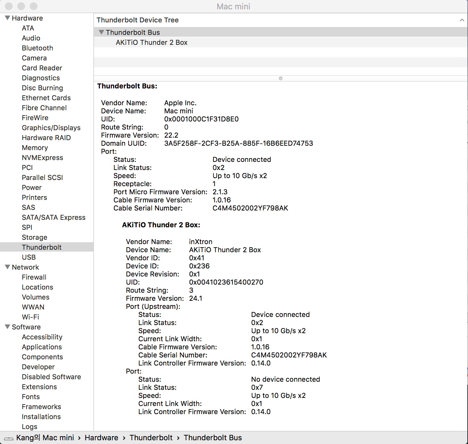

Hi there.
I have some trouble in my mac mini and i need your help for solving trouble.
My setup is below.
Mac mini Server (Mid 2011)
AKiTiO Thunder2 PCIe Box
NVIDIA GeForce GTX 960 2047 MB (gigabyte gtx 960 windforce 2gb)
Corsair RM650 with paperclip trick
Samsung UHD Monitor (U28E850)
569d06c18ebad_ScreenShot2016-01-18at11.3
569d0728c8ce0_ScreenShot2016-01-18at11.3
569d073d0955c_ScreenShot2016-01-18at11.4
569d081cdf8c6_ScreenShot2016-01-18at11.4

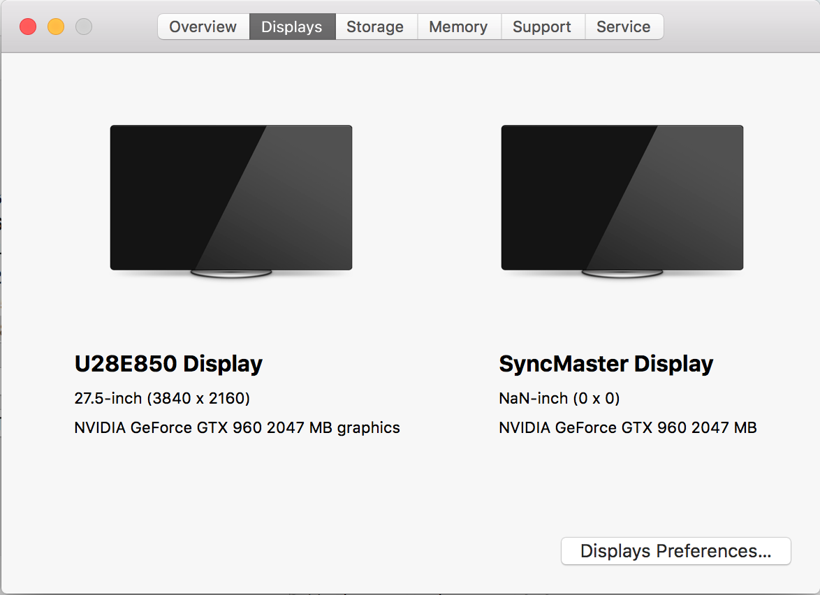

problem 1 :
When the monitor connected egpu via hdmi v2.0 cable then i couldn't use 3840x2160 60Hz mode.
So i use 3840x2160 30Hz mode.
Can i use 3840x2160 60Hz mode via hdmi 2.0 cable? (On the specification of monitor and gpu is explained 4k 60Hz available.)
problem 2 :
In the hdmi connection, I can use mac.
And also be able to boot and reboot.
But when the monitor connected egpu via display port, mac couldn't boot. which is stopped on 40% booting progress bar.
How can i fix these problems?
