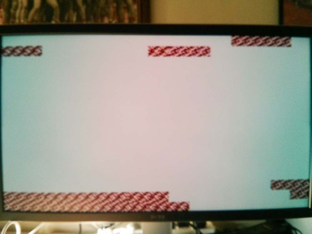

Hi,
I was one of the early adopters of the MacBook Pro 15 Thunderbolt eGPU using a Sonnet Echo Express SE II (Thunderbolt 2.0). I have an MSI GTX760 with a Corsair RM650 power supply.
I recently moved house and was able to use my eGPU again (it has been a few months) and in that time I had upgraded to Windows 10. After upgrading I discovered that Optimus mode does not work in Windows 10 (annoying) but I have just got a new 4K screen so I didn't care too much. After receiving the screen and hooking up the eGPU via Thunderbolt 2.0 and installing the drivers I was able to play Fallout 4 for a few minutes before my PC froze, black screen, unresponsive. Ever since I have not been able to get the card to work.
I have tried:
- removing nVidia drivers using DDU and I am able to see the graphics card in device manager as an unknown display device until I install new nvidia drivers where it correctly detects GTX760. If I then try restarting the PC with the eGPU plugged in then windows will not boot (or maybe the graphics card is not showing any output).
- setting up OSX egpu (unfortunately I had never done it before). Using the installer script I was able to detect and install the GTX760 drivers but when I booted this time I got a very strange screen (as shown in attached image). this image is the same from both mini displayport and dvi ports.
It looks to me like a GPU failure. Any thoughts?
@Relentless: As hard as it sounds, but to me it looks like the GPU or VRAM are damaged. The power connection ist 100% correct? The GPU couldn't get too hot?
