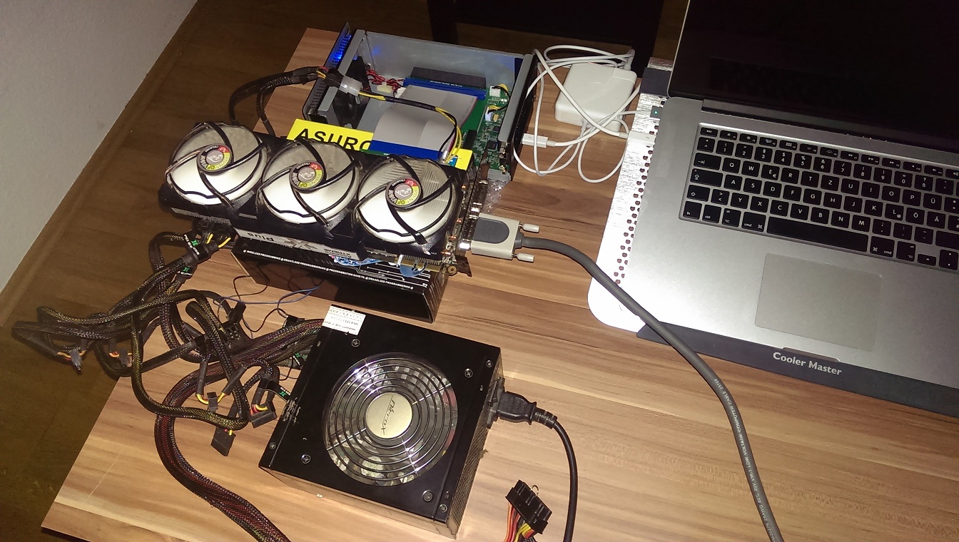

So I got my Akitio Thunder2 PCIe Box yesterday and disassembled my desktop computer this evening.
At first Windows wasn't working in terms that the external display stayed black. I couldn't see a reason as everything was working as described by others here(Akitio LED green at first, then blue after start of Macbook).
Then I removed the newer version of the Intel graphics driver I remembered having installed after I installed Windows and magically I got a picture on the external display at next reboot.
Now everything is working fine. Played DayZ for around an hour without problems.
Setup:
Macbook Pro 15 Retina 2014 with Iris Pro only
Akitio Thunder2 PCIe Box with 16x powered pcie riser
Nvidia GTX 480
750W PSU
GPU and PSU are taken from my desktop, I will most probably replace them with a newer GPU and a PSU with lower W(guess 400W will be enough, quality PSU for sure).
Steps were simply those that have been described:
- Assemble everything before booting(riser into thunder2 pcie box, graphics card into riser, connect PSU with graphics card and thunder2 pcie box(1x 4-pin molex), leave thunder2 pcie box psu away as it is not needed)
- Turn the PSU on first which turns on your thunder2 pcie box and the graphics card, the green light of the pcie box should glow now
- Turn your Macbook on
- Boot Windows
- Install current Nvidia drivers
- Have fun!

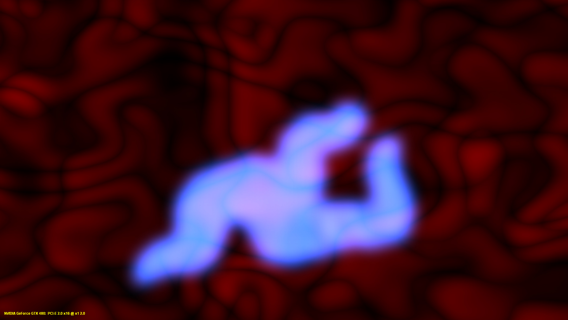

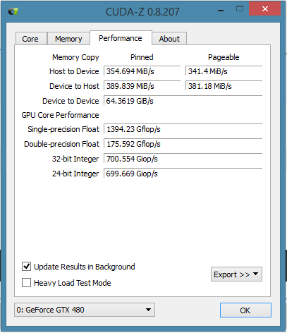

Ehm guys, I need some help.
I was justing testing the game "Next Car Game: Wreckfest" with 23 cars on track and at start I only got around 6 FPS. Quality settings and resolution didn't really affect the outcome.
After this I tested the game "Insurgency" which ran fine on high settings and FullHD resolution but had noticable FPS drops when there was much smoke.
I remembered having read something about this being bandwidth dependent.
So, what I forgot to do yesterday, I checked GPU-Z and I only have a 1x2.0 connection when I should have a 4x2.0 :concern:
CUDA-Z confirms the problems by only giving about a quarter of the memory copy bandwidth I've seen here.
Pictures for proof:
This ain't cool but I have no idea where the problem is. I'd suspect the pcie riser but it's 16x to 16x. Any help appreciated.
Hm, well, I'll try the riser in my desktop computer. If I get 1x2.0 there as well I know what the problem is.
Edit: Ok, it's not the riser. I get a plain 16x2.0 connection on my desktop with the riser applied.
Edit2: Okaaaay. Either I'm just stupid and didn't plug the riser into the pcie box 100% or the riser has some loose contacts whose effects only appear sometimes as the riser connector is slightly bent which you can see on my previous post. After reassembling the eGPU I had a 4x2.0 connection but horrible FPS drops for about 20 FPS or more. I had shutdown and bend the riser a bit here and there and tried again. Now I've got 4x2.0 with stable FPS. Both games mentioned are now playable like on my desktop computer.
My 3DMark11 result is now also about 1000 points higher at 5478(which is even higher as my desktop result, most probably due to the nearly 2x faster Intel CPU, regarding single thread performance).
I'll get a new riser then but now I know everything is working.
